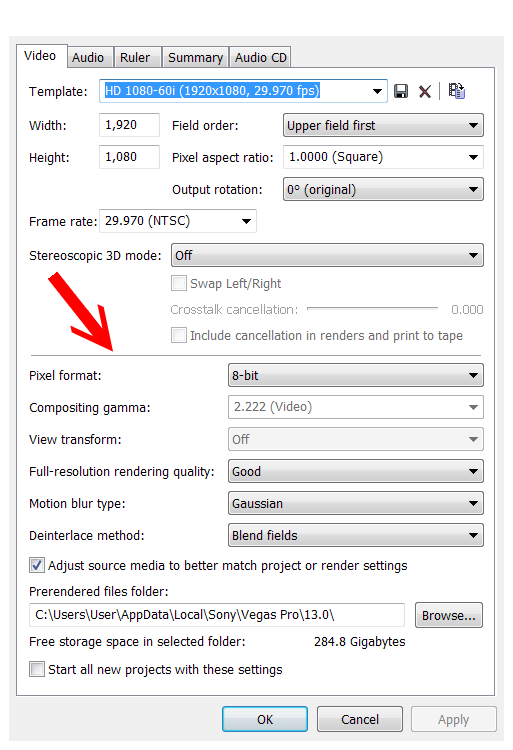

  3. The Vegas Project Properties template is a strange one because it should only affect playback, but a few of the options also affect how the video gets rendered. I stopped upgrading Vegas at version 13, but I expect it still works the same. The options above the line in the attached photo control how the video gets displayed on the timeline, and the ones below affect how the video gets rendered. For most projects, you want the settings above the line to exactly match the footage you are importing. Vegas now does this for you automatically when you import the first clip into a new project.
    However, if you are mixing clips that have different formats (i.e., 1280x720 with 1920x1080, or 24 fps with 29.97 fps), then you will have to choose which format you want to display on the timeline. In this case, you should choose the settings which matches the format to which you will render the finished project.
    The key thing to understand is that if Vegas has to change the video from the native format of the clip to the format you specify for timeline playback, it will significantly slow down the playback speed. This happens because Vegas has to make so many calculations that it cannot output 24, 25, 30, or 60 frames per second to the timeline and therefore has to drop frames.
    When you match the formats, Vegas can usually playback the native clip (i.e., no fX) at full speed and resolution, using a modern computer, even with 4K footage. However, if you don't match the project properties above the line to the footage, you will not only end up with slower playback, but also a picture that is degraded, especially if the fps doesn't match because Vegas blends frames in order to achieve the new framerate.
    The settings below the line affect how the project is rendered. My strong recommendation is to not touch them unless you already know what they do. Back when I used to post on the Sonic Foundry (and then Sony) Vegas forum (over 6,000 posts), I can't tell you how many times all of us had to help someone fix problems caused by them deciding to change these settings below the line, without really understanding what they were doing. By contrast, if you screw up the settings above the line, all it will do is make the timeline performance sluggish.

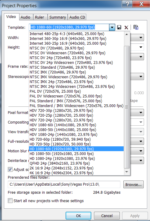

    You've posted essentially this same thing twice, but I can't understand what you are trying to say. You need to provide the exact specifications of the video you are trying to edit. You can download Mediainfo and it will give that to you. What we need is something like this:
    720x480
    29.97 fps (frames per second)
    Field order: Lower field first
    or
    1920x1080
    59.94 fps
    Field order: Progressive
    The first is a common North American type for older analog video that has been digitized (as already noted, once on your computer, all video is digital), and the second example is fairly typical for modern HD video.
    If you are editing 4K video, you will have yet another set of numbers.
    Finally, even though I have the pro version of Vegas, I am quite certain that the Studio version has at least a dozen presets other than the one single one you quote. Look again at that drop down at the top of the dialog. I have attached a snapshot of the Vegas Pro Project Properties preset drop down to show you the choices. I am 100% certain that you have a large number of these available in Studio.
