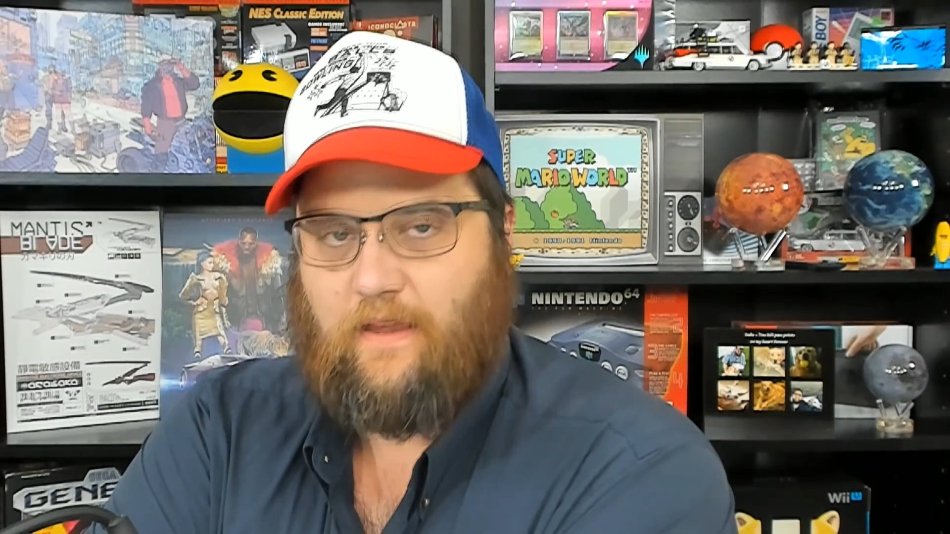

  4. With the AVC 60fps video which has duplicate frames for frame 0 and 1 I can only get QTGMC to work if I do this however it still has ghosting artifacts such as on frame 64:
    QTGMC(preset="Slow") SelectEven()
    I also tried downloading the 30fps AVC version. That does NOT have duplicate frames however I can't get QTGMC to work with it at all. Here's a screenshot of frame 67 after using this script:
    QTGMC(preset="Slow") # This doubles FPS to 60.
    [Attachment 54210 - Click to enlarge]

    On the AVC 30fps video I downloaded with YouTube-DL which doesn't have duplicate frames for frame 0 and 1, I used this script to keep just the first 18 seconds of the video:
    Trim(0, 548) Trim(0, -0)
    QTGMC(inputtype=2, sharpness=0.5)
    QTGMC had no effect on fixing the jaggies and in fact the video looks worse than before as it now has ghosting as shown in the previous picture I uploaded. Video attached.
    I don't understand why QTGMC isn't working for me? I watched your video and clearly QTGMC was working for you as the jaggies were removed.
    Does anybody have a standard definition interlaced clip I can test as QTGMC worked fine on such videos for me in the past. I'll test it again.
  8. Yes, you got some ghosting issues too
    I see 2 problems.
    1) something wrong with your downloading process , despite the same batch script, same youtube-dl version . I have no idea why.
    2) QTGMC isn't working properly for you
    If you want to deal with problem #2, answer the earlier questions about avs version number, x86 vs. x64 . Personally I would (and do) use newest version of avs+ x64, with newest QTGMC and plugin and script dependencies
    http://avisynth.nl/index.php/QTGMC
    http://avisynth.nl/index.php/QTGMC#Core_Plugins_and_Scripts
    You don't really need a sd video to check. Just use that cut.webm video in the earlier post #23. Use the same script. If you get the jaggies and ghosting, you know QTGMC isn't working . You should get the same (or very similar) results for the output file
