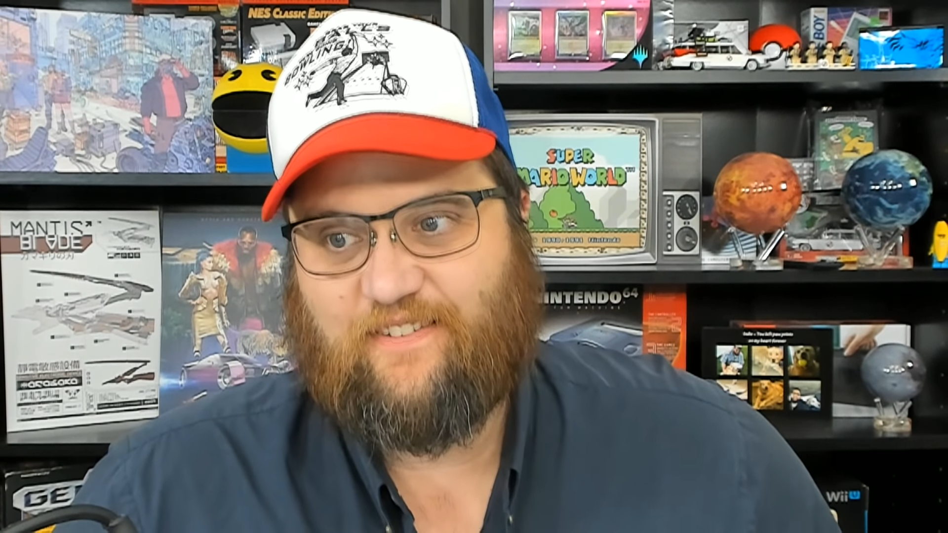

  15. Thanks. Got it working. But when previewing the video in AvsPmod before encoding the video I can still see the ghosting. It's 30fps but there's still ghosting.
  16. Originally Posted by AndersonJames View Post
    What are you describing as "ghosting" ? Can you post a screenshot or describe it better?
    I see motion blur, from the camera. It's soft , low quality upscale, blurry - but none of those are what would be described as "ghosting"
    "ghosting" typically implies double images or after images. A blend of more than 1 time

    I encoded the video but it came out looking much worse than the source. Frame 146 and 147 have an example of the ghosting I'm referring to. It looks like a previous image has had parts of it left behind in the current frame.
    [Attachment 54200 - Click to enlarge]
    QTGMC is actually make those artefacts, it's making the picture look worse rather than better! Any suggestions on how to fix the jaggies in the source?

  18. Something wrong with your version, maybe your dependency plugins are old ? If you comment out the QTGMC line, do you still get "ghosting"? (is it a lsmash issue or QTGMC issue on your end) ?
    Are you using the original video? That frame 146,147 is nowhere near 146,147 in my version in 30fps
    I don't see duplicates there on my version with that script in that range (did you mean 14,15, or 15,16) ? etc... either way in that range to frame 40 and beyond, each frame is unique for me .
    I don't see any ghosting like that in mine either (QTGMC in progressive mode is helping the jaggies; or it does when you get it working properly)
  19. The corresponding screenshot for your screenshot should be frame 136
    selecteven()
    [Attachment 54201 - Click to enlarge]
    selecteven().QTGMC(inputtype=2, sharpness=0.5)
    [Attachment 54202 - Click to enlarge]
    No ghosting for either ; the main difference is less aliasing with QTGMC processing (you can compare the hat, glass rims, super mario etc...)
