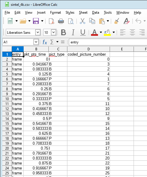

  13. Originally Posted by butterw View Post
    How to detect if a video is closed gop ?
    I believe you can use ffprobe. Put this in a batch file and you can drag/drop an A/V file onto it.
    echo entry,pkt_pts_time,pict_type,coded_picture_number > "%~n1.csv"
    ffprobe.exe -v 32 -stats -y -hide_banner -i %1 -select_streams v -print_format csv -of csv  -show_entries "frame=pkt_pts_time,pict_type,coded_picture_number" >> "%~n1.csv"
    It will produce a csv file you can import as spreadsheet or view as plain text. It will show the frames in presentation order with the display time, picture type, and the coded picture number.
    [Attachment 54704 - Click to enlarge]

    You can see that the last frame of the first GOP is a B frame -- so that's an open GOP. Also, the coded picture number is higher than that of the I frame after it -- indicating that the I frame had to be decoded before the B frame, another indication of an open GOP.
    ffprobe is pretty slow so it will take a while. But you can always abort it part way through (Ctrl+C or Ctrl+Break) and just use the partial result.

    Thanks for that.
    I used your command line, and edited it to change the output to txt instead of csv. Then, I created a regex line (That I use in notepad++) to search for bframes which are located just before i-frames to determine if it's Open-GOP (and I make sure that coded picture number of the bframe is just after that of the i-frame).
    Here is the regex line :
    B,[0-9]+\r\nframe,[0-9]+.[0-9]+,I
    If that method is flawless, then the only remaining thing are videos without bframes (if there's any way to know if they are actually Open-GOP).
