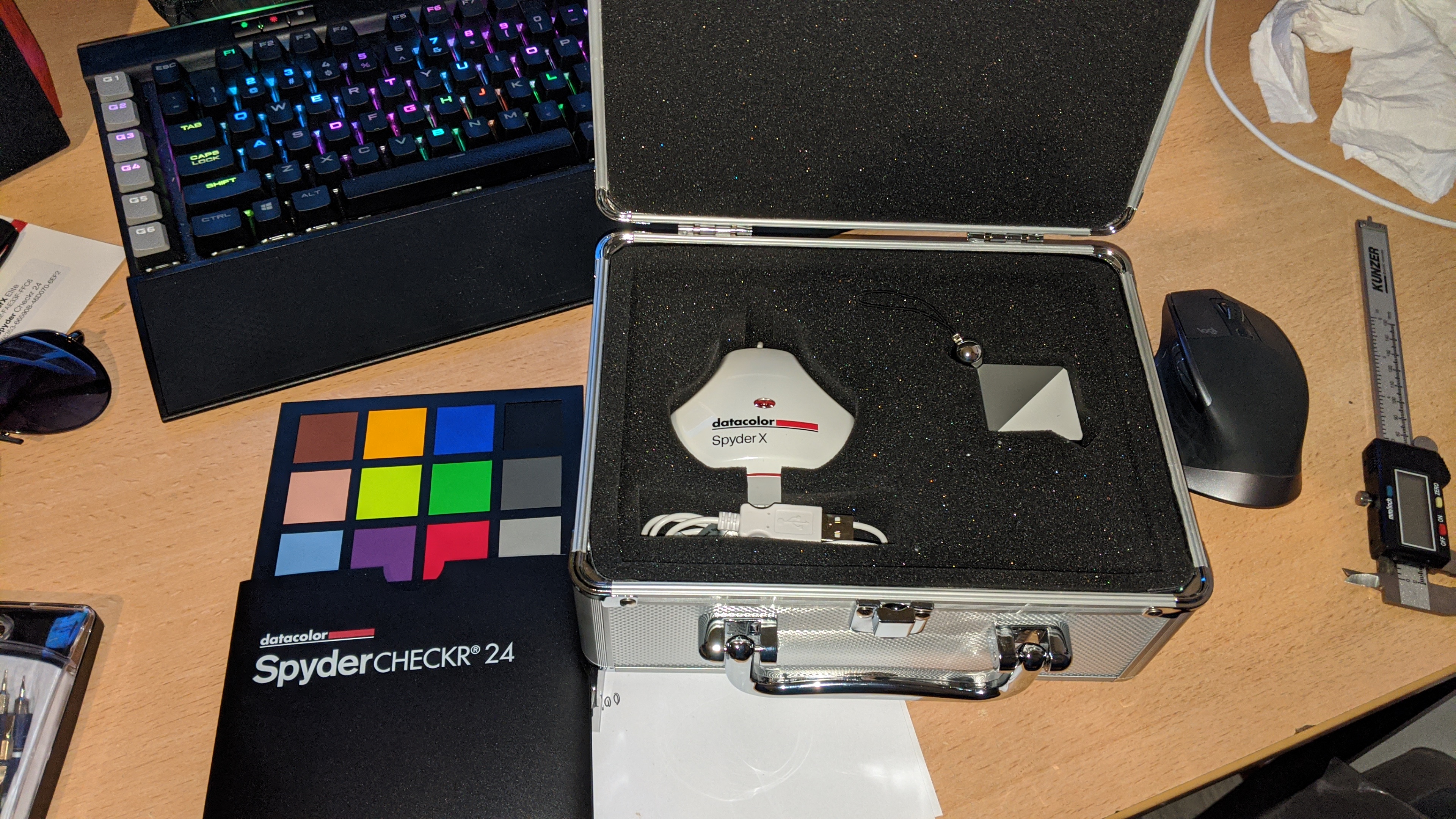

    Also, the biggest sin with color correction is not having a calibrated monitor. Don't do that.

    I have been thinking about getting a monitor calibration device for some time, as I see quite a big difference between my multiple screens. Do you recommend the Spyder Pro 5?
