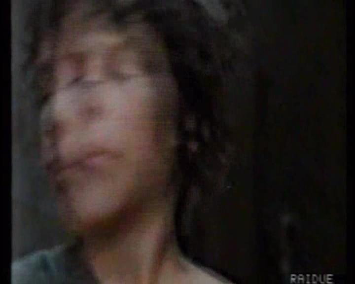

    I am a very novice AviSynth user. I can do some basic functions like IVTC but that is about it. I’ve come across a video that I would like to fix. It suffers from field blending and I’m hoping that it’s possible to correct this with AviSynth.
    It was recorded from Italian TV at some point in the 80s to VHS and then later digitised, but I have no idea who did this originally so I don’t know what process they were through or at what point the field blending occurred. However it is next to impossible for me to get hold of another source, as for a long time I couldn’t even get this.
    I’ve attached a sample video with lots of motion.
    I’m spoken to someone who has 100 times more experience with AviSynth than me, but they admin they are not an expert in field blending fixes and suggested I post here as there are some members who are very experienced in this.
    This is the script I have tried so far:

  5. Yeah, you're not going to be able to fix that. About the best you'll be able to do is resize it to half height, then back to full height to blur away the residual comb artifacts (leaving "double exposures").
    Mpeg2Source("test.demuxed.d2v")
    Spline36Resize(width, height/2).Spline36Resize(width,height)
    It was originally 25p PAL but was captured out-of-phase. It was then resized vertically without any consideration for the interlacing. Find a better source.
  6. First of all just wanted to say thanks to everyone who took the time to download the sample and post in the thread - much appreciated.
    Richard1485 thanks for the info on QTGMC, whilst it hasn't helped here it is something I want to get working in case I need it in future projects.
    Jagabo - that has helped massively! Here is a before and after, might be my eyes but I think it looks a lot better - you might have to click on the images to see the differences better:
    [Attachment 54173 - Click to enlarge]
    [Attachment 54174 - Click to enlarge]
    Still not perfect obviously. And yes a better source would be the best solution, the problem is I am relying on someone who recorded it when it aired back in 1987 ish in Italy, then kept the recording and hangs around forums where this sort of stuff is discussed. I've been looking for a better source for a couple of years now, myself with English speaking collectors and a friend in Italy with Italian speaking collectors - unfortunately we've both come up empty handed. But all considering I am very pleased with the outcome - I owe you a pint Jagabo.
