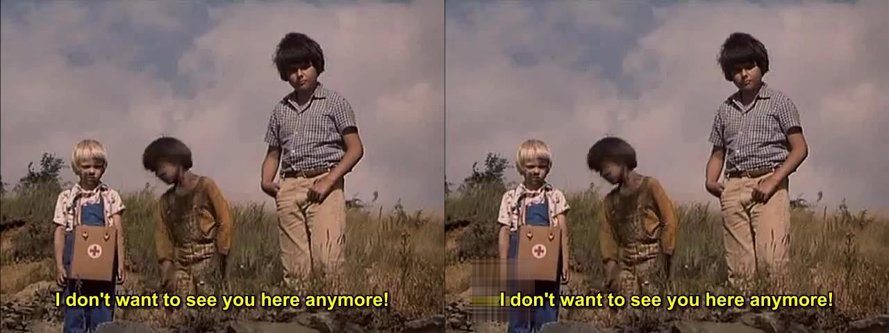

  5. Here's an example using AviSynth. I don't have a video with both hard subs and an overlapping logo. But that doesn't really matter -- I can still use a delogo filter to blur a rectangular block (where there could have been a logo) without destroying the subtitles:
    [Attachment 54166 - Click to enlarge]
    On the left is the original frame. On the right you can see the rectangular blurred delogoed box near the lower left corner -- but the subtitles in that area are still clear. In this case I was able to isoloate the subtitles because of their yellow color.

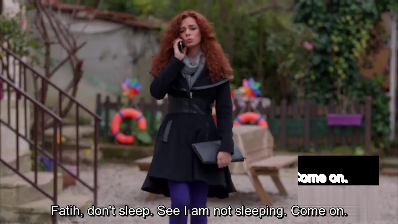

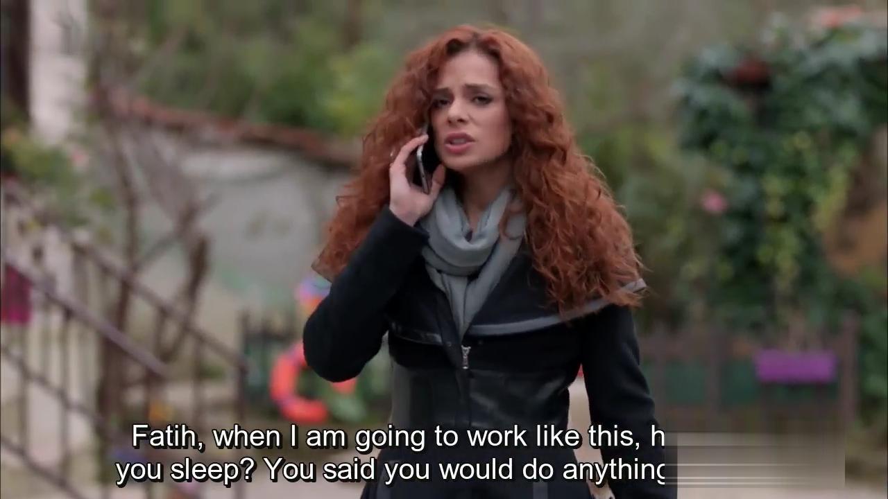

  15. Are you doing this just so you can OCR the subs?
    Here's the result of only logo removal with dekafka() (frame 220 of the test clip):
    [Attachment 54185 - Click to enlarge]
    So far what I have is this with subtitle preservation:
    [Attachment 54184 - Click to enlarge]
    It's not perfect -- but is it good enough for you?

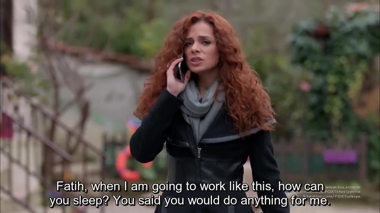

  19. If you only need to make the logo less visible for OCR a simple script like this might be enough:
    logox = 958
    logoy = 608
    logow = 260
    logoh = 96
    logoframe = 395
    LSmashVideoSource("vlc-record-2020-07-16-08h28m17s-abc.mkv-.mp4")
    logoonly = Trim(logoframe, logoframe).mt_binarize(150).Crop(logox, logoy, logow, logoh).GreyScale()
    Overlay(logoonly, x=logox, y=logoy, mode="Subtract", opacity=0.33)
    That darkens the logo a little -- maybe enough so the OCR won't see it.
    [Attachment 54188 - Click to enlarge]
    You can play around with the opacity value to reduce it more or less. If you set it too low the logo won't be reduced enough, too high and it may interfere with the OCR of the subs.
    I used frame 395 as a source for the logo. If you use this on the full video you'll need to change the frame number to a frame where the logo is clearly visible over a darkish (totally black would be best) background.

  21. The adjustments made in the post #19 script are very specific for your situation. They won't help much in the general case.
  22. I decided it was too much work to document each step of the process. And at this point jraju probably wouldn't understand much of if anyway. So here's the script just some cursory comments:
    # The location, width, and height of the logo we're going to remove,
    # and a frame where it stands out from the background.
    logox = 958
    logoy = 608
    logow = 260
    logoh = 96
    logoframe = 395
    # get the source video
    # Inpaint the FOX log at the top left
    dekafka(60,42,76,32,255)
    # get the logo and subtract a percentage of it from every frame
    # This darkens it a bit making it easier to to differentiate from
    # the subtitles.  Don't darken too much or it will interfere with
    # the subtitles.
    logo = Crop(logox, logoy, logow, logoh)
    logo = Overlay(logo, logoonly, mode="Subtract", opacity=0.33)
    # The subtitles are bright white text with a black outline and drop shadow.
    # This builds a matte of the subs by locating small bright white areas
    # (3 pixels thick or less) surrounded by black.
    brights = logo.mt_binarize(200)
    darks = logo.mt_binarize(40, upper=true).mt_expand().mt_expand().mt_expand().mt_inpand().mt_inpand().mt_inpand().GreyScale()
    subs = Overlay(darks, brights, mode="multiply").mt_expand().mt_expand(chroma="-128")
    subs = Overlay(subs, subs, x=3, y=3, mode="add")
    #Inpaint the entire logo area, including any subs in that area
    dekafka(logox, logoy, logow, logoh, 255)
    #Then restore the subtitles from the original video
    Overlay(last, logo, x=logox, y=logoy, mask=subs)
  23. Originally Posted by johnmeyer View Post
    I can't speak for the OP, but your results look absolutely amazing to me.
    Thanks!
  24. Impressive work indeed. But some letters are not perfectly restored, like the "C" at 00:02 or the "h" and "g" at 00:09, all of which are located right at the border of the "inpaint" area. How can this be explained, since the subtitles are restored at the last step ?
    If the video happens to have been released with subtitles burnt-in, it should be possible to find those same subtitles as standalone SRT files.
  25. Originally Posted by abolibibelot View Post
    The mask didn't fully capture those letters. You can see a little notch in the mask (overlaid above the logo area).
    [Attachment 54190 - Click to enlarge]
    After looking more closely at the process of building the map I realized that the problem is in the drop shadow. The first "subs = Overlay..." line builds the mask for the white text and black outline:
    [Attachment 54193 - Click to enlarge]
    The second "subs = Overlay..." line builds the drop shadow three pixels to the right and three pixels down.
    [Attachment 54194 - Click to enlarge]
    There's a notch in the drop shadow corresponding to the missing part of the letter C in the first mask.
    To fix this the mask would have to include more of the image to the left so the missing parts of the C are available to fill in that small area. The annoying thing is that I originally built the mask using the entire frame but took the time to modify it to only the logo area (not anticipating this problem). So the original script didn't have the problem.

  27. Member jraju's Avatar
    Mar 2013
    India
    On reading the scripts, i think you have posted a general formula for all, marvellour
    your explanation at the first two lines of codes , gave the description to that effect.
    So, what i will do is just apply your code , after downloading the three software you mentioned, ok,
    it is enough if i know how to run the scripts,
  28. No, almost everything in the scripts in post #19 and #22 is specific to this particular video. They may even need tweaking for other parts of your full video. The concepts can be adapted to other videos but that will require changes to the scripts.
  29. Here's an updated script that avoids the notches in the subtitle mask of the script in post #22. Rather than building the mask using only the logo area this script builds the subtitle mask using the full frame, then crops the mask down to the logo area just before using it. I used my own BlurBox() function to blur the logo area rather than inpainting with dekafka(). That also allowed a more from fitting logo box.
    function BlurBox(clip v, int X, int Y, int W, int H, int "shade")
        shade = default(shade, 0)
        bw = (((v.width / 32) + 4) / 2) * 2
        bh = (((v.height / 32) + 4) / 2) * 2
        bl = v.BilinearResize(bw, bh).BilinearResize(v.width, v.height).Crop(X, Y, W, H).ColorYUV(gain_y=shade)
        softedges = BlankClip(bl, color=$ffffff).Crop(2,2,-2,-2).AddBorders(2,2,2,2,color=$0).Blur(1.0).Blur(1.0).ColorYUV(cont_y=50)
        Overlay(v, bl, x=X, y=Y, mask=softedges)
    logox = 958
    logoy = 624
    logow = 260
    logoh = 48
    logoframe = 395
    # blur the FOX logo in the top left corner
    BlurBox(60,42,76,32,-64)
    # the subtitles.
    logodarkened = Overlay(last, logoonly, mode="Subtract", opacity=0.33, x=logox, y=logoy)
    brights = logodarkened.mt_binarize(200)
    darks = logodarkened.mt_binarize(40, upper=true).mt_expand().mt_expand().mt_expand().mt_inpand().mt_inpand().mt_inpand().GreyScale()
    submask = Overlay(darks, brights, mode="multiply").mt_expand().mt_expand(chroma="-128")
    submask = Overlay(submask, submask, x=3, y=3, mode="add").Crop(logox, logoy, logow, logoh)
    # Blur the entire logo area
    BlurBox(logodarkened, logox, logoy, logow, logoh)
    #Then restore the subtitles from the video with the darkened logo
    Overlay(last, logodarkened.Crop(logox, logoy, logow, logoh), x=logox, y=logoy, mask=Submask)
  30. Member
    Dec 2012
    Male' Maldives
    Hi jagabo,
    Thank you for the the script. jraju and I were working on this clip together. I too am new pretty new to avs but over the last couple of days, I've managed to get the most recent Blurbox script to work. This would save a lot of time I spent fixing the OCR.
    Thanks again.
