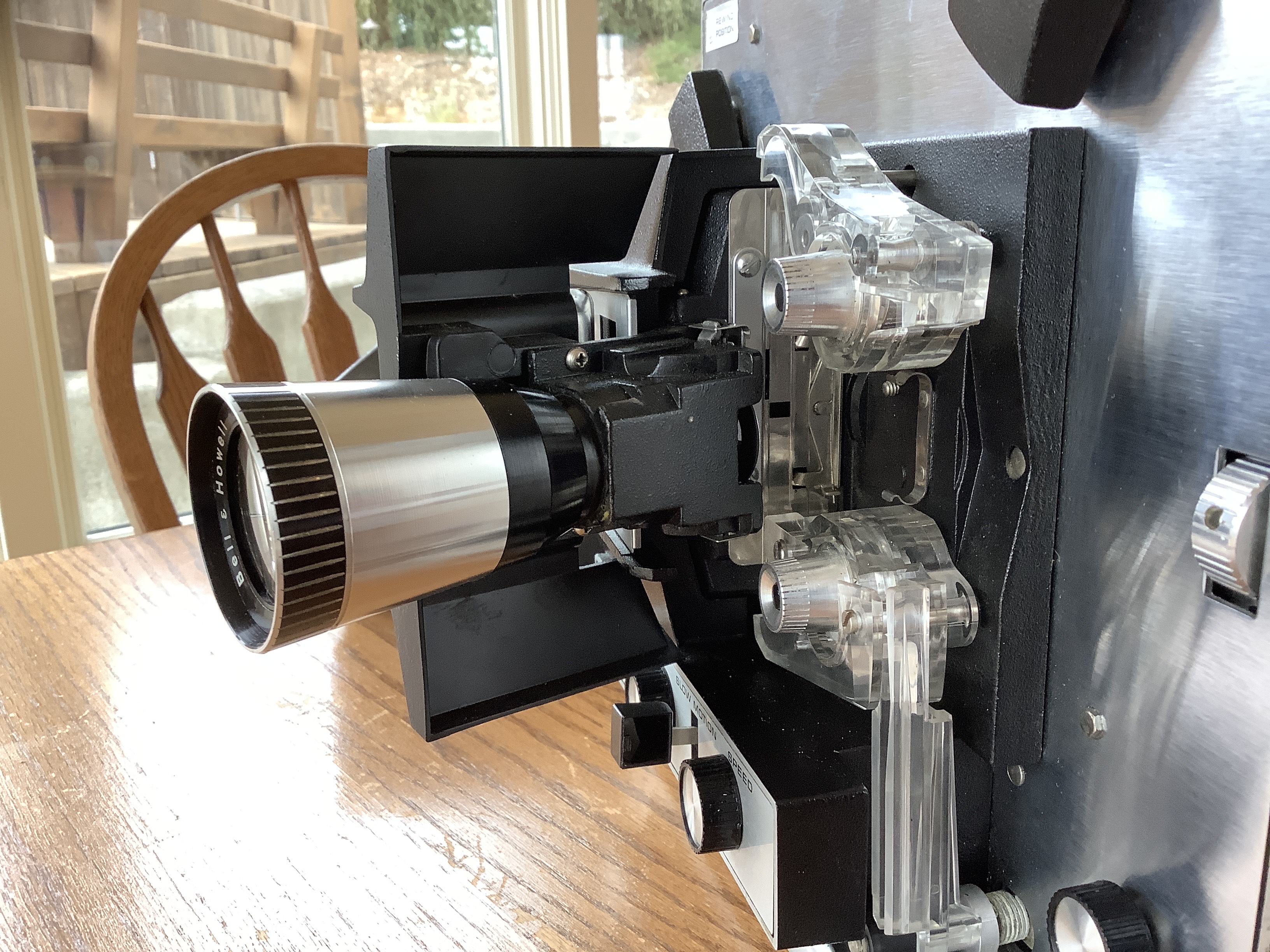

  4. OK, my projector is in a closet thirty feet from me. I've attached three pics, including one looking down through the lens. I thought you were talking about the condenser, which is located back in the body of the projector. If you are talking about the lens itself (which I show in the pics), and it has "bubbles" or any other visual degradation, it is shot and cannot be repaired.
    I have never been able to figure out this site's lousy image uploading, so all I can do is attach them. Hopefully it will be enough to let you see what I have.

  5. Thanks, that helps! Now when I hold my lens as you are in the picture, it looks the same. Could I ask if you would use it as a telescope and hold it up to a light (looking from the rear lens) and tell me if you still have a clear view of the light?
  6. Originally Posted by 7611wpd View Post
    It is like any lens I've ever looked through: totally and completely clear with no visible flaw in any of the glass elements inside the lens. That is the only way a lens can possibly be, if it is going to do its job.
