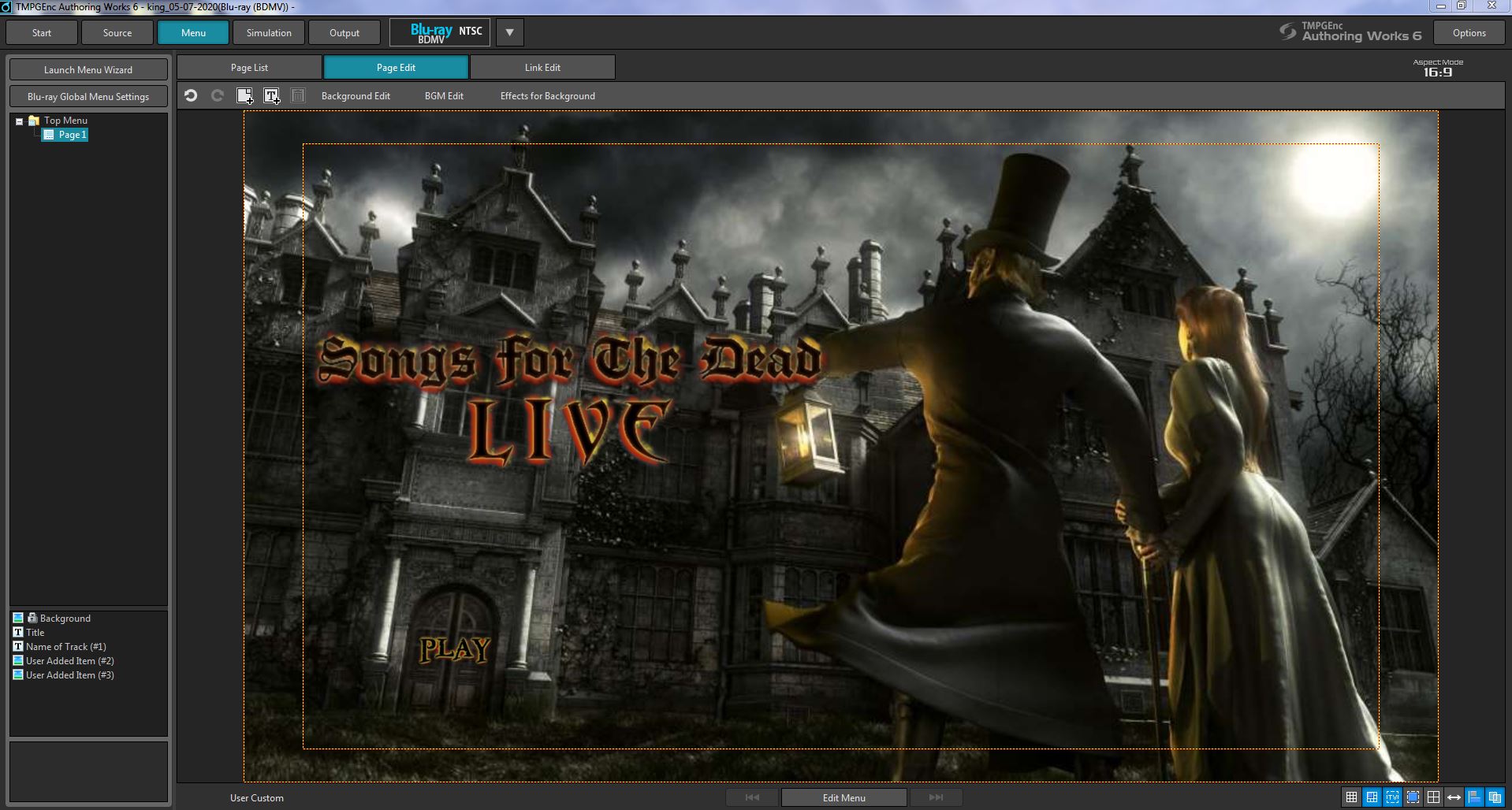

    i'm using TMPGEnc Authoring Works 6,here's a screen of menu creation of BDMV
    [Attachment 54106 - Click to enlarge]
