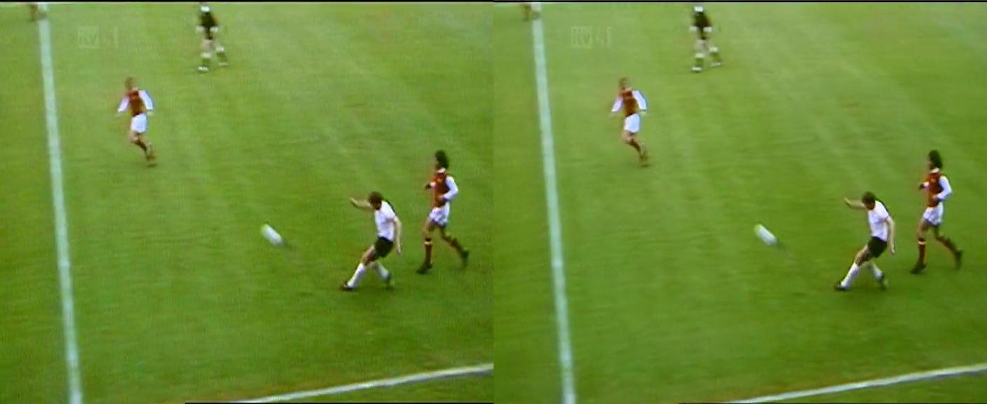

  1. Hi. Here's a clip from a TV programme. I converted it using MeGUI/DGDecode/QTGMC and the resulting file plays fine on my PC. However, I watch my vids on the TV using a Dune HD Solo Lite which is a terrific bit of kit. With this file, though, when the football is kicked down the pitch, there appear to be 3 balls - the real one and a shadow ball either side. Having been deinterlaced with QTGMC, this shouldn't be happening. I'm better off with the original .ts file.
    Could someone confirm that a simple QTGMC is all that's needed here? And maybe suggest why my conversion is playing so oddly on the TV? Thank you.
  2. Try AssumeTFF() before QTGMC(). It looks normal here. Simple Bob() on the left (for reference), QTGMC() in the right:
    [Attachment 54085 - Click to enlarge]
    Make sure any noise reduction filters are turned off on your player.
