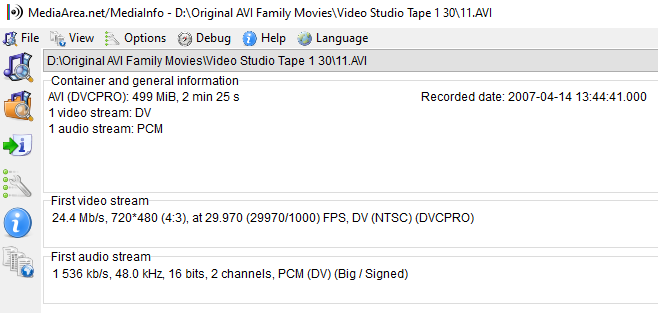

  1. I have about 300 old home movies stored as avi files and a few do not have audio in Plex. I tried converting them in plex but audio was still not available. I have tried converting the files to mkv with the common converters I would usually use including handbrake and nothing seems to see the audio file except vlc media player. I also tried fixing the file with vlc codec avi repair tool but nothing. I tried a tool to convert from avi 1 to 2 and it failed. Any suggestions . Image

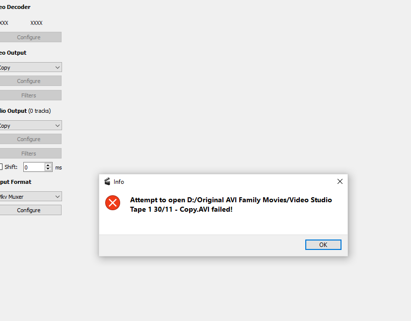

  3. The file will not open. I tried other files that I successfully was able to convert to mkv with audio in other software and they will not open either.
    [Attachment 54072 - Click to enlarge]

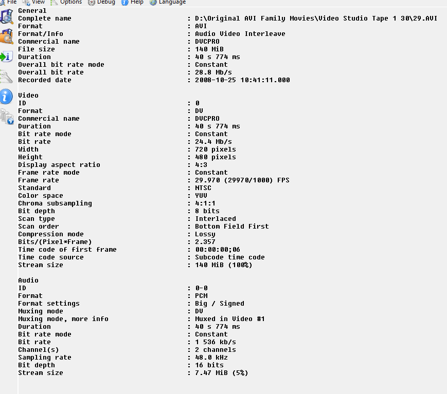

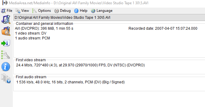

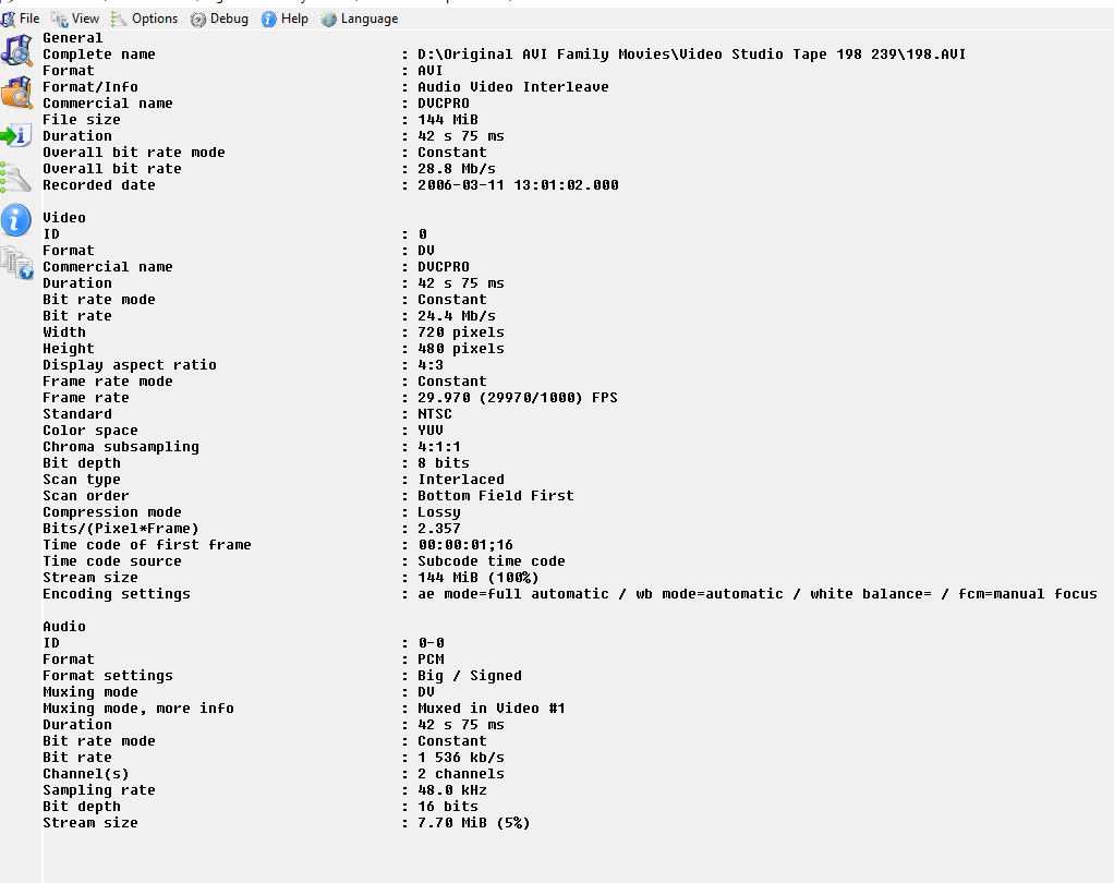

    When you compare a good file to a bad in mediainfo in text view (for more details) do you see anything different in the audio/video specs?

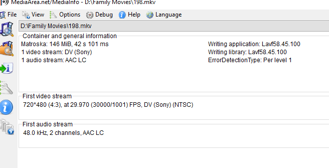

  15. This one has good audio, updated with correct file. Other than the date I see no differences.

    Originally Posted by Erik Goetz View Post
    well that has aac audio, the other was PCM.
    Text view gives more details
