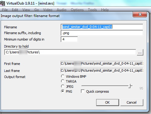

  1. I am suddenly getting an error with Virtualdub when trying to export image sequences. I use this to try to match frames from different DVDs (I just use the snapshot fuction in VLC when capping but not comparing) and have used it for years. I open the d2v in Virtualdub as an avisynth file and mark the frame I want to export. Today when I export I get "cannot open file'filename.png'": access is denied". I'm using Virtualdub 1.9.11 which is outdated but is not limited in anything I need to do. I haven't used it for a few months but I don't think I have forgotten anything. The avisynth file opens without problems.

  4. Windows isn't allowing VirtualDub to create a file in the selected location. Try somewhere else.
  5. Never had a problem saving to Pictures folder before. I tried other folders and get the same error.
    Sep 2016
    You might have turned on Windows controlled folders. I recommend it to be turned on but you need to add some executables to the allowed program list.
