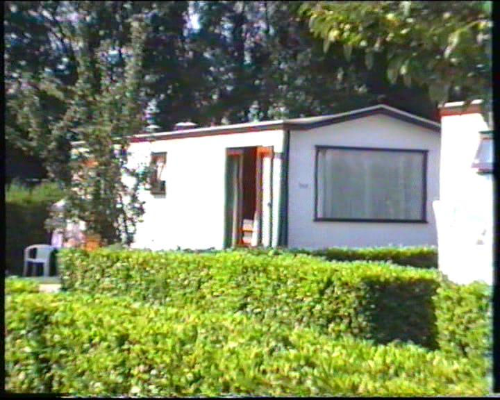

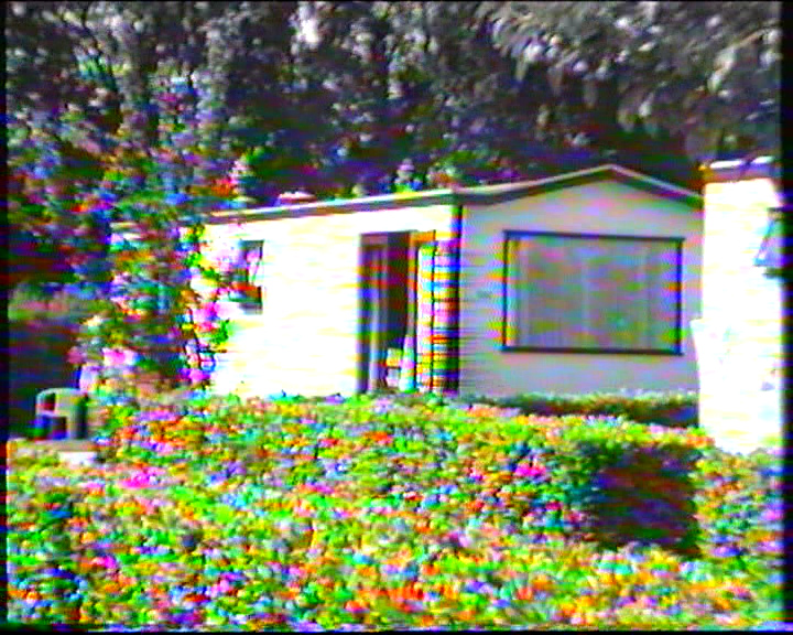

I am digitalizing some old VHS-C tapes from the 90's. However when the last few tapes where shot back then, the camera was going bad. Apparently one of the record heads was going bad, resulting in noise and and reduced colors in only the odd frames. The other frames look good. see the examples below.
I was wondering if it is possible to improve those bad frames using the good ones. But since i have alsmost no experience at video editing i have no idea how. So i was wondering if someone knows some tricks to do this. I am currently using adobe premiere pro CC 2015 and i also have after effects installed.

Good frame:

Bad frame:

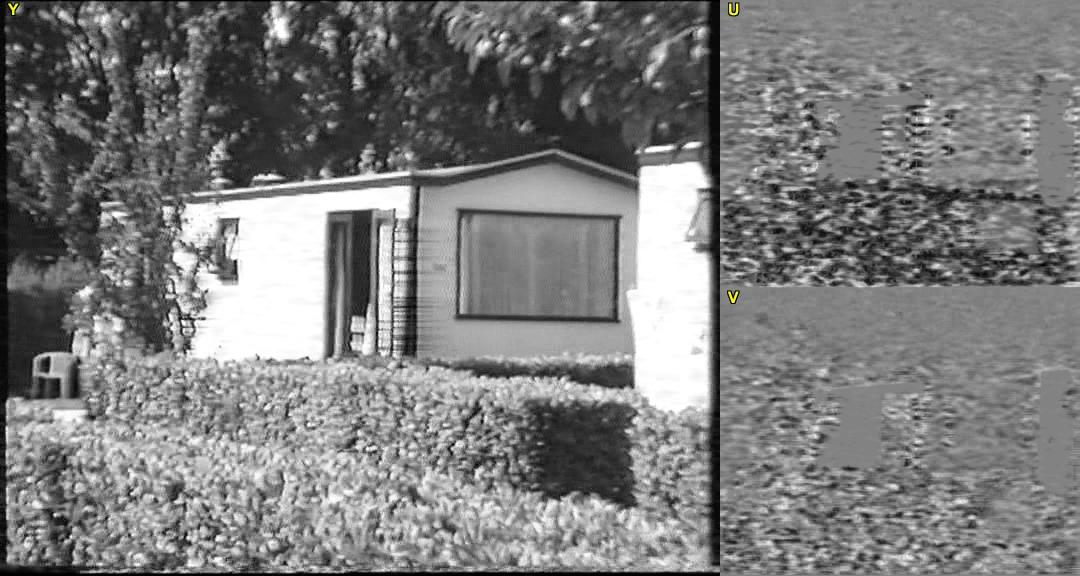

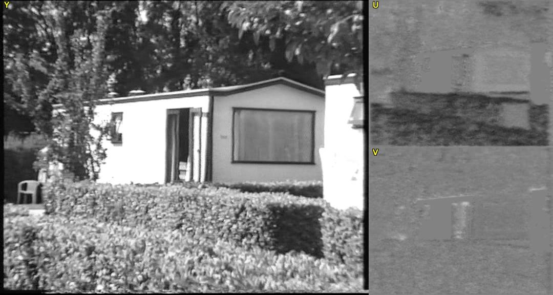

If you look at the Y, U, and V channels you'll see that the problem is mostly in the chroma channels:
Good YUV:

Bad YUV:

If the bad frames are infrequent and there's not too much motion you can detect the bad frames and replace the chroma with the chroma of a good frame (in AviSynth):
