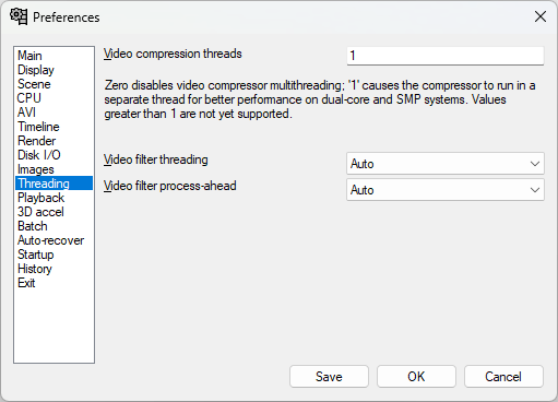

    I realized some settings are increase the performance of filter processing speed (for me from 13fps to 60fps, i use external encoder with cuda settings).
    [Attachment 74190 - Click to enlarge]
