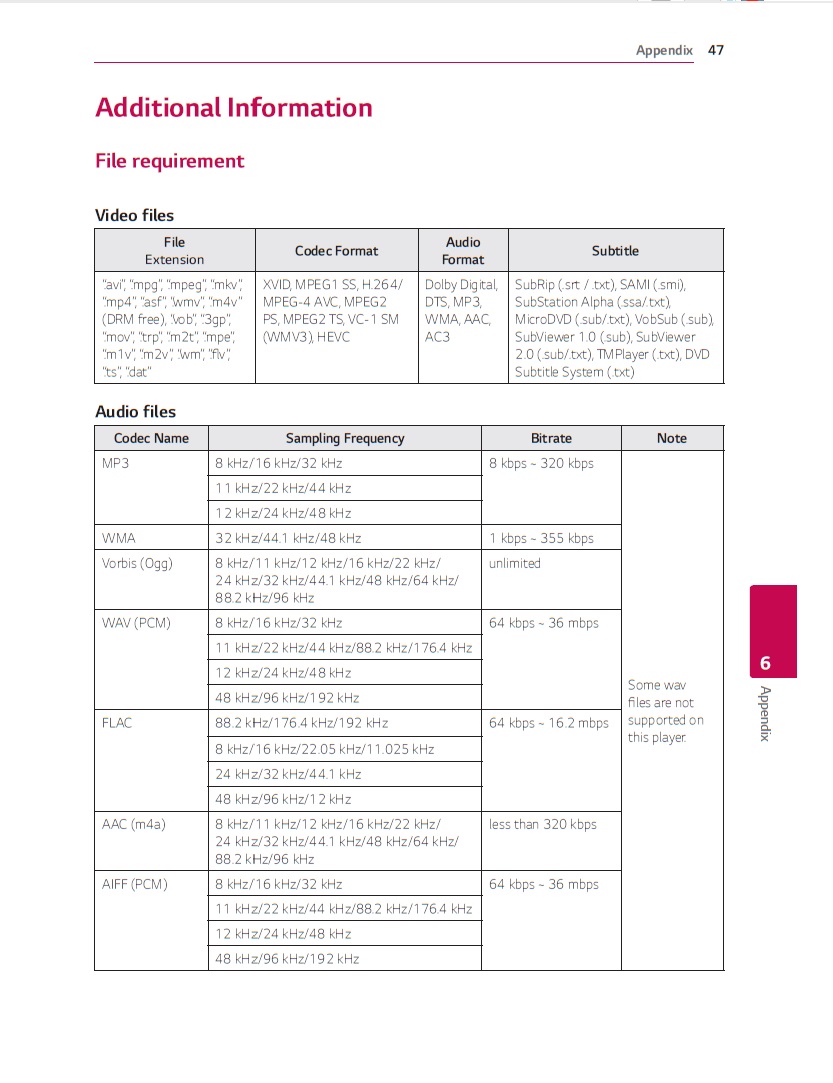

    If you need HEVC support, some UHD Blu-ray players play media files, including mkv (with limitations on encoding parameters) and a limited selection of subtitle formats. Example from LG UBK90 manual attached below.
    [Attachment 54026 - Click to enlarge]
