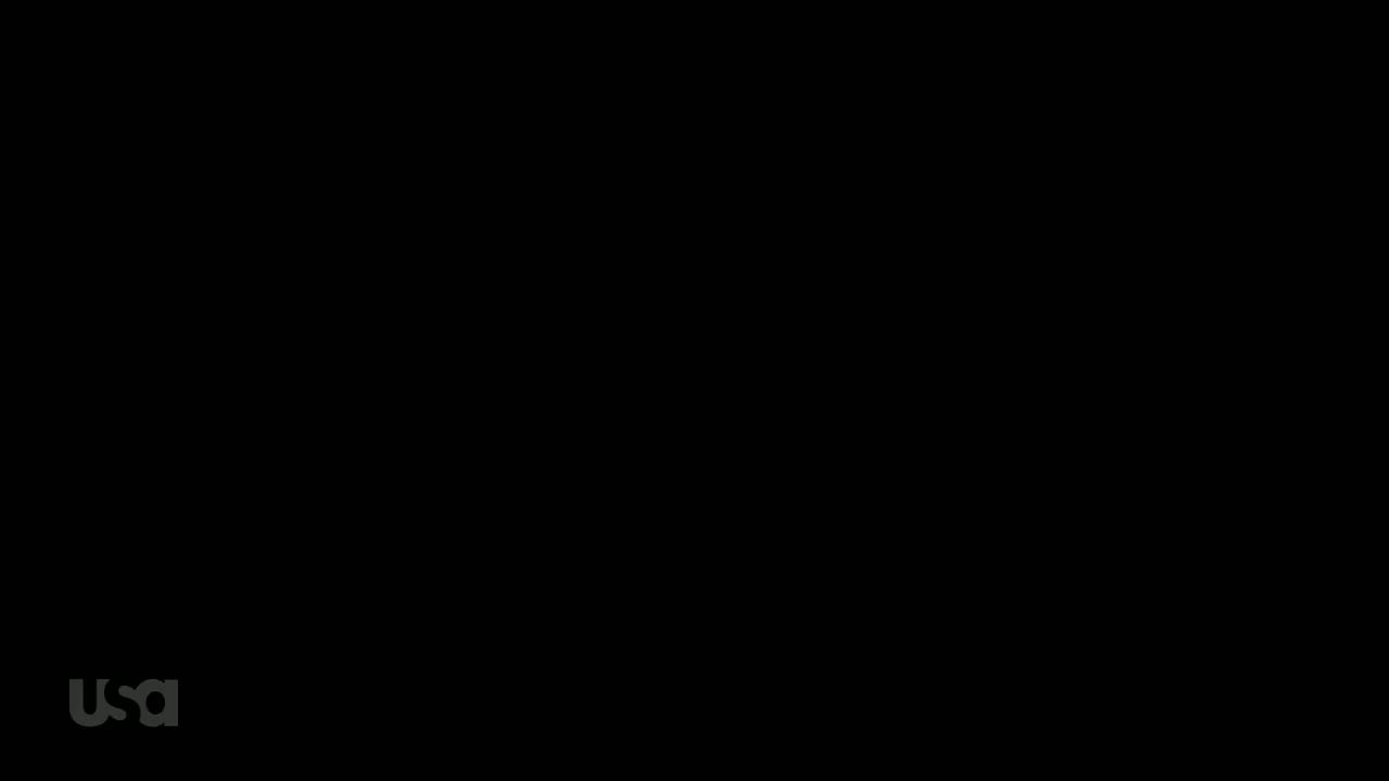

    The basics are pretty simple. You need to supply a mask that marks where the logo is, then call InpaintLogo() with that mask.
    You can always export a frame and edit it in a paint program to create a mask. But an easier is to find a completely black frame (aside from the logo), then use that as your mask.
    LWlibavVideoSource("video.mkv")
    logo = Trim(43666,43666).mt_binarize(30).mt_expand().mt_expand(chroma="-128")
    InpaintLogo(mask=logo, radius=10.0)
    I used the defaults for everything here except radius.
    A black frame with logo:
    [Attachment 53884 - Click to enlarge]

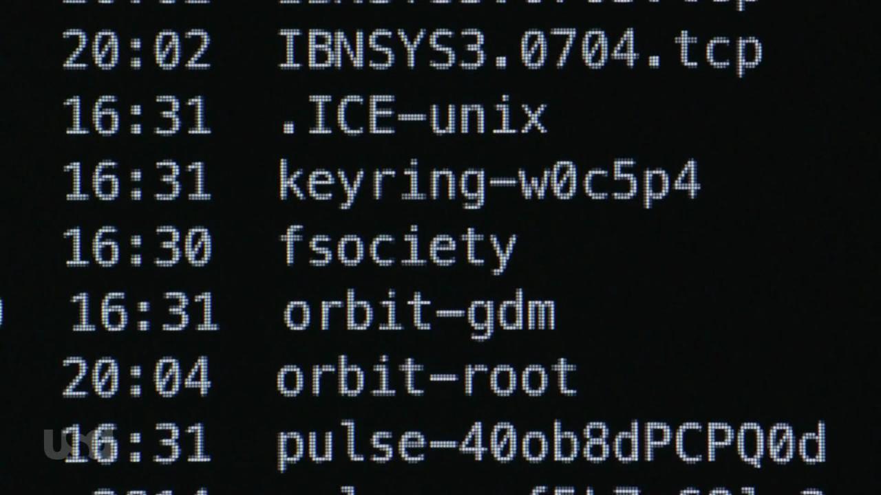

    A frame before Inpaint:
    [Attachment 53886 - Click to enlarge]

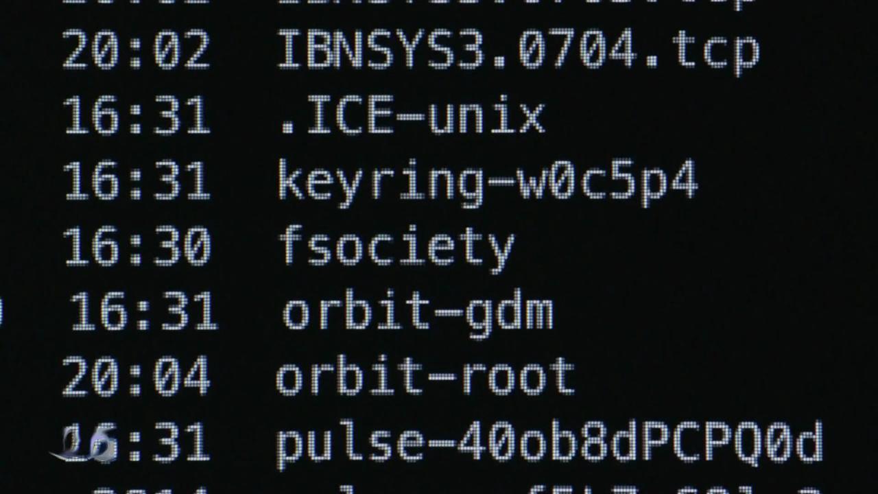

    After Inpaint:
    [Attachment 53887 - Click to enlarge]
    In some parts of the video it works well, in others not so well.
    Of course, this particular logo is semi-transparent and would be better removed with an unblending.
