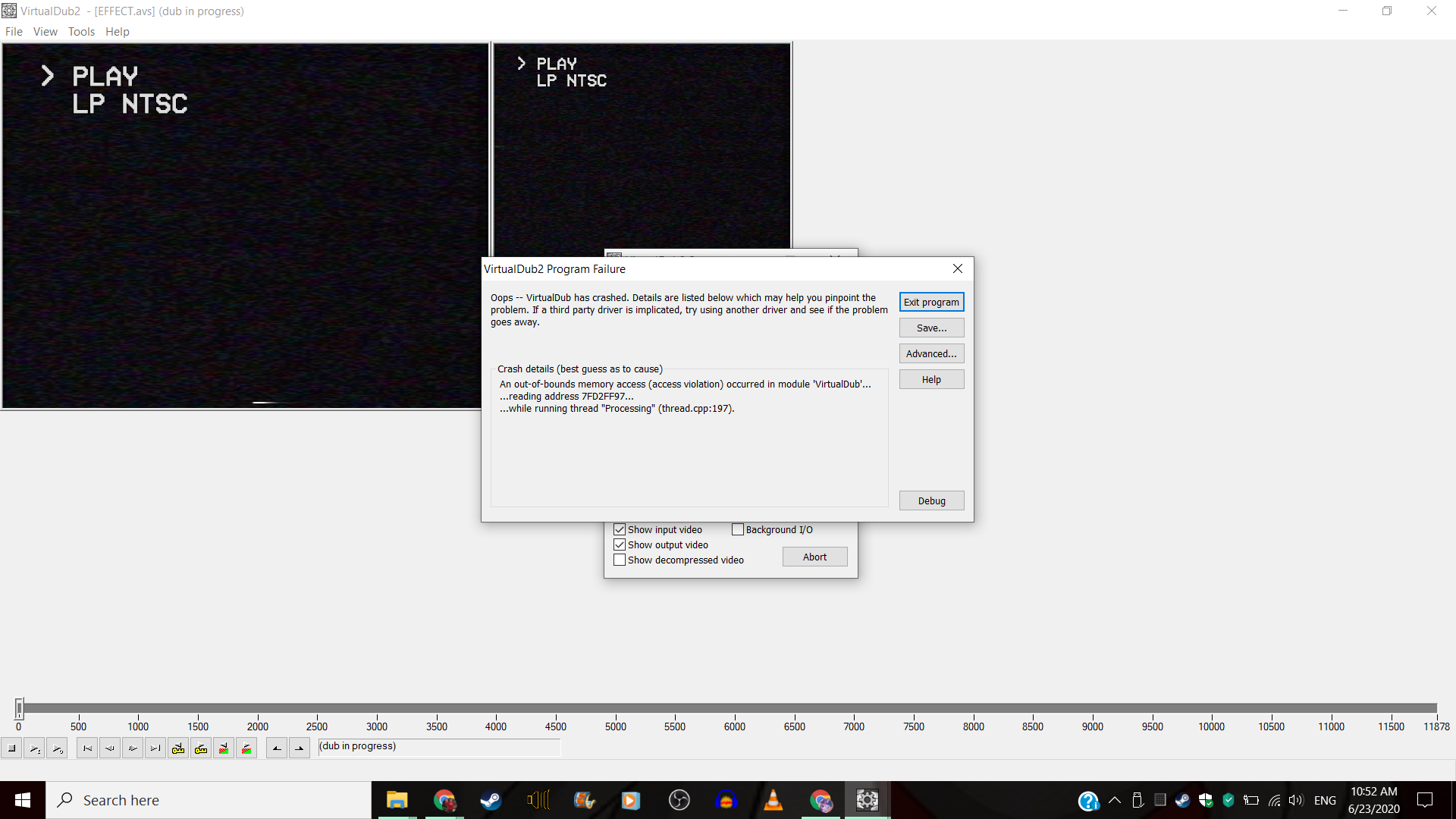

    Well, I'm trying to use the AVISynth VHS effect after such a long time. It did work this first time, but now I'm getting this annoying error:
    An out-of-bounds memory access (access violation) occurred in module 'VirtualDub64'...
    ...reading address FFFFFFFFFFFFFFFF...
    ...while running thread "Processing" (thread.cpp:197).
    And here the crash debug information if you need it: https://mega.nz/file/qSwWTCxY#Oj55-D2FwQTbt9nBZFYfeGSkvNaDvvX52jDG5vos238
    Can anyone please fix it for me? I haven't uploaded anything on YouTube in a long time because I'm making this video since I graduated from high school this week. So, if anyone can fix it for me, it would be awesome.

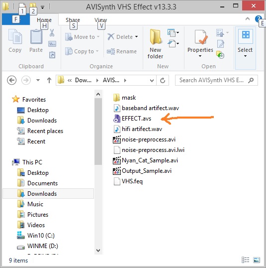

    Just edit the script (effect.avs) similar as I showed in the example above (post 5), open Virtualdub2 and drag the effect.avs icon
    into the Vdub window. It will open and the video will display or you'll get an error message

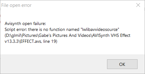

    Well, I got this error.
    And this is how I edited the script:
    Did I do it wrong?

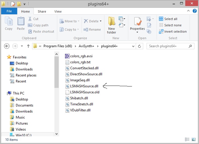

    Did you install the function as I mentioned in post 7 ?
    You can see here the 64 bit plugin folder where I placed the 64 bit version of Lsmashsource.dll

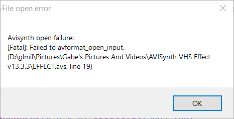

    Well, I am still getting an error. I just don't know what I'm doing wrong. Do I put the code exactly as it is on the script or do I change it to suit my needs?
  16. You have to change it to suit your needs
    Change the path to match your actual file paths and video names
    Mar 2008
    Yes, "solid geometry" is a short film I have on my hard drive. You can't access it from where you are

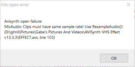

    Mar 2008
    Use mediainfo on your video file to find the sampling rate of the audio stream
    The message is telling you what's wrong, the sampling rate of your audio does not match the "noise" sample (WAV file) in the
    VHS effects folder. The script is trying to mix in some broadband noise into your files audio to make it sound crappy
    When you find out what it is you can change this line so that the resampleaudio matches your file
    audnoise=wavsource("baseband artifect.wav").resampleaudio(48000).loop(600)

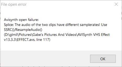

    Mar 2008
    The error is related to this statement, which joins your video to a short blank clip to mimic the VHS lead in:
    player+final
    To make it work, modify the audio_rate on this line to match your video:
    player=BLANKCLIP(length=60, color=$2222DD, fps=29.97, CHANNELS=1, audio_rate=48000).converttoyv12
    player+final

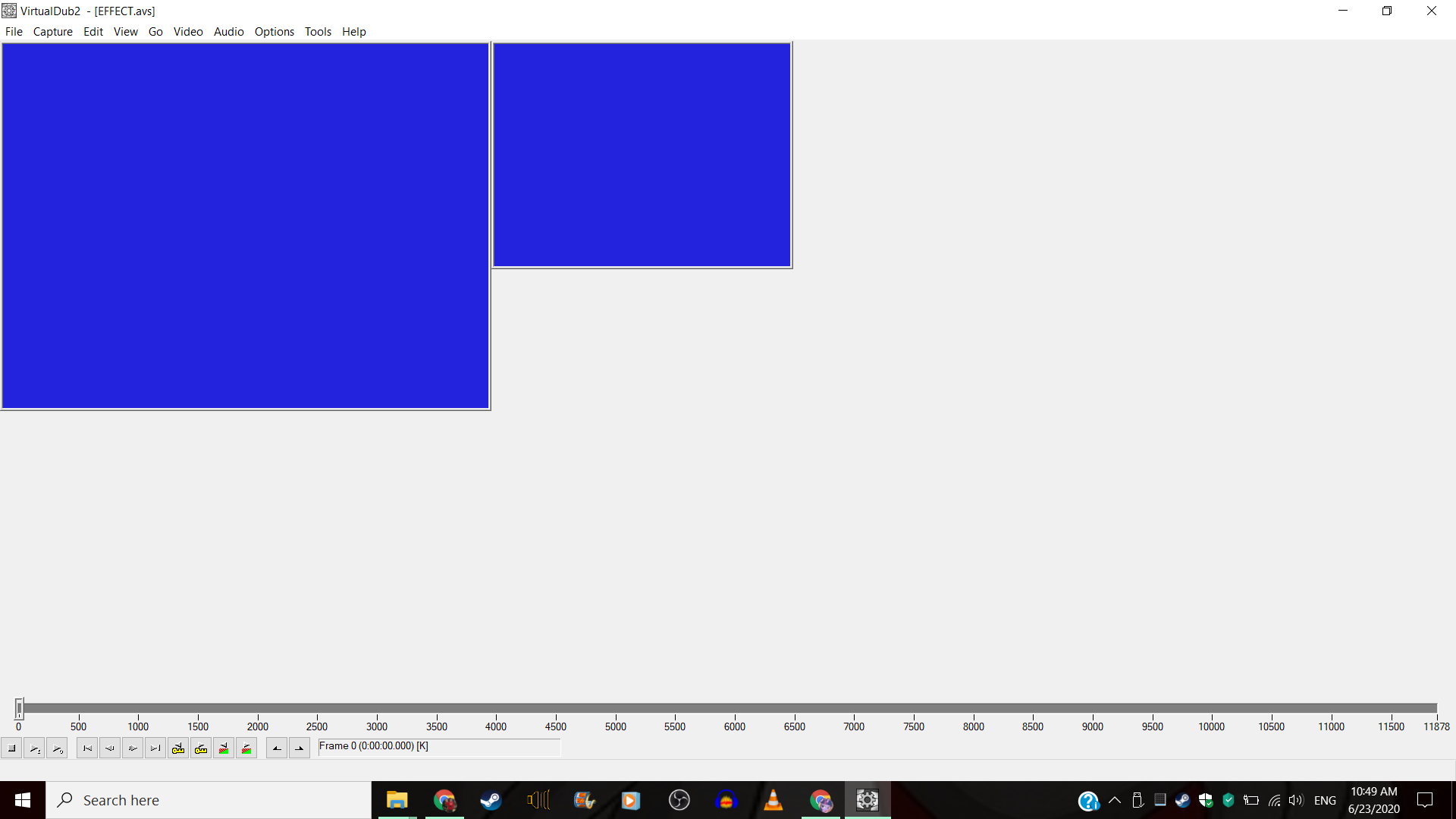

    YES! It worked! Thanks, man! I'll let you know if it stopped crashing or not.

    Ugh, it's still crashing?! I don't know how that's possible! I followed everything you said!

    The script just process the input and serves the frames, but if it is crashing during the encoding other
    things are involved.
    I can't tell what you did in Virtualdub2 and what settings you used, you haven't provided any info at all.
