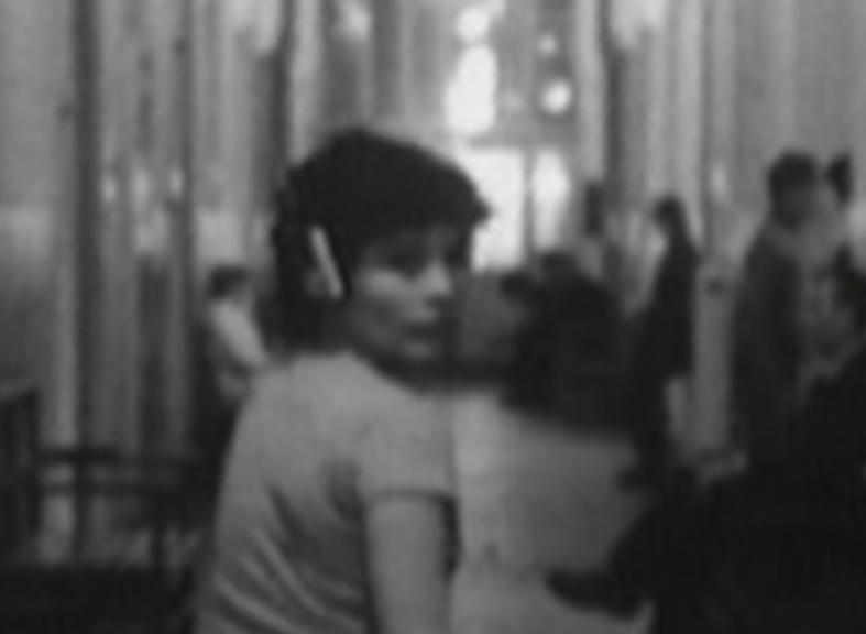

  5. The following two pairs of pics shows the results of the convolution kernel blurring that was recommended in that thread I linked to above. You have to click on the pics to view them full screen in order to see the results. The closeup of the face provides the best way to see how much detail is lost. Both pics show only a portion of the frame, in order to make it easier to see both the artifact elimination and the detail loss.
    To my eye, the convolution blur does a very good job reducing and almost completely eliminating the artifact. There is a slight loss in detail, but I was able to "recover" almost all of that by applying just a little bit of sharpening after the blur. If wanted, I can upload a third pic of the face to show what it looks like with the sharpening added, although I think I'll leave that as an "exercise left to the user."

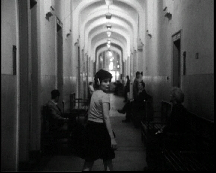

  6. You can protect parts of the picture that don't have the noise with a mask. This is the downscale/upscale blurring technique with the addition of a mask to protect other parts of the picture
    # build a mask of areas where there are
    # alternatin vertical lines
    function VLMask(clip v, int "threshold")
        threshold = default(threshold, 5)
        Subtract(v, v.blur(1.0, 0.0))#.Sharpen(0.6, 0.0))
        GeneralConvolution(0, "
           -0  0 -0
           -4  8 -4
           -0  0 -0", chroma=false, alpha=false)
        mt_lut("x 125 - abs")
        mt_binarize(threshold) # threshold
    Mpeg2Source("snippet.demuxed.d2v")
    lmask = VLMask(25).mt_expand().Blur(1.0)
    blurry = Spline36Resize(320,height).Spline36Resize(width,height).TemporalDegrain()
    Overlay(last, blurry, mask=lmask)
    I used a strong temporal noise reducer to further reduce the moving bands. If you leave that out the results are similar to johnmeyer's Convolution3D where the artifacts were, sharper everywhere else. You can play around with the downscale size, the VLMask threshold, and other temporal denoisers. Also, if you plan on using a temporal denoiser on the entire frame you can remove the TemporalDegrain after the resizers.
    I think this is the same frame as in post #5:
    [Attachment 53861 - Click to enlarge]
