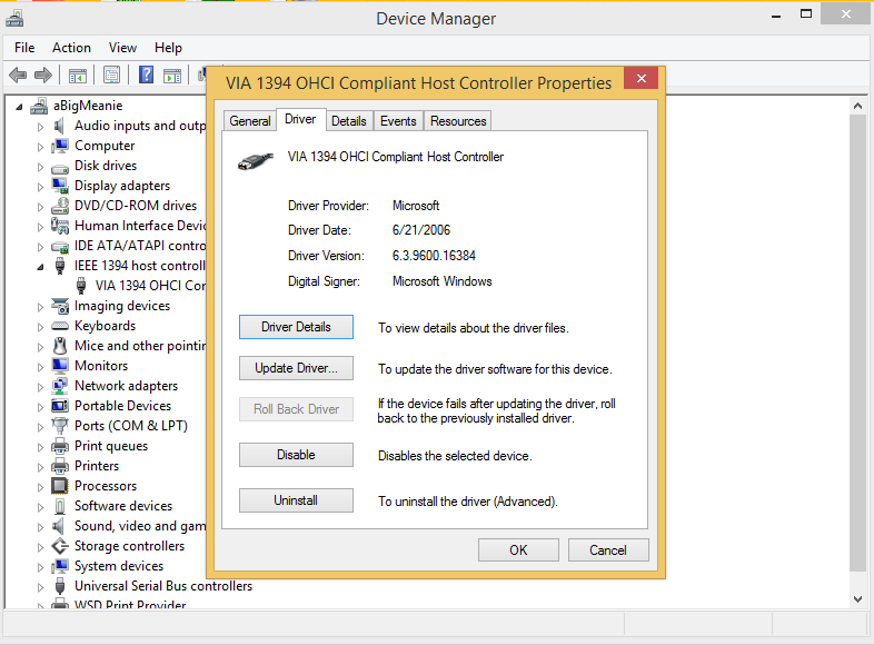

  9. aBigMeanie aedipuss's Avatar
    Oct 2005
    666th portal
    if you check the device driver and it says anything but microsoft, something's wrong. you can delete the driver, re-boot and let windows find the new device and install it's included driver. i've never had to change any firewire driver other than the standard one in winXP, win7 or win8.1, i can't speak for win10 as i refuse to use it.
    [Attachment 53870 - Click to enlarge]

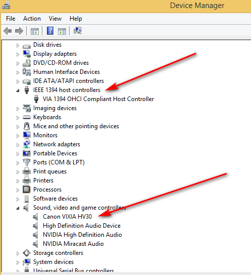

  13. aBigMeanie aedipuss's Avatar
    Oct 2005
    666th portal
    do the firewire port and camera show up in the device manager?
    [Attachment 54102 - Click to enlarge]
