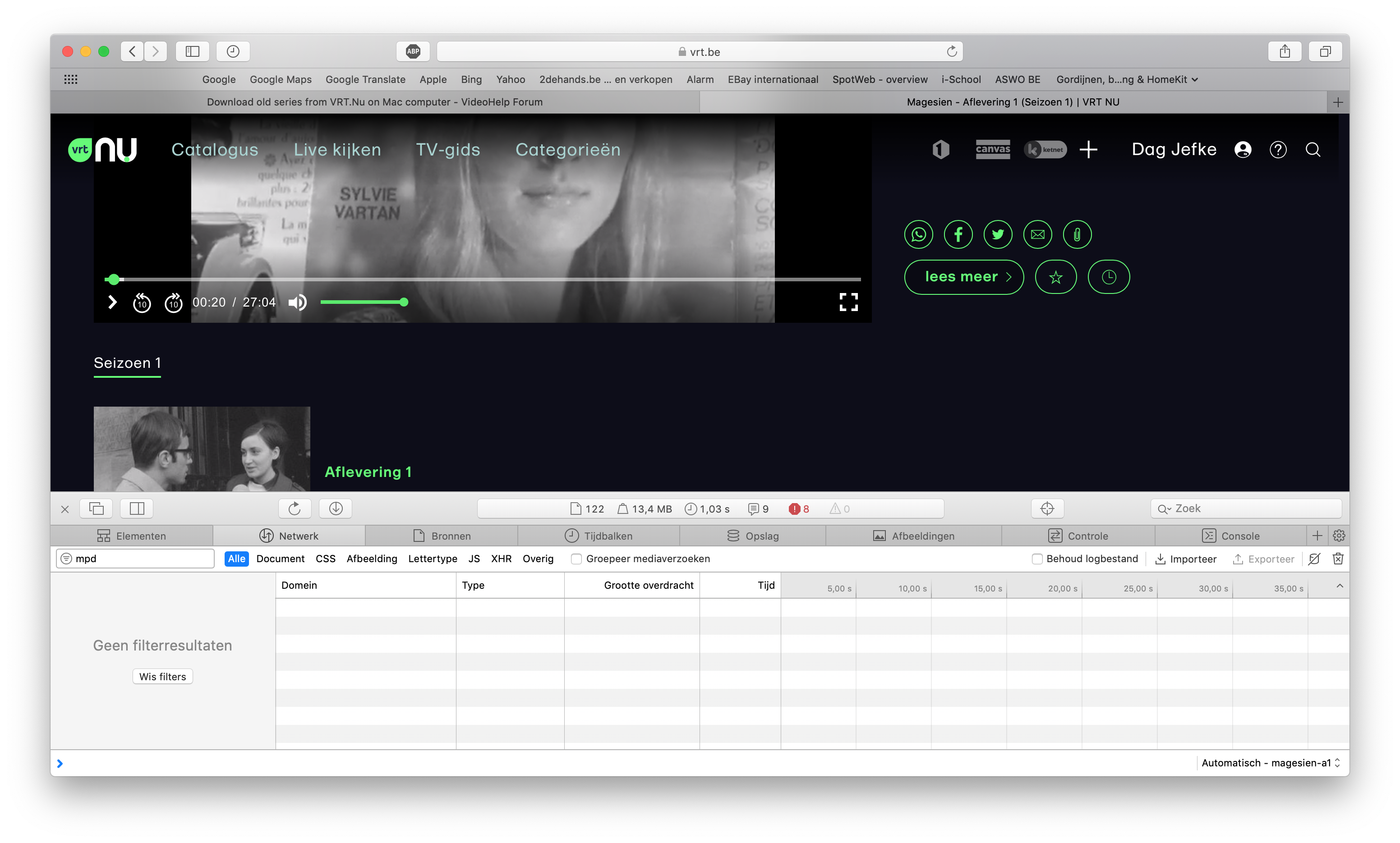

    Allright, I succeeded finally in setting up youtube-dl on my Mac.
    Could you please assist me by finding that mpd file?
    Right clicked next to the video as you suggested (had first to switch on developer tools in Safari before I succeeded in that). Next went to "netwerk", typed in mpd, refresh and playing back that video, but I don't see a link address...
    I add a screen shot. What goes wrong here...

  13. Originally Posted by raverke95 View Post
    https://forum.videohelp.com/images/attach/png.gif
    If you refresh the page again it should appear if not try Chrome or Firefox this is wat it looks like after u copied the link u can use youtube-dl with this command for the best quality video command >> youtube-dl.exe -f best https://ondemand-cf-vrt.akamaized.net/content/vod/vid-14d10194-1218-4cc5-ae97-efa98598...9176d.ism/.mpd or the easy way just copy and paste the link in tvdownloader simple as that

    Indeed, with Firefox Mac edition it also works.

    I tried it this morning and succeeded on the iMac.
    But as well as on my macBook with Mojave running on it (iMac has Catalina), I had to use Firefox to determine the mpd file. Strange this file isn't showed by Safari...
