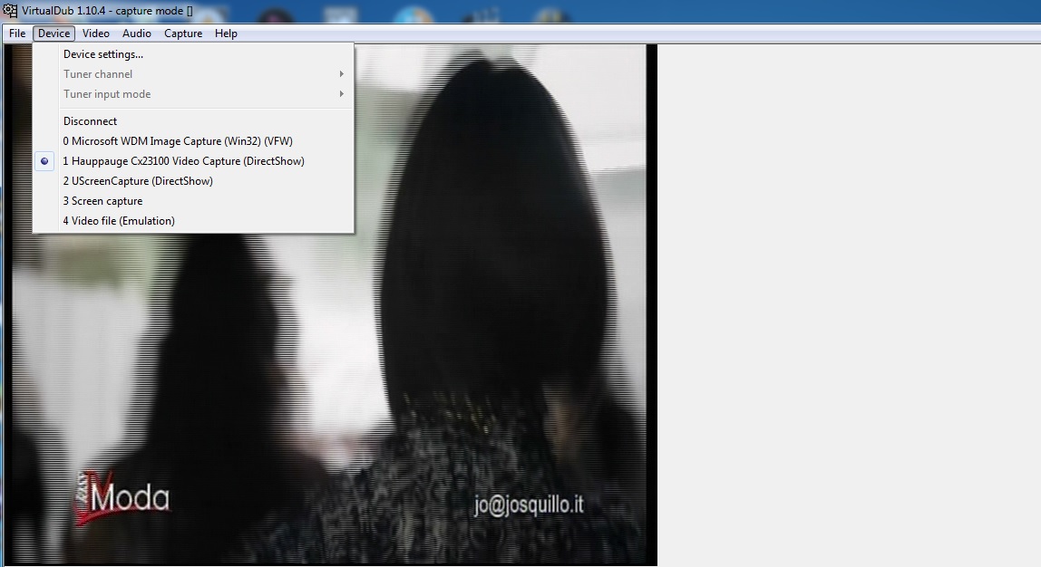

  23. Member DB83's Avatar
    Jul 2007
    I did say 'might' Windows only showed the device name under Sound, Video and Game Controllers.
    The actual device/chipset should be revealed under the 'devices' menu of the capture software. For my Hauppauge that reveals 'Hauppauge Cx23100' whereby Cx stands for conextant xxxxx as the chipset.
    What some guys also do out of curiousity is to acquire one of these cheap units without even attempting to install and actually take it apart to read the chipset.

  25. Member DB83's Avatar
    Jul 2007
    Which one ?
    The very one that this topic is all about. (Same info via vdub). But, if you have read the info, this software is not the finished article. It is provided as an illustration of what can be achieved. And, somewhat ironically, it actually uses the Amcap engine to do the work.
    But the chipset part no is all that is pertinent. Some time in the distant past I was looking for a usb device that would capture PAL60 (ntsc playback from a PAL vcr that supports NTSC playback as most should do). I had gleaned that a later model of easycap could (or should) do this. Yet by reading here I established that the Hauppauge Usb Live-2 could do this regardless (as could my legacy Win98 PCI-based Hauppauge WinTV card) so I went with that.

  27. Member DB83's Avatar
    Jul 2007
    Here are the appropriate screens from both programs as I see them.
    If you can not see anything equivalent then it somewhat confirms lordmrurf's opinion that your capture device is 'un-specified'
  28. Member
    May 2020
    Australia
    OK i understand you now.
    In Vdub mine displays as Roxio Video Capture USB (Directshow).
    Under audio there is 2 options Line (Roxio Video Capture USB) or Roxio Video Capture USB #2 (WDM).
    My device came with the Roxio VHS to DVD Plus 3, model is a HU3180-E made in Taiwan, don't know what chipsets it uses.
