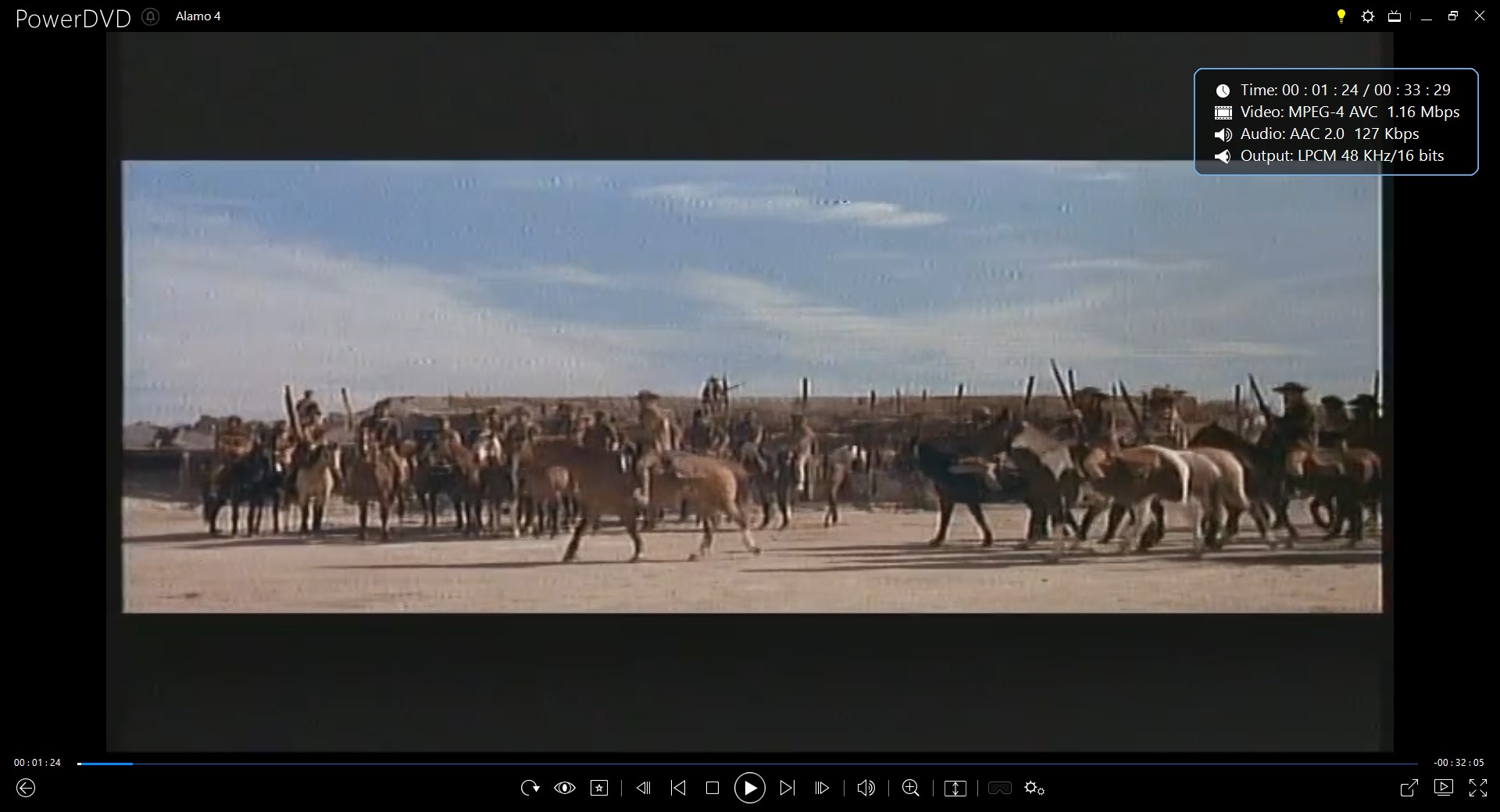

    got it working but the converstion is the same after selecting 4*3
    attached is a photo of the grab notice the length of the horses
    the file shows 720*480 being 4:3
    but some how the graber progrem sees the wide screen part of the frame and cant formt the correct ratio
Name:	Annotation 2020-06-16 111726.jpg
