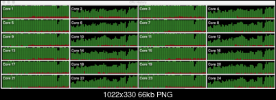

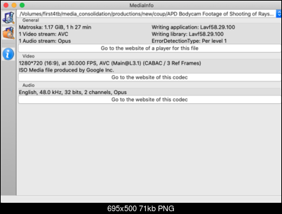

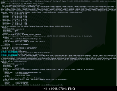

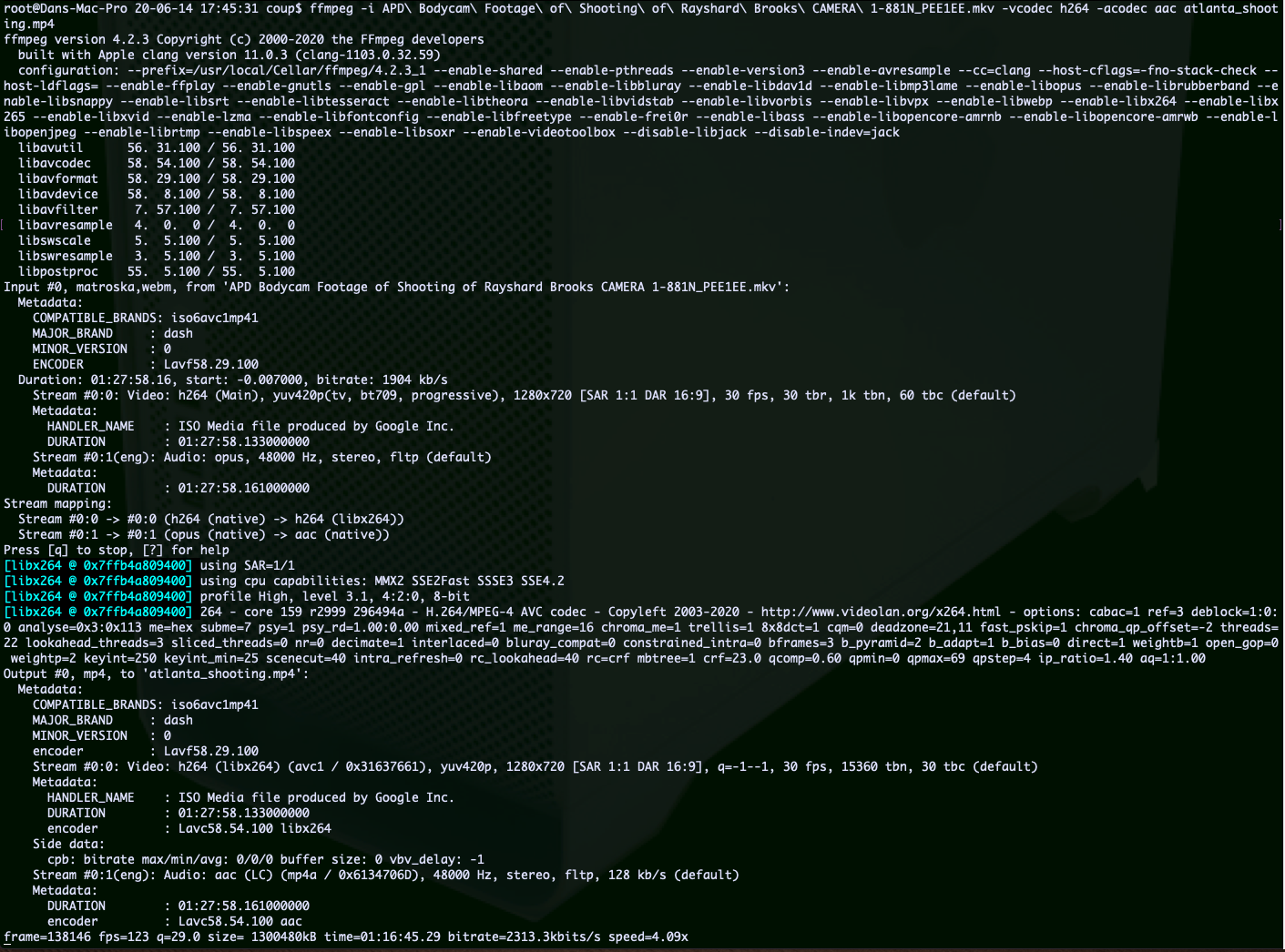

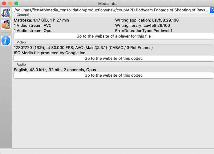

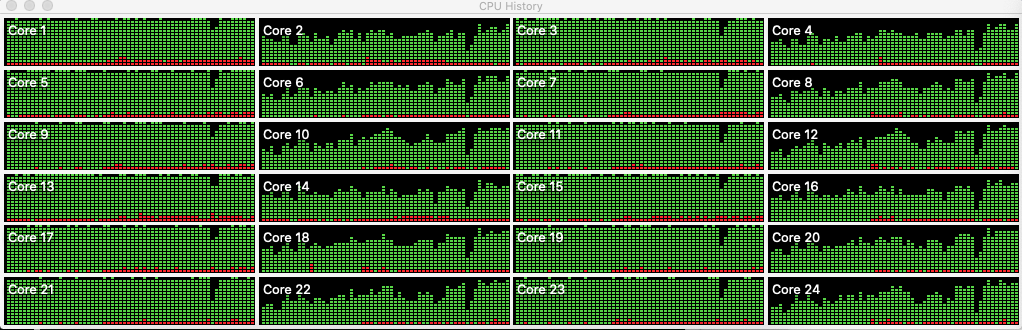

  1. One hour .mkv file. I need to convert it to .mp4. It is hammering cpu and taking forever. I looks to me like the encoding is the same in .mkv is the same as it will be in .mp4, this should be a fast process. I am blind to something here. Can you explain why this conversion is so much work for my computer?
    ffmpeg -i input.mkv -vcodec h264 -acodec aac output.mp4

    The conversion was successful but seemed like too much work for the computer.

  2. You're re-encoding the video and audio
    It should be -vcodec copy , or -c:v copy for video
