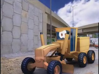

    Guys, sorry I took long to get back here. You know, I'm unemployed, the pandemic and all...
    Here's a sample of the old low res vids I have and want to improve/enhance for my portfolio. It's originally a 320 x 240 WMV.
    [Attachment 54280 - Click to enlarge]
    https://youtu.be/m6BqGcGGyus

    Post a sample of your source video. JPG is not useful

  7. Youtube has further reduced the quality of your video. Upload a sample directly to this site using the "Upload Files/ Manage attachments" below the post editing window.

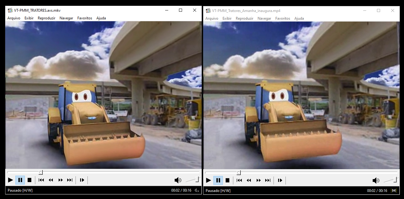

    Today I remembered I had already converted that WMV file to MP4. I played it along with jagabo's MKV and found that they have the same screen size.
    "With the naked eye" I think they show no visible differences. But the MKV has no sound and its size is a few MB bigger than the MP4's (2,94 MB versus 2,40 MB).
    [Attachment 54645 - Click to enlarge]

    Regarding the two images, the mkv video is sharper and has less compression artifacts. But you didn't show the exact same frame so that's not definitive. And even if they were showing the same frame -- you need to look at more than just one frame to say something definitive.

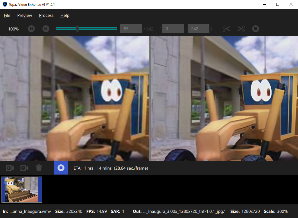

  13. Try https://topazlabs.com/video-enhance-ai/ it upscales and enhances to 4k and has trial version its not free (although personally I didn't had any satisfactory effect on home made vhs transfers) but maybe for your video will be different
    I'm trying Topaz to get a 200% enhancement for a 15" vid (same one posted before). It really seems to do a great job removing artifacts and stuff. I tried with the JPG output first, with a 300% preset.
    [Attachment 54668 - Click to enlarge]
    [Attachment 54670 - Click to enlarge]
    I hope the final output video is also great. I'll post the result here tomorrow. So far Topaz is very promising for my needs.

    Fellows, here's the result of my experience with Topaz Video Enhance AI.
    The first vid I tried was the one I posted here. It really made a better vid, with much less artifacts and stuff. But the first seconds became black, while the sound was playing. Then I tried with a second vid and all ended well this time. Now I don't know why that happened with the first vid.
    As to the program itself, and probably due to my PC specs, each of these 15~16 seconds videos took more than one hour and a half to convert. So, although it does a great job indeed, it probably will be very hard for me to convert one of my documentaries, because it's eight minutes long. I guess it will take days to complete!
