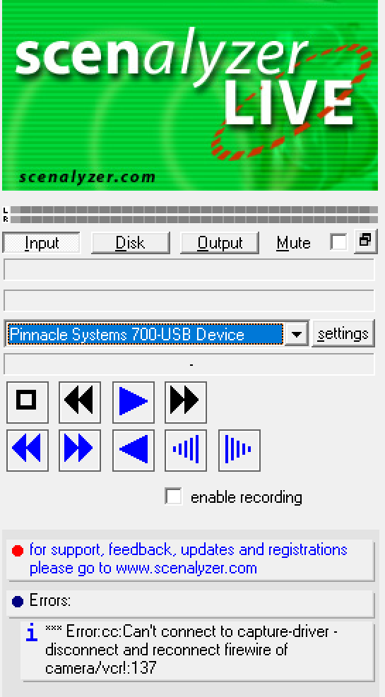

    • Pinnacle USB 700
    • Sony DCR TRV8
    • Scenalyzer Lite Software (Registered)
    • Windows 10 Surface Laptop
    • Windows Recognizes USB700 and installed some sort of drivers upon first connect.
    • Attempted to install the software that came with the 700 USB but it was too old and failed.
    • Went to Pinnacle site and installed Pinnacle Studio 23. Worked, recognized 700USB. No stream detected.
    • Pinnacle support said 23 wont work with 700 USB so I uninstalled all software.
    • Sony Camcorder Firewire out to Pinnacle
    • USB from Pinnacle into Laptop
    • Sony camera settings ETC > DISPLAY > V-OUT/LCD
    • Scenalyzer running as Administrator on Windows
    • Downloaded Scenalyzer from a thread found in these forums but date said 2006
    • Selected Capture Device in Scenalyzer is: Pinnacle 700-USB
    Upon selecting that device, Scenalyzer displays error: Error:cc:Can't connect to capture-driver - disconnect and reconnect firewire of camera/vcr!:137
    [Attachment 53772 - Click to enlarge]
    Random thoughts/questions:
    • Does DCRTRV8 support this?
    • Are my settings correct in the Sony camera?
    • Is Windows 10 really recognizing the device or do I need more software? I assume it is, as its making the "new hardware" chime when I plug it in and unplug it, and the USB700 is displayed as a device in Scenalyzer.
    • Will this only work with Pinnacle600 and if so, why not the 700?
    Thanks for any help.

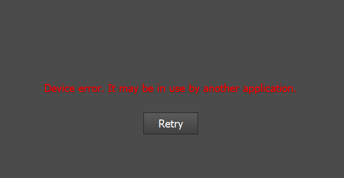

    I tried capturing using my normal software which is VideoPad Professional. It also recognized the Pinnacle 700-USB device. However it displays (maybe a generic) error: Device Error - may be in use by another application.
    I noticed there was a capture device settings option. I clicked on it and was presented with a Pinnacle Systems window. Interesting. It says driver version is 4.0.46.0 USB Mode 2.0 (High Speed).

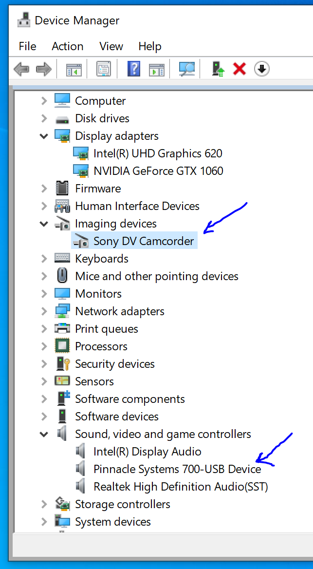

    I'm back. You were right. It was seeing the device as a USB device not a bridge. I installed your suggested Win7 drivers. End result is all the errors disappeared and it seemed ready to roll, but the viewing screen in both VideoPad and Scenalyzer don't show any video feed. It detects the device, doesn't say it has any issues, but no video feed.
    There is also a side issue in that Windows is constantly battling to replace the drivers with its own. If I unplug the device, or reboot or anything, when I plug back in, all the old errors appear because the new drivers aren't taking dominance. I then have to go into Device Manager and uninstall the device entirely then reinstall the new drivers to get back to my new baseline.
    [Attachment 53840 - Click to enlarge]
    EDIT:
    Interesting. Im actually a little shocked to see that my Device Manager is detecting my Sony Camera, which is connected only to the Pinnacle Device. That really means it should be working. I wonder if I need proper drivers for the camera? I shouldn't, right?
    EDIT 2:
    Yeah powering off the camera itself actually makes my laptop make the "removed device" sound, and turning it back on, my laptop makes the "adding new device" chime. But still no video feed, can't control start or stop, etc.

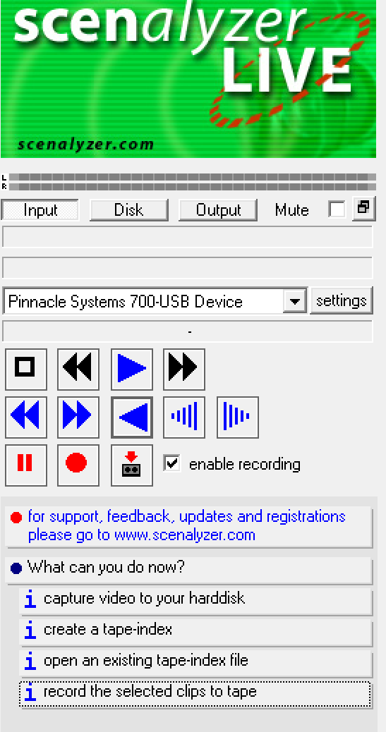

    Figured it out. I did not have "DVR and VCR Device" selected in the dropdown like you did. Noticed that on your screen caps. I had the Pinnacle 700 selected.
    This fixed it for VideoPad and im getting a video feed now there. Switching to that in Scenalyzer caused the app to crash. Ill try reopening it.
