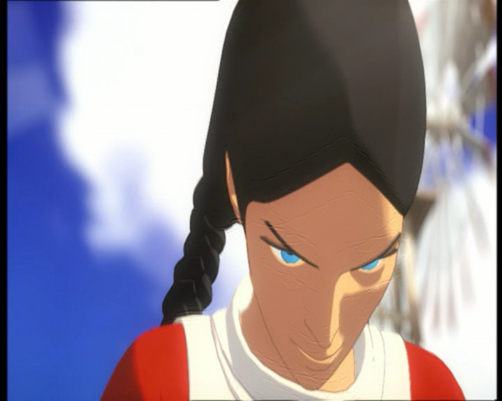

  11. I have a question regarding color: my first script uses dgindex as a source and just does qtgmc+sres and produces a frame like this:
    [Attachment 54112 - Click to enlarge]
    I tried a lossless encode with both x264 and ffv1 (ffmpeg) and when I use ffms2 as a source filter for further processing, the red color changes:
    [Attachment 54113 - Click to enlarge]
    What's happening? It doesn't look lighter/oranger like that when just playing the file in mpc-hc.
    If I add: --transfer bt470bg --colormatrix bt470bg --colorprim bt470bg
    to my x264 lossless encode it displays like the first image when I use ffms2 source. I'm not sure how to get the colors to be correct without re-encoding with those flags though.
    With the ffv1 or untagged input if I do: core.resize.Bicubic(src, matrix_in_s="470bg", transfer_in_s="470bg", primaries_in_s="470bg", matrix_s="709")
    It seems to fix it, why does the matrix need to be converted to 709 - is it because that's what my monitor/modern displays use?
  12. It sounds to me like your player is displaying the video as rec.709 when it's not flagged. Just flag it as rec.601 every time you encode.

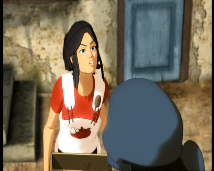

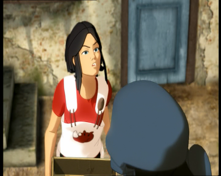

  14. MCTD isn't doing very much. I don't know if it's worth using.
    I've been playing around with one of the clips and found TNLMeans(ax=1, ay=3, az=0, h=20) almost completely removes the ghosting artifacts.
    After QTGMC().SRestore():
    [Attachment 54135 - Click to enlarge]
    Plus TNLMeans(ax=1, ay=3, az=0, h=20):
    [Attachment 54136 - Click to enlarge]
    The ghosting is almost completely gone but some other parts of the picture are blurred. It would be great if one could come up with a mask that lets you apply that result to only parts of the frame that have the ghosting. I've been playing with that but so far a solution has eluded me...
