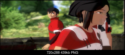

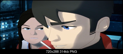

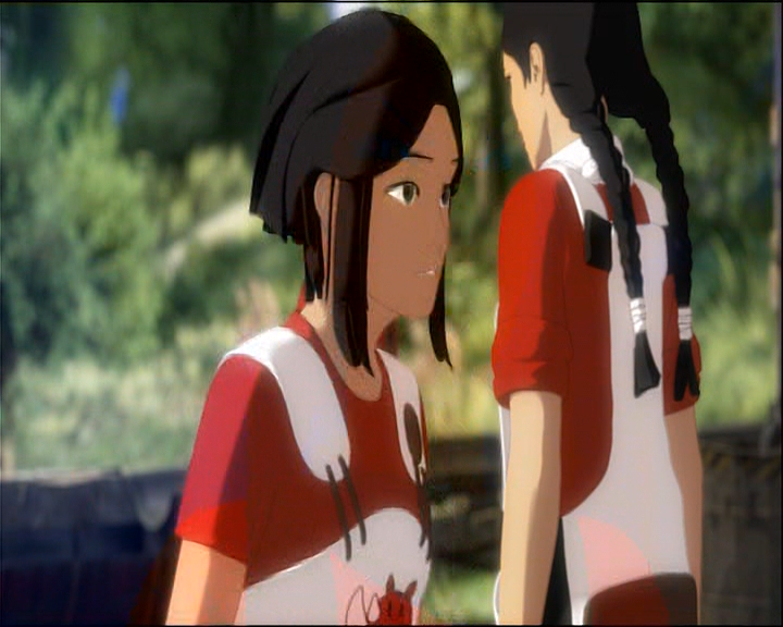

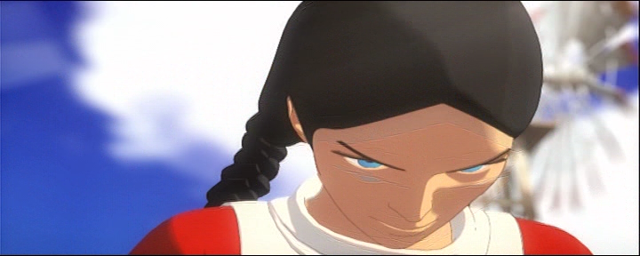

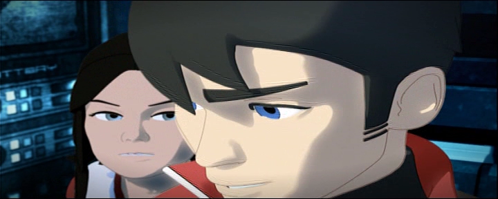

    Here are some raw fields:
    I'm not the most experienced and was wondering what I could do beyond qtgmc+srestore (and what the best settings for those 2 filters are in this case). If someone could take a look I'd appreciate it. The blending is pretty bad and I know NTSC->PAL conversions ditch 1 in 6 frames (it's not NTSC->PAL), so I can understand if it's not really rescuable. Thanks in advance, I know this stuff isn't simple and kudos to the users who frequently help users on this forum .

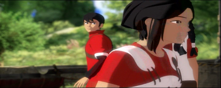

  11. Nope, don't think I'll be doing that....

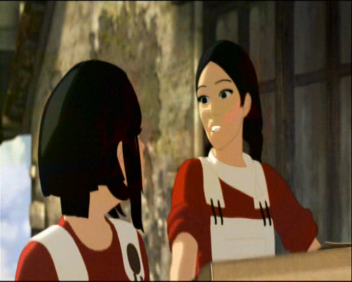

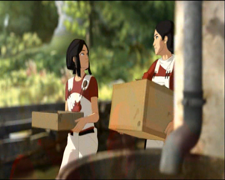

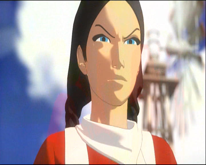

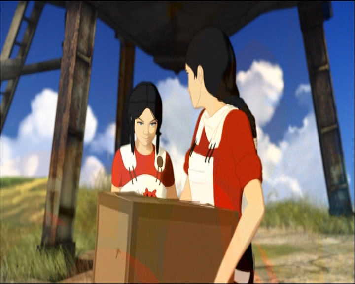

    I am hoping to be able to remove these scene change blends, well I think that's the right terminology... They seem to occur in pairs, the frame before the scene change has the next frame blended into it, and the frame that's in the new scene has the previous one blended into it. Here are 3 examples, screenshots are taken after QTGMC. Srestore with the settings i adjusted above removes both of the blends from the first case, in the other 2 it only removes the first blend, the second remains.
Name:	skyland_simple.vpy - 19198.png
Name:	skyland_simple.vpy - 19199.png
Name:	skyland_simple.vpy - 19922.png
Name:	skyland_simple.vpy - 19923.png
Name:	skyland_simple.vpy - 24264.png
Name:	skyland_simple.vpy - 24265.png
