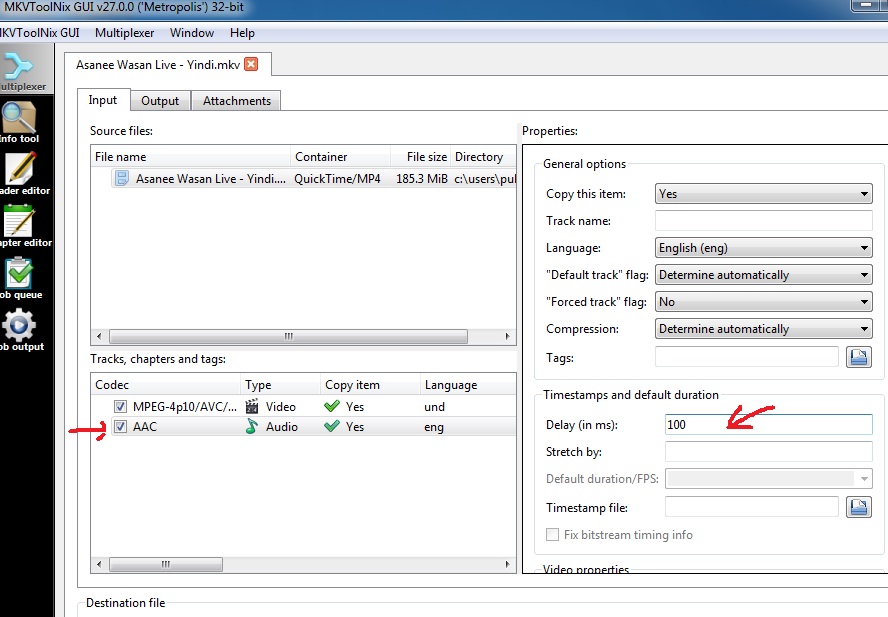

    In mpc-hc you can use the number pad - and + to alter the audio delay while the file is playing.
    Take a note of the amount when you find out where it should be.
    Then,
    In MKVtoolnix-GUI you can introduce an audio delay, either positive or negative, using the value y9u found,
    then save as a new file

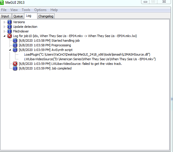

  9. This is a new problem including couple of problems. Can't understand why! Failure in getting video track.
    [Attachment 53728 - Click to enlarge]
    Mar 2008
    Post the mediainfo (text view) of the source file
