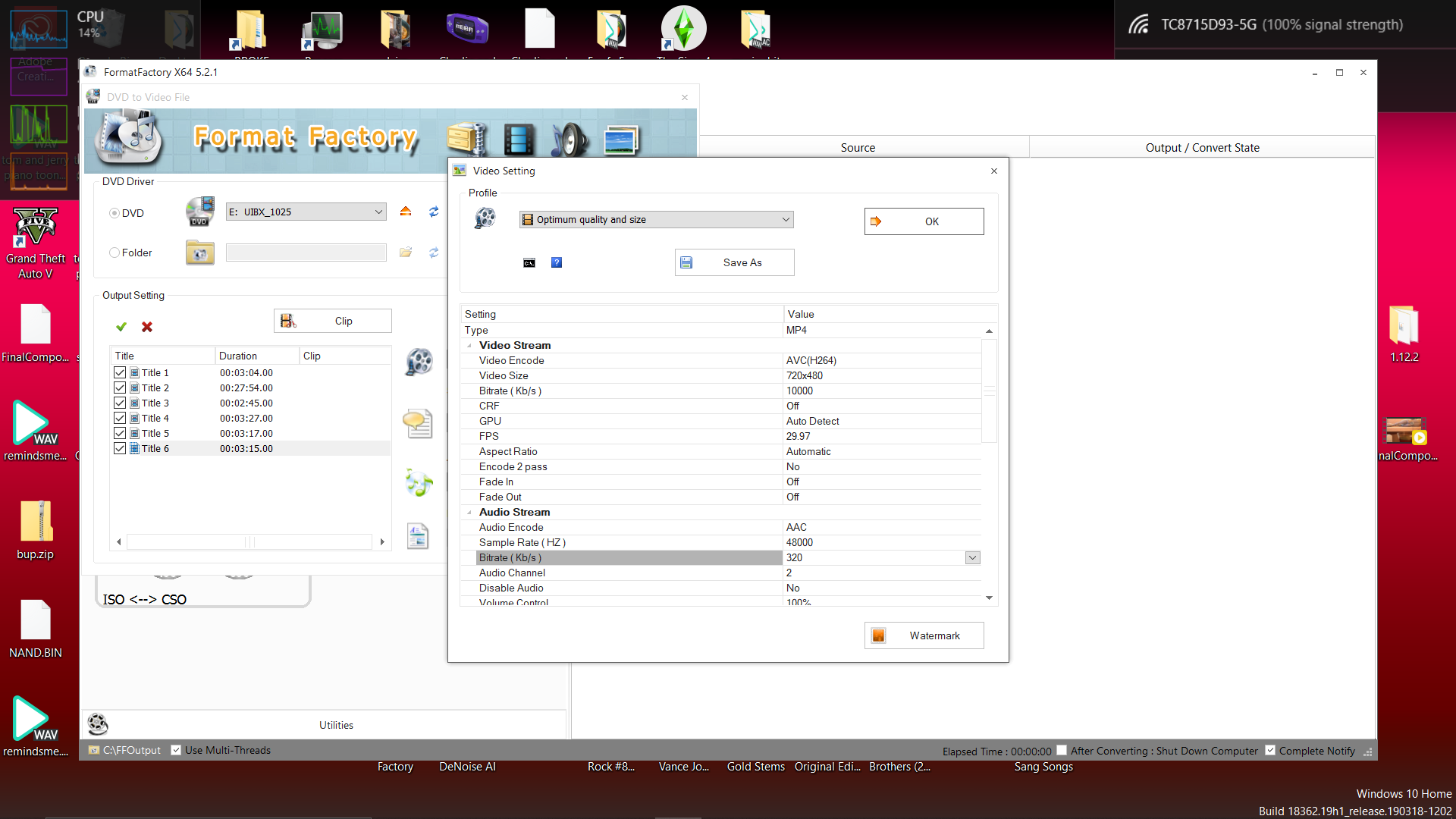

    heres the stuff i'll be ripping it at. format factory says it is 9800 for bitrate
    winx likes to downscale the output for some reason, which i why i put it a bit higher. everything else should be good.
Name:	Screenshot (208).png
    Last edited by Xyena; 4th Jun 2020 at 18:00. Reason: missing some details i'll just update it
