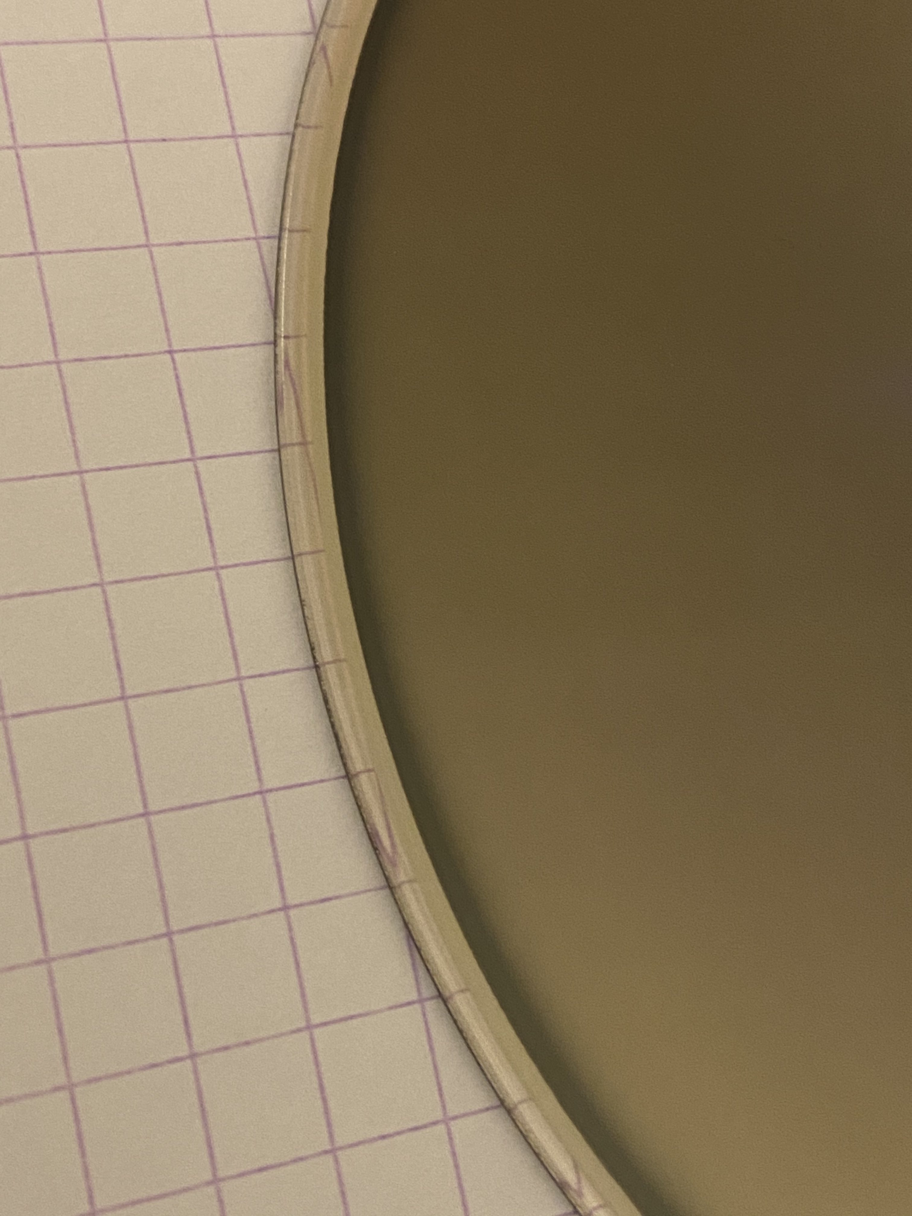

    Anyway, so I take out one of the M-DISCs, have a look at the surface, and note that it looks very odd. Of
    course I have no idea if that's normal, these being the first QL discs I have held in my hands. I am attaching
    some pics, and there are two odd details: close to the outer perimeter, they have a noticeable gradient to
    a much darker color. Hmmm... On the inner perimeter, it's even worse, there are what looks like weird
    defects -- it's hard to tell from the photos, but these are definitely _not_ scratches on the surface, but
    _inside_ the polycarbonate!

    So with some trepidation, I tried my first burn of one of these (in my trusty BE16NU50), and sure enough,
    a few seconds in, bam, write error, my first 15 € coaster... So before turning any more of these into the
    most expensive coasters ever, I thought I'd check with people here.
    Do these look that way for anyone else? Or are they extremely bad QA on Verbatim's part? Should I just not
    bother and send them all back right away? Do I have a chance of receiving better ones (assuming these are
    defective) as replacements, or should I just ask for a refund? Or should I just post an outraged review on
    amazon, uploading the pics, to warn others?

    Thanks for your response, but maybe I didn't make this clear enough: All these defects (or what look like defects to me) are visible
    on discs fresh right out of the box! They have never seen the inside of my drive, let alone been written to...
    (The photos from the M-DISC one are in fact of the coaster that I produced, and now show a fingerprint of mine, but that was only
    produced while I was taking the photos, and all these same features are identical on virgin discs.)

    Also maybe I should reiterate that none of these are on the surface of the disc -- they may look like dirt or scratches on the photos in 2D,
    but looking at them closely in three dimensions makes it very clear they are features inside the polycarbonate!
    M-Disc is overpriced crap.
    This is "normal" with low quality media. Nothing unusual here.

    Verbatim was bought out last year I think. They claimed they were not going to change anything about the production process but who knows. But yeah, as lordsmurf said, I don't buy into the M-Disc Blu-ray and their prices. I just buy the Optical Quantum 6x 25GB.
    If you are wanting long term storage, I'd just go with a basic BD-R plus a backup on a isolated HDD or a Cloud storage service. Two or more copies. Will still be cheaper than M-Discs.

    @lordsmurf and @KarMa: I hear ya regarding the M-DISC, I don't put much credence in that beyond a marketing label...
    I actually never understood what their USP was supposed to be for BD-R. For DVDs I could still imagine some advantage
    over standard organic dyes, but BD-Rs (at least HTL) are using anorganic anyway. So that's why I ordered only 5 of them
    as a sample, and 5 "normal" Verbatim, but see my second post for the apparent gigantic defects in the reflective layer on
    those... Thanks @KarMa for the note about them having been bought out, that may explain both of those (note that the
    M-DISC were also Verbatim, co-branded M-DISC).
    So yeah, the multiple copies approach on different media (optical + magnetic) is what I'm already doing, and I do test my optical
    media after a few years and if I see issues appearing with a certain brand I start copying everything on that same brand from the
    same time frame. (In fact that's what my "mixed results" with Verbatim referred to that I mentioned in the OP -- both their DVDs
    and BD-Rs have gone bad on me after much less than 5 years.)
    I just thought I'd check if anyone had seen anything like this before, because honestly I was quite shocked to get something
    that looked this shady from a supposedly well-known brand (even if my personal experience was mixed, see above).
    So I think I'll just return them with the remaining discs unopened, luckily they're indivdually shrink-wrapped jewel cases. And I'll
    drop a candid review complete with these pics on amazon (where I bought them) to warn others.
