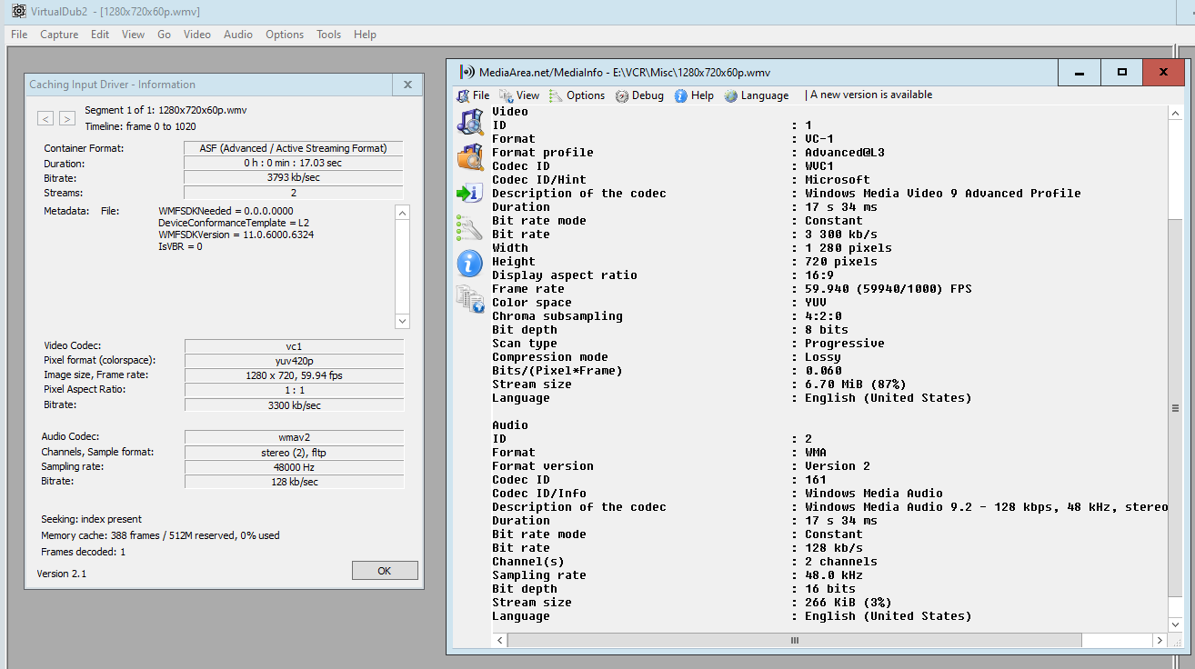

VirtualDub2 has the ability to read and decompress WMA v2 and includes the ffmpeg lame mp3 encoder. It also has no problems with AAC LC. Not sure about AAC HC.
[Attachment 53637 - Click to enlarge]
The older versions of VirtualDub (non-2) would not read WMV files at all without a third party plugin. The original author was threatened with a lawsuit by Microsoft long ago when he first introduced WMV support. So he removed it and, for as long as he maintained the program, never added it back.Last edited by jagabo; 2nd Jun 2020 at 08:12.

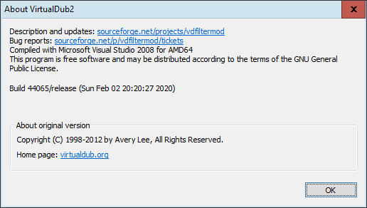

Importing that way works for me. The version I'm using:
[Attachment 53640 - Click to enlarge]
If you want to make your file available I'll try it here. Here's the WMV file I was testing with. -

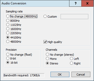

Audio conversion and compression worked for me with these settings:
[Attachment 53642 - Click to enlarge] -

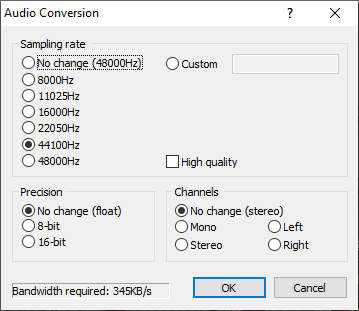

Good point. Converting to 16-bit works but with "no change", it does not:
[Attachment 53643 - Click to enlarge]
Strangely, it seems that the original audio Stream is already encoded in 16-bit. -
