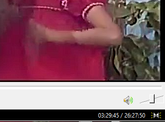

    I burned a dvd with DVDStyler and it recorded with no errors. But when I was going to play it, it didn't load in my DVD player nor in my PC. I opened the .VOB files manually and it said the duration them was 26 hours!?Name:  foro.PNG

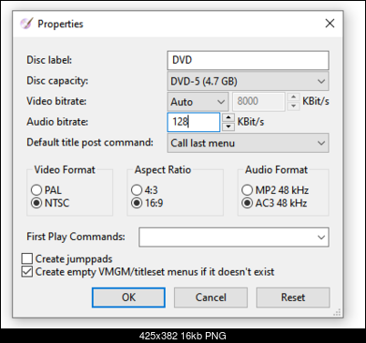

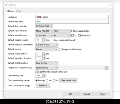

    These are the settings btw. Click image for larger version
ID:	53565Click image for larger version

    How many vobs ? 4 and half hours 971 mb (ok that may be the source) But you will still struggle to put that much on a single-layer disk.
    Change the 'auto' to 2 Mbit/s (which is approx. what you need for 4 + hours.) and watch the quality dive. But it may now create the disk.

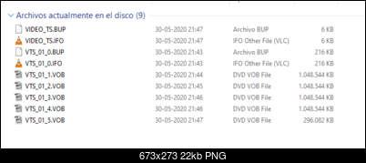

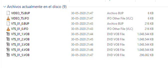

    This is the structure Click image for larger version
    The program determined that it needed 2 Mb/s so that is correct.
    Recorded the disk again and same result
    The source is youtube downloaded videos (bitrate ~600 kb/s, 360p). I've burnt another DVD with different videos and less bitrate and it played fine.

    According to the file list you did not create a menu. Is that the case ? If not then look closer at menu creation properties.
    But rather than burn disks just create the files and test with vlc
    I didn't create a menu.
