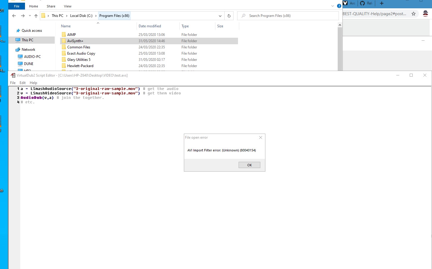

    Apr 2010
    London
    hi thanks for the help

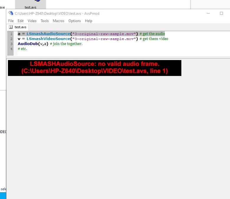

    followed what you said but getting an errImage
    [Attachment 53603 - Click to enlarge]
    or ??
    [Attachment 53605 - Click to enlarge]
    ERRORS ERRORS everywhere nothing working ,,,,,,,
    [Attachment 53607 - Click to enlarge]
  21. LSmashAudioSource() usually works. But I just checked and it doesn't like the audio in your small sample either. You can use LWlibavAudioSource() instead:
    a = LWlibavAudioSource("3.mov") # get the audio
    v = LWlibavVideoSource("3.mov") # get them video
    AudioDub(v,a) # join the together.

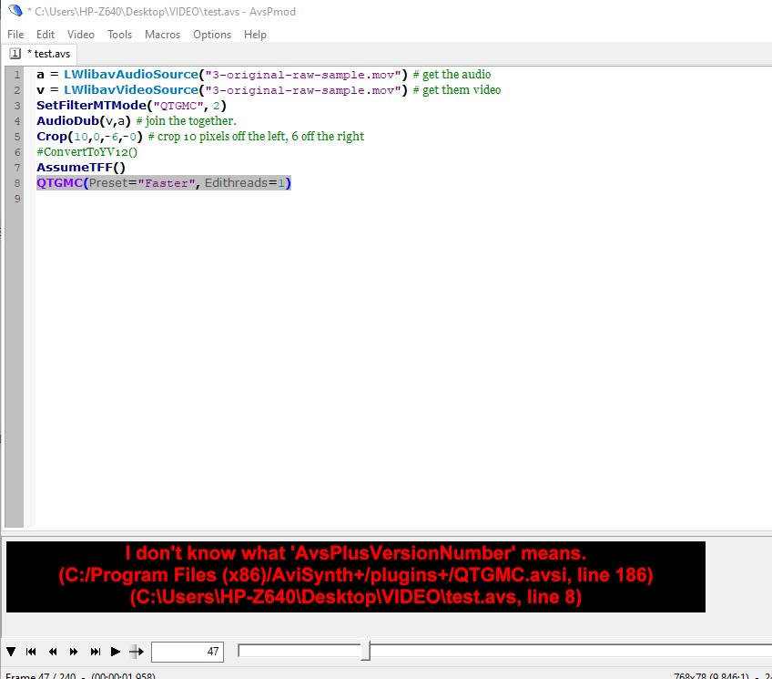

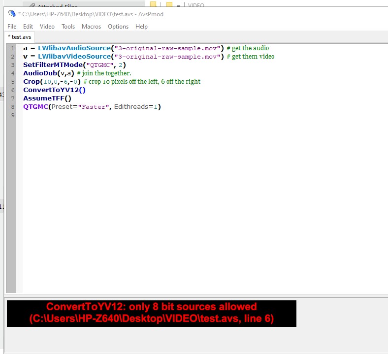

  23. Member
    Apr 2010
    London
    Hi Guys
    Thanks for any help in advance

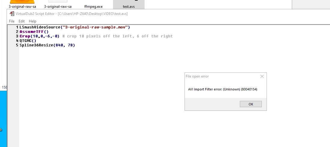

    ok this is where I am at in AvsPmod, I am using the play bar at the bottom and dragging to see if I can view my clip, If I can i'm assuming that the entered commands are working?
    which they are not at the moment
    also don't seem to be getting any audio either ???
    I have been using max audio when capturing set to 24bit
    think in future I will capture audio at 16bit, as I feel this is more standard for VHS HIFI stereo capture and maybe some of the programs / plugins
    Also can not seem to get the 64bit plugins working ??
    I have copied all the various plugins x86 32bit to C:\Program Files (x86)\AviSynth+\plugins+
    I have also copied all the various plugins 64bit to C:\Program Files (x86)\AviSynth+\plugins64+
    but do not feel the 64bit is working ???
    a = LWlibavAudioSource("3-original-raw-sample.mov") # get the audio
    v = LWlibavVideoSource("3-original-raw-sample.mov") # get them video
    SetFilterMTMode("QTGMC", 2)
    Crop(10,0,-6,-0) # crop 10 pixels off the left, 6 off the right
    #ConvertToYV12()
    AssumeTFF()
    QTGMC(Preset="Faster", Edithreads=1)
    Having issues using #ConvertToYV12() as this only works with 8bit ???
    so have discarded this command

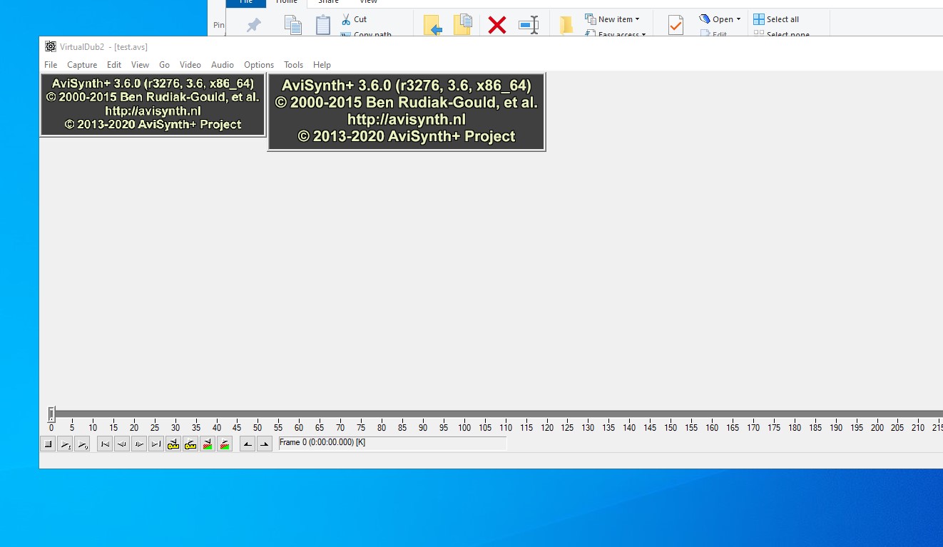

    [Attachment 53611 - Click to enlarge]
    Now when I try to use QTGMC with or without additional presets I get this STRANGE ERROR
    I don't know what 'AvsPlusVersionNumber' means ????
    [Attachment 53612 - Click to enlarge]
    Can anybody please shine any light please
    Thank you

    C:\Program Files (x86)\AviSynth+\plugins+\ImageSeq.dll [2020-05-20]
    C:\Program Files (x86)\AviSynth+\plugins+\LSMASHSource.dll [2020-05-31]
    C:\Program Files (x86)\AviSynth+\plugins+\masktools2.dll [2.2.23.0]
    C:\Program Files (x86)\AviSynth+\plugins+\mvtools2.dll [2.7.42.0]
    C:\Program Files (x86)\AviSynth+\plugins+\nnedi3.dll [0.9.4.55]
    C:\Program Files (x86)\AviSynth+\plugins+\RgTools.dll [1.0.0.0]
    C:\Program Files (x86)\AviSynth+\plugins+\Shibatch.dll [2020-05-20]
    C:\Program Files (x86)\AviSynth+\plugins+\TimeStretch.dll [2020-05-20]
    C:\Program Files (x86)\AviSynth+\plugins+\VDubFilter.dll [2020-05-20]
    [Scripts (AVSI)]
    C:\Program Files (x86)\AviSynth+\plugins+\colors_rgb.avsi [2020-05-20]
    C:\Program Files (x86)\AviSynth+\plugins+\QTGMC.avsi [2020-05-30]
    [Uncategorized files]
    C:\Program Files (x86)\AviSynth+\plugins+\colors_rgb.txt [2020-05-20]
    64bit info
    Cannot load avisynth.dll
    Dependencies that could not be loaded:
    VCRUNTIME140_1.dll
  24. Capturing Memories dellsam34's Avatar
    Jan 2016
    The hurdle is installing all the required plugins, Once that done everything else is easy, The best way is to open up a new thread for QTGMC and one for FFMPEG in the video conversion section, There are a lot of people there that are knowledgeable and they don't hangout in the capturing section. Just be patient and attach error messages to the posts, it's a steep learning curve but you will get thru it.
  25. One of the 64 bit plugins needs the Microsoft Visual C Runtime package. I think 140 is the 2015 version:
    https://www.microsoft.com/en-us/download/details.aspx?id=52685

  27. Don't be surprised if you find a few more issues like this before it starts working.

  29. Member
    Apr 2010
    London
    HI Guys
    Happy Days are here again
    ok after much much playing around in win 10 I have managed to get the 64 bit version of AVISynth in and running in VUDUB2
    with the very basic script
    #a = LWlibavAudioSource("3-original-raw-sample.mov") # get the audio
    #v = LWlibavVideoSource("3-original-raw-sample.mov") # get them video
    #AudioDub(v,a) # join the together.
    #Crop(10,0,-6,-0) # crop 10 pixels off the left, 6 off the right
    #ConvertToYV12()
    #AssumeTFF()
    #QTGMC(Preset="Faster")
    #AudioDub(v,a) # join them together.
    Version()
    VERSION()
    this is what I get in the 64bit version of VUDUB2 when I drag the script (VERSION) over VUDUB2
    [Attachment 53697 - Click to enlarge]
    getting back now to the job in hand which is perfect / pristine .... conversion / delinterlacing / cropping etc
    of my horrible captured VHS Raw video in to lovely 50 fps De-Interlaced / ReSized (4:3 Aspect Ratio) / Black levels Rectified
    would someone please be kind enough to give me an idea of what script I should be running to do all of the above
    Since reinstalling the AVIsynth
    I have added all the plugins QTGMC / LMSMASH etc
    to get this code working
    #ConvertToYV12(interlaced=true)
    AssumeTFF()
    #Version()
    the only error is ConvertToYV12()
    it complains it only works with 8bit video
    So is there a 10bit solution for ConvertToYV
    and the aim is to convert to 50fps deinterlaced at the VERY VERY best quality I can achieve from my 10bit captured video
    File size is not important also would like the best audio quality too guess this will be 360Kps mp3
    What other lines of script/plugins should I be adding for the ultimate quality conversion
    and how do you convert using the scrip ? is this done in VUDUB2 or is VUDUB2 just a viewer / player
    Thank you in advance for any help
