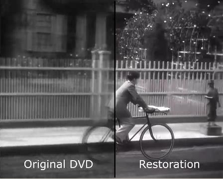

    If anyone would care to take a gander...here are 2 links...
    The first one offers some split screen before and after shots of the project:
    https://youtu.be/7T2GDJNCVK4
    The second one is a link to the completed film (and also generically explains what I did):
    https://youtu.be/vvrUyt0MEG4
    Constructive criticism is always welcomed. This was my first attempt at such a project, and I look forward to learning more and discovering new challenges ahead.
    Thanks again!
    --Joey

  4. Originally Posted by Joey Bagodonuts View Post
    I used Hybrid to do the deinterlacing (Vapoursynth)...
    Why did it need deinterlacing? Do you have a sample from the source DVD?
    Why 50fps? The frame interpolation looks godawful horrible. Every interpolated frame during movement shows blending. You didn't notice that?
    I'd have slowed it to film speed so the video would be at the correct speed and audio at the correct pitch.

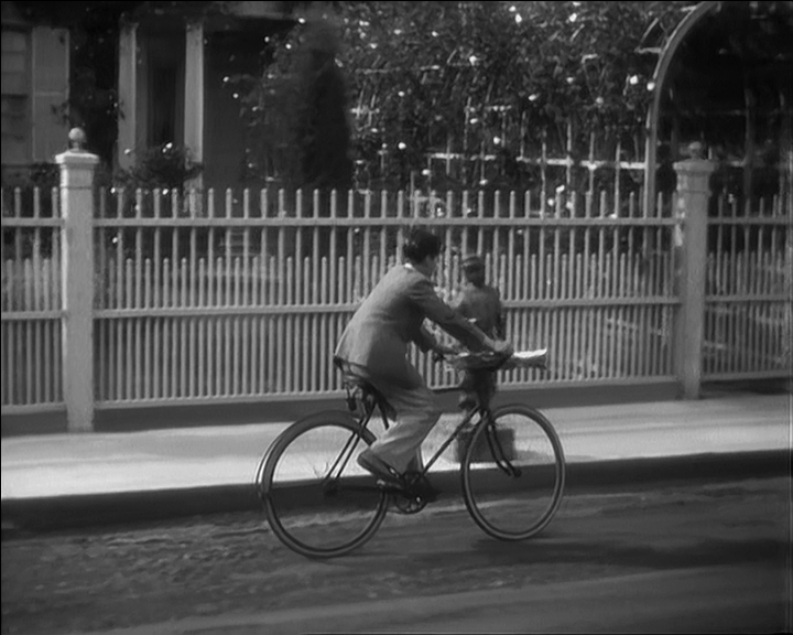

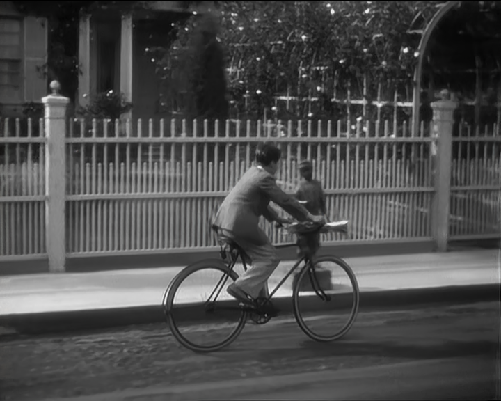

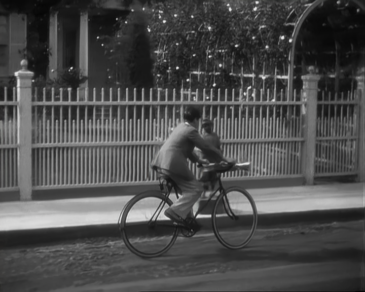

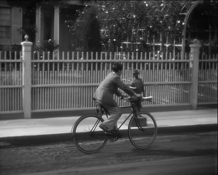

    Here are 6 frames from the final rendering in a shot that has more movement than anywhere else in the film. Which are the interpolated ones, and where is the blending?
    Thanks!

  7. Originally Posted by Joey Bagodonuts View Post
    The audio was rendered completely independent of the video and audio is my specialty. It's speed and pitch are perfect.
    It depends on what you mean by "perfect." What manono was referring to is that film was shot at 24 fps. For PAL countries, the way film is shown is to simply speed it up slightly to 25 fps, and let the audio pitch go up slightly (some producers do the pitch adjustment, now that this can be done easily). If your DVD was a 25 fps PAL DVD, or if it went through the process of being 25 fps, then the pitch on the DVD, compared to the audio on the original film, would be wrong and, if you actually didn't do anything to correct that pitch, it would not be the same as the original film, and therefore would not be "perfect."

  9. Originally Posted by Joey Bagodonuts View Post
    It's 25fps. How can it be perfect? And how do you know it's pitch corrected? They almost always aren't.
    However, I owe you an apology about the interpolation accusation. Apparently, I was only looking at the source. Picture below. But why is it like that? How was it 'deinterlaced'? Do you know? Do you have a sample from the original DVD?
    I was also surprised at the gain in clarity and sharpness. Now I think the source was made significantly worse so, in comparison, the restoration looks better.

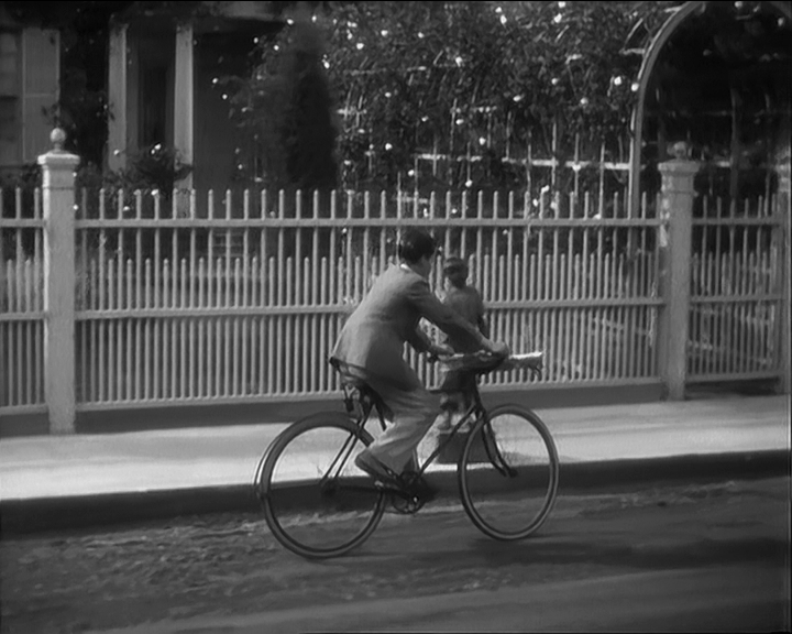

  11. Originally Posted by Joey Bagodonuts View Post
    I deinterlaced it in Hybrid using Vaporsynth / QTGMC, Top field first.!
    QTGMC doesn't create blends like that unless you have a field-blended conversion. Which you don't. In the 480p version, all "Original DVD" frames are blended. What I suspect is that you have a field-shifted source which can be fixed with a simple TFM. Instead you bobbed it? But, for the third time, something cut from the source - perhaps the guy on his bike for a few seconds - will tell the tale.
    Also, the whites are often blown out. Even the blacks are crushed in places, especially during the fades and the black columns on the sides (why add the black columns?). If you were to put on:
    ColorYUV(Analyze=True).Limiter(Show="Luma")
    You'd get something like the below picture (green marks blown out whites, red the crushed blacks). Apparently, you added the black bars before messing with the brightness and contrast. The text doesn't much matter.

  14. Originally Posted by manono View Post
    I did not Bob it. I selected "Even," and de-selected Bob....
    If you can recommend a piece of software that will cut the VOB file in that spot, I will post tomorrow.
    I did not add the black columns....I simply rendered the frames within a 1920x1080 format. I don't have any specific reason why I did that...perhaps I thought it would just be more YouTube firendly that way.But I agree...I could not get the Blacks and Whites to my satisfaction with my limited knowledge.

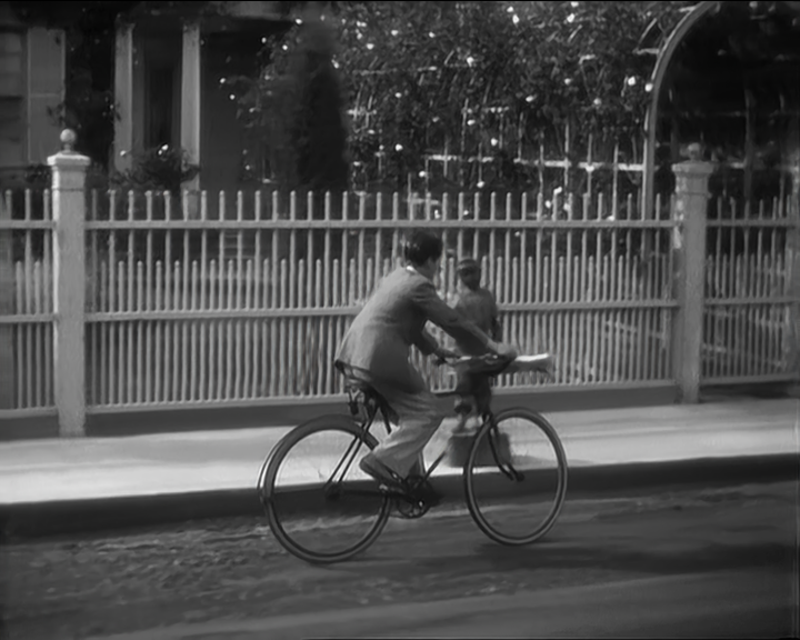

  15. Originally Posted by johnmeyer View Post
    I can state with absolute certainty that no motion interpolation was used.
    Take a look at my first picture. Look in front of the bike. You'll see the fence is dissolved into a blur. Something was done to it. Was it just QTGMC? Maybe it was in the source? But the fence is broken in lots of places. I'll include a pic.
    It's pretty easy to do because the 25/24, while close to a semitone, is not going to produce notes that are perfectly "on-key."
    Maybe you can explain to me why not. The software can't adjust by the correct amount?
    The real problem is the blending that was in the original...
    My contention is there's no blending in the source. But we'll need a sample to know one way or the other.
    That is interesting...because if you look at the frames I posted above those artifacts (the blending) are not present. Maybe I botched the encoding?
  18. The 2 pics I took aren't any of the frame pictures you included. But those aren't blends in that first pic. Blurring, I think. Maybe YouTube's reencoding of the restoration demo did it.

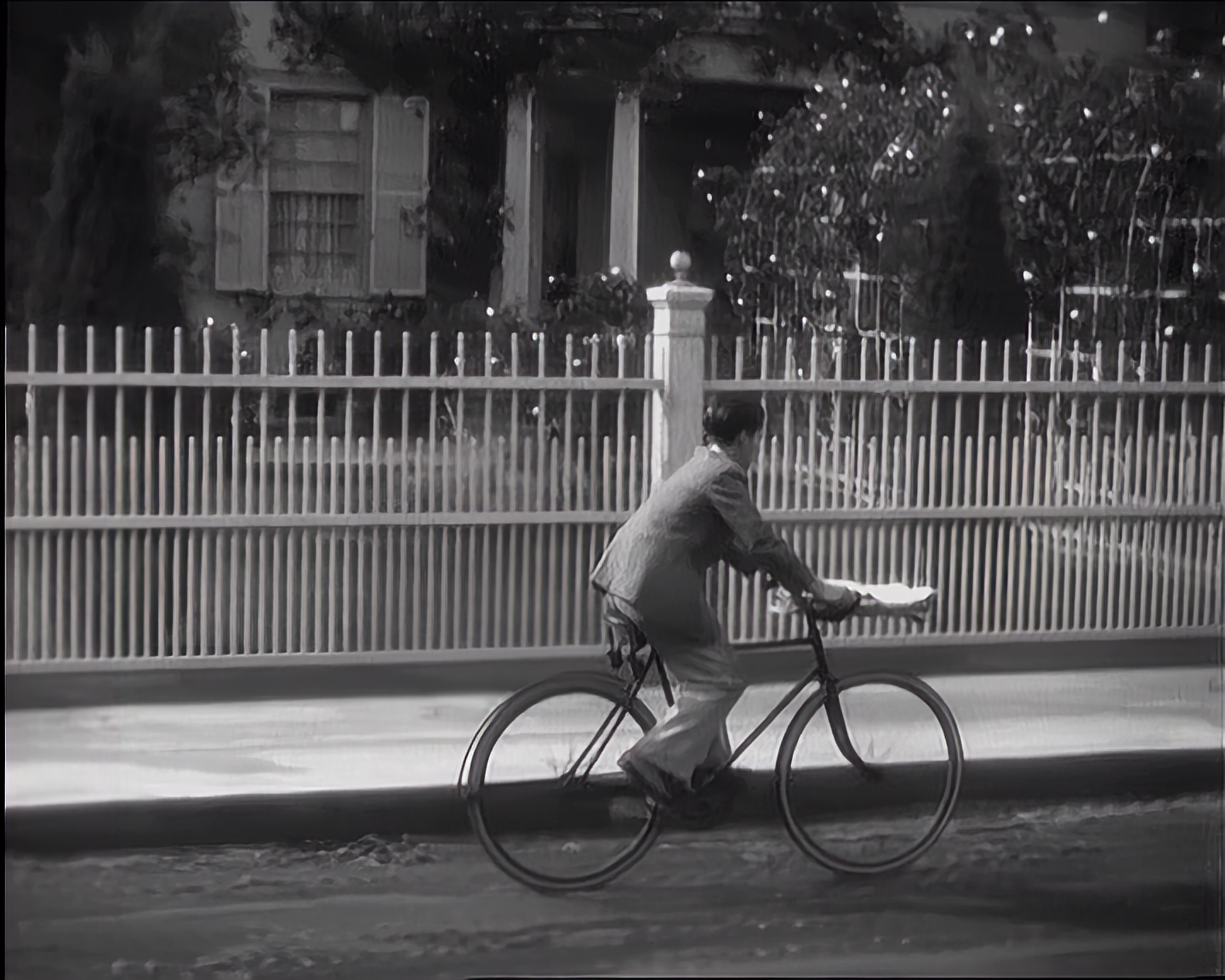

  28. OK -
    Here is the Picket Fence shot directly from the DVD....
  29. Finally...here are the 2 frames that resemble most closely the frame that monono referenced above with that funky picket fence issue. I don't see the same from the individual frames here...so I either botched up the final render, or it's a YouTube thing....
    [Attachment 53539 - Click to enlarge]
    [Attachment 53540 - Click to enlarge]
  30. The original is 25p content; it's just "out of phase" . You can use TFM to match the fields .
    It looks like the "original" comparison on YT used frame blending for the 25p=>50p conversion (ConvertFPS in avsiynth would cause blending, ChangeFPS would use duplicates; or the "default" setting in most NLE's would be frame blending too) . But likely that's what the problem is on youtube with the "original" side
    Those two are from the "original" frames . The frame inbetween those two should have those interpolation (edge morphing artifact) errors.
