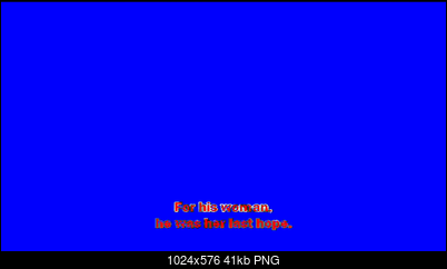

    This is a snapshot after remuxing with Muxman:

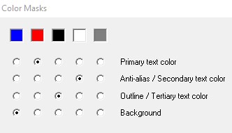

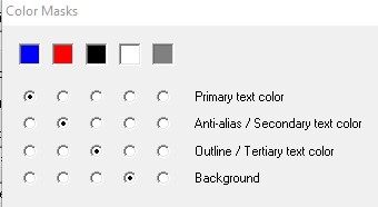

    Incidentally, I noticed that after installation the Color Mask is
    Whereas the Default Color Mask is
    But whatever the Color Mask, the result was the same.

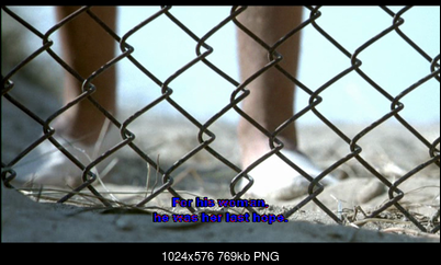

    Then I tried the old version 2.6.0.0 of MaestroSBT
    Unfortunately, although the version I downloaded from here says Unicode, it doesn't recognize certain characters like ♫
    So I made a new ANSI ssa file, with # instead of ♫
    The result in the remuxed DVD: no transparency issue

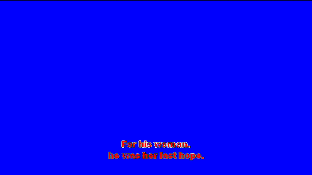

    So I decided to get the 2.6.2.1 ANSI version of MaestroSBT and used the same ANSI ssa file,
    Unfortunately the result was the same as before
    There seems to be a bug in the 2.6.2.1 version
    it's no big deal as it can be corrected easily at the same time as the colors
    However has anyone experienced the same issue?

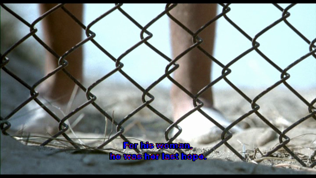

    May 2007
    Good news!
    I kept investigating and found the problem and the solution
    For some reason, there are two errors in the SST file
    1) The contrast is inverted
    Instead of (0 15 15 15) it should be (15 15 15 0)
    2) The colors are different the ones chosen in MaestroSBT
    For instance, if the default Color Mask was chosen, i.e.
    Primary Text Color: Blue
    Anti-Alias: Red
    Outline: Black
    Background: White
    Then the color scheme in the SST file will be
    PA (255 255 255 - - - ) White
    E1 (0 0 255 - - - ) Blue
    E2 (0 0 0 - - - ) Black
    BG (255 0 0 - - - ) Red
    Therefore in order to fix the transparency issue, two modifications in the SST file are necessary:
    1) The contrast needs to be corrected
    2) The colors must match the ones chosen in MaestroSBT
    Of course it is still necessary to fix the colors in DVDSubEdit
    HTH
