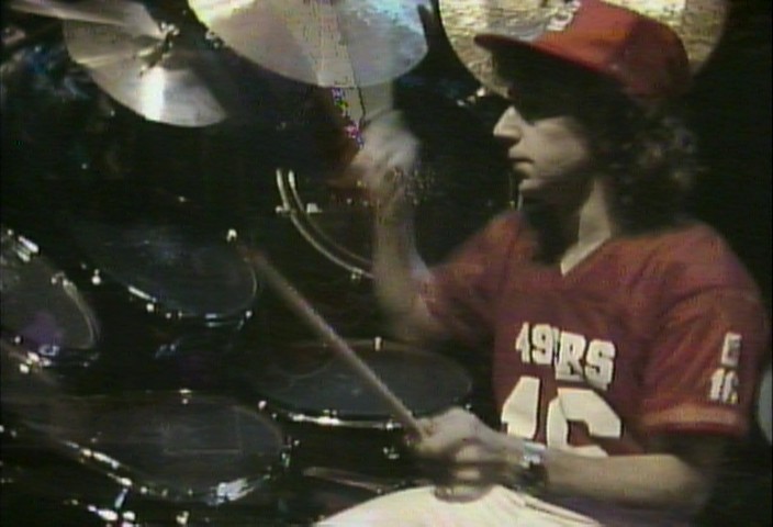

  11. Where are these gross distortions coming from (the drumstick at the top of the frame)?
    [Attachment 53484 - Click to enlarge]
    They appear any time there are large motions. I doubt that's what's on the laserdisc. Turn of any noise filtering in the capture device or software. See if the distortions go away.
    Jun 2011
    There isn't any filtering. Black Magic Design Intensity Pro video capture card. All settings are at default. NTSC Using composite video connection on a Pioneer LD-S9. Built in comb filter is on default setting. What I'm not sure of is since this concert was shot in the UK, but the laserdisc is NTSC, is there some kind of PAL to NTSC conversion done on the laserdisc master.
  13. The video probably did go through a PAL to NTSC conversion but those artifacts are beyond what you get from that. And being laserdisc puts it in the analog age. Those artifacts are definitely digital.
    Do you see similar artifacts if you capture some other laserdisc with your current setup?
    Jun 2011
    I am using a higher end consumer card (Intensity Pro) which is an internal card that captures lossless AVI. Using a YUV 8 bit setting. There are no dropped frames. Computer is old but is an i7. Drive is Samsung 500GB SATA SSD. The laserdisc player is connected directly to the card, no other gear in between to affect the video.
