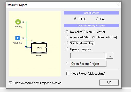

I tried without the captions, but got the exact same error. It must have something to do with the video or audio file, or the process I'm carrying out. Also, I am not using an empty or blank menu; I selected the option "Movie Only."

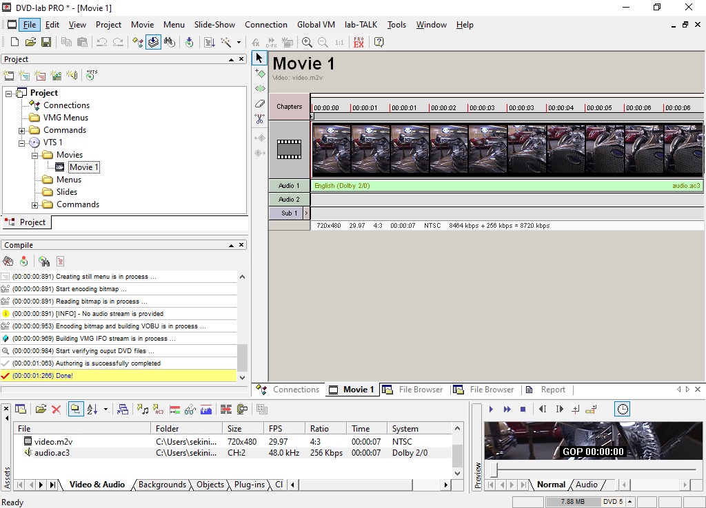

with the samples of _Al_ .. I compile without error in windows 10 ..
[Attachment 53467 - Click to enlarge]
Code:*** DVD Lab Pro Verification Log *** 5 - 24 - 2020 -- 7:24:6 ************************ * * * VMG Verification * * * ************************ Number of VTS - 1 Number of Menus: 1 Menu 01 - Type - Dummy Number of imported VTS: 0 ************************ * * * VTS Verification * * * ************************ <<< VTS Number 1 >>> Number of Titles: 1 Title 01 - Type - ES or PES Segment 1, Video File C:\Users\sekininsha\Desktop\m2v and ac3\video.m2v Frame Size: 720 X 480 Frame Rate 4 [1--23.976, 2--24, 4--29.97, 3--25, 5--30] Aspect Ratio: 43 [43--4:3, 169--16:9] MPEG Video Type: 2 [1--MPEG 1, 2--MPEG 2] Chroma: 1 [1--4:2:0, 2--4:2:2, 3--4:4:4] GOP 1, size - 499558 GOP 2, size - 210007 GOP 3, size - 515022 Segment 1, Audio File C:\Users\sekininsha\Desktop\m2v and ac3\audio.ac3 Audio type: AC3_Mot, Channel: 2, Sampling: 48000, Bitrate: 256000 Segment 1, Subtitle File : None Number of Menus: 1 Menu 01 - Type - Dummy ************************ * * * Status Messages * * * ************************ Start building Video Title Set ( VTS ) ... - 2001 Title - 1 Start building VOB streams - 2210 Muxing elementary streams is in process ... - 2220 Initializing audio packets ... - 3005 Initializing AC3 (MOT) audio packet ... - 3030 [INFO] - No subtitle stream is provided - 3739 Verifying Closed Caption file is in process ... - 3750 Muxing is in process ... - 2300 Audio packetizing ends - 3025 Creating PGC for the title is in process ... - 2500 Creating dummy menu is in process ... - 2790 Building VTS IFO stream is in process ... - 2800 Start building Video Manager (VMG) ... - 2005 Creating dummy menu is in process ... - 2790 Creating still menu is in process ... - 2700 Start encoding bitmap ... - 2750 Reading bitmap is in process ... - 2740 [INFO] - No audio stream is provided - 3019 Encoding bitmap and building VOBU is in process ... - 2450 Building VMG IFO stream is in process ... - 2850 *** Post Verification *** No error was found in the post verification process Authoring is successfully completed - 3900責任者-MDX -
Which kinda proves my theory about the specific Win10 installation of the OP (or something else beyond our comprehension has influenced that installation)
So, again, to the OP , think back what you have installed - something that promised the earth. But un-installing that may not solve your problem. Only a full re-install with a HDD format might solve that. -

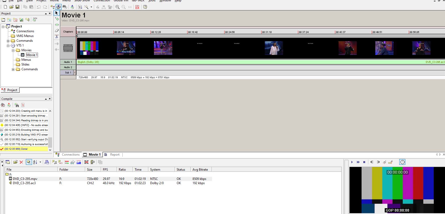

Hello, everyone.
It turns out there was something wrong with the file I had downloaded. I tried reinstalling and didn't work, tried with another computer running Win10 and still the same error, which is why I downloaded it again. I wouldn't have imagined this was the problem without all your suggestions. Now it worked with Al's files and my file, at least the compilation without the mentioned error.
[Attachment 53480 - Click to enlarge]
Now, on to the next part. A final question, the verification log says "Number of menus: 1." Why? I chose "Movie Only."Code:*** DVD Lab Pro Verification Log *** 5 - 24 - 2020 -- 16:51:28 ************************ * * * VMG Verification * * * ************************ Number of VTS - 1 Number of Menus: 1 Menu 01 - Type - Dummy Number of imported VTS: 0 ************************ * * * VTS Verification * * * ************************ <<< VTS Number 1 >>> Number of Titles: 1 Title 01 - Type - ES or PES Segment 1, Video File F:\DVD_C3-295.mpv Frame Size: 720 X 480 Frame Rate 4 [1--23.976, 2--24, 4--29.97, 3--25, 5--30] Aspect Ratio: 169 [43--4:3, 169--16:9] MPEG Video Type: 2 [1--MPEG 1, 2--MPEG 2] Chroma: 1 [1--4:2:0, 2--4:2:2, 3--4:4:4] GOP 1, size - 362924 GOP 2, size - 425424 GOP 3, size - 413794 Segment 1, Audio File F:\DVD_C3-295.ac3 Audio type: AC3_Mot, Channel: 2, Sampling: 48000, Bitrate: 192000 Segment 1, Subtitle File : None Number of Menus: 1 Menu 01 - Type - Dummy ************************ * * * Status Messages * * * ************************ Start building Video Title Set ( VTS ) ... - 2001 Title - 1 Start building VOB streams - 2210 Muxing elementary streams is in process ... - 2220 Initializing audio packets ... - 3005 Initializing AC3 (MOT) audio packet ... - 3030 [INFO] - No subtitle stream is provided - 3739 Verifying Closed Caption file is in process ... - 3750 Caption file header is confirmed - 3760 Muxing is in process ... - 2300 Audio packetizing ends - 3025 Creating PGC for the title is in process ... - 2500 Creating dummy menu is in process ... - 2790 Building VTS IFO stream is in process ... - 2800 Start building Video Manager (VMG) ... - 2005 Creating dummy menu is in process ... - 2790 Creating still menu is in process ... - 2700 Start encoding bitmap ... - 2750 Reading bitmap is in process ... - 2740 [INFO] - No audio stream is provided - 3019 Encoding bitmap and building VOBU is in process ... - 2450 Building VMG IFO stream is in process ... - 2850 *** Post Verification *** No error was found in the post verification process Authoring is successfully completed - 3900 -
It's a dummy menu. AFAIK the dvd spec must have the relevant files (see 'What is A DVD' top of this page) for a menu even if the player essentially ignores them or rather acts on the commands in the .ifo and proceeds to the movie.
That "menu" is a dummy PGC. It means it contains just some VM commands but no video or audio. That is how DVD navigation can work and also DVD structure is designed by "abstract layer" as they call it - a code designed by DVD Lab author that builds up DVD structure. So you can have some redundant things in a code, but navigation at the end just works of course. For example if you have a tool where you could design DVD navigation from scratch you might do things, navigation differently. Also DVD navigation has a thing called first play pgc so dvd navigation jumps from that PGC to some general code setting up VMGM (menu, which is dummy) and then to a title (PGC that contains video). In short DVD navigation could be done in thousand of ways.
