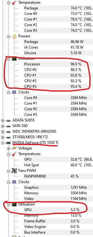

    A quick question to those who uses TMPGenc programs (I like them very much, Smart Renderer in particular). I have a computer with i7-4790 and GTX 1050Ti. I for sure have checked "use Nividia for decoding" but when monitoring with CPUID, I can see that the program uses almost 100% of all CPU cores, and only a few % of the GPU. Thus it takes a long time on any decoding.
    Anything I am missing here?
    Thanks in advance.
    Thanks in advance.
    Most likely explanation is that the majority of that CPU% is consumed by CPU Encoding, not Decoding . The bottleneck is usually CPU encoding, not decoding
    Decoding takes very little CPU% for most formats , maybe a few % . Certainly not 90-95%. So offloading the that small decoding task to GPU will not gain much speed in terms of final output speed

    poisondeathray, thank you for the prompt reply.
    I did type too fast. It should have been "use Nividia for H.264/H.265 ENCODING".
    The snap shot above is the final output ENCODING phrase after editing.
    I thought the GPU for sure is suppose to take some load off the CPU and make encoding faster.
    Any insights?
    Any insights?
    I personally don't use the "use Nvidia" for encoding. I personally find my encoding times faster without it. What encoding exactly are you getting?
    Nov 2004
    Canada
    In Smart Renderer, most of the times "Master" clips are only re-encoded at the trimming/joining points. The rest are all straight copying, when outputting, so it is very fast.
    There are times when mixed with some "Rescue" clips that must be totally re-encoded. I found this process is almost like real time; meaning a 1 hour file would take 1 hour to re-encode.
    That's why I asked why it makes no differences whether I choose to use Nvidia or not. I thought the GPU is suppose to help it faster in the encoding process.

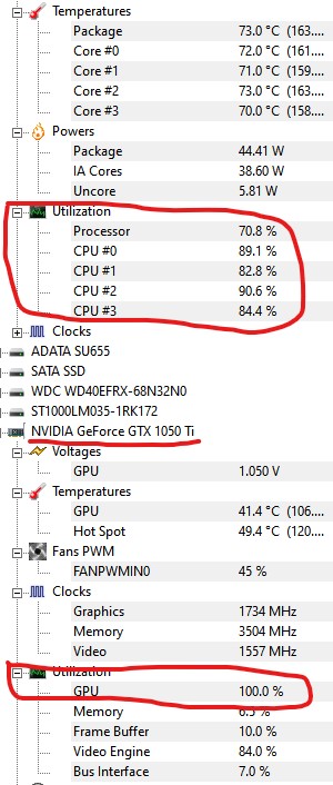

    For comparison, this image shows the same file re-encoding by AVC Any Video Converter.
    This program uses the GPU 100%, and re-encodes the same file in 1/10 of the time.
