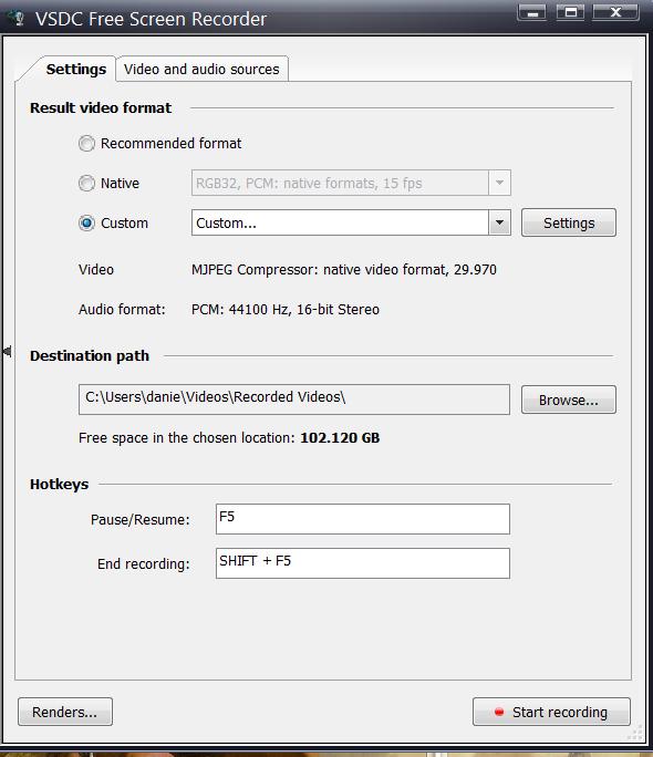

Question 1. I must be incredibly stupid, but in the screen recording menu of VSDC I can't find the button to tell the software that I want a recording in constant frame rate. Here's what the screen looks like:
[Attachment 53426 - Click to enlarge]
When I select a framerate from the menu, it just gives me options for framerate, but nowhere can I force a choice for a constant frame rate.
What I'd like to know is this: if I choose a frame rate in this menu, can I assume it is a constant frame rate? i.e. if I select 29.97 as frame rate, will it be constant or will the software still secretly record it as a variable frame rate?
(and to add a bit: I am worried it is the latter. I distinctly remember choosing 29.97 before the recording that has the bad synch, which would imply it is a variable frame rate anyway, but I could be mistaken anyhow).

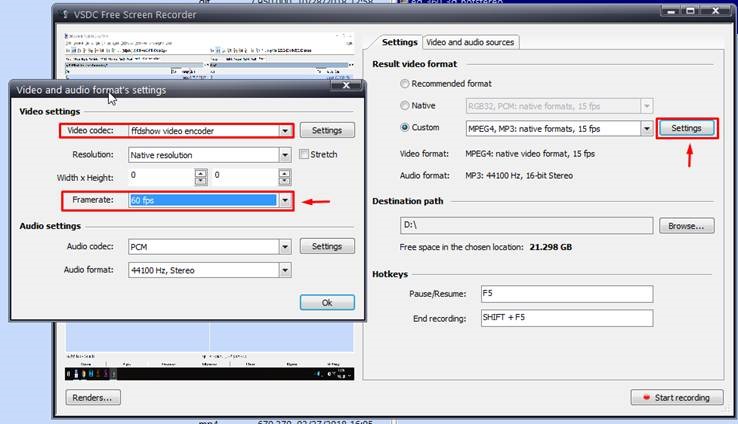

danielschut,
This was the response I got from VSDC. I tested it on my machine and it has fixed the issue.
Hello,
Sorry for inconveniences caused.
[Attachment 53722 - Click to enlarge]
Please try another codec. Go to “Settings” and try selecting the video codec "ffdshow video encoder" (you can download it here: https://codecguide.com/download_kl.htm, select pack ‘Mega’) and change the framerate to 60 fps.
Or please have a look at this tutorial: https://www.youtube.com/watch?v=kKODMU9TFfQ
Sincerely,
VSDC team -
@Cornucopia, @smrpix: thanks - there's significant drawbacks to powerpoint though. First is that if you switch to a different screen, you won't be recording that. Second is that the audio recording breaks down everytime you transition to a new slide.
@EEengineer JSE: thanks! It seems that did the trick. Awesome
