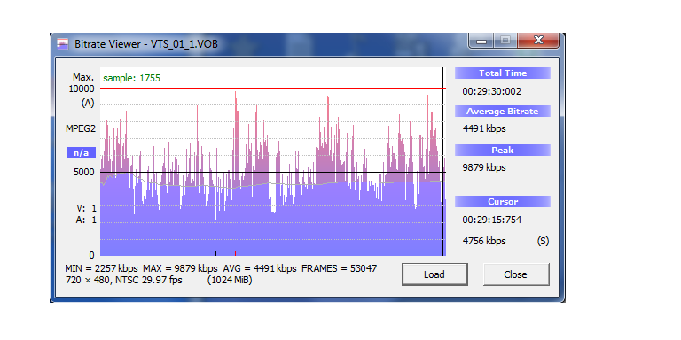

I downloaded the Bitrate viewer and loaded a few DVDs. Here is one of the statistical results that came back.
[Attachment 53621 - Click to enlarge] I've learned something new today thanks to you. I appreciate the guide from you. So It turns to be the max bitrate is 9879 kb/s and the average bitrate is 4491. But the quality is awesome!!!! I just don't know of any methods or Softwares that are capable of converting uncompressed MOV files into DVDs with the correct bitrate, resolution pre-determined. Could you please throw at me some good tips? I'd appreciate your help. -

You have to remember those numbers include not just the video but the audio stream(s) as well, plus the subs and the muxing overhead. If more than one audio stream, then it can affect the video bitrate significantly. Add up the audio bitrate(s) and subtract them from the total and average bitrates for an estimate of the video bitrates alone. The subtitles and overhead don't take much.
