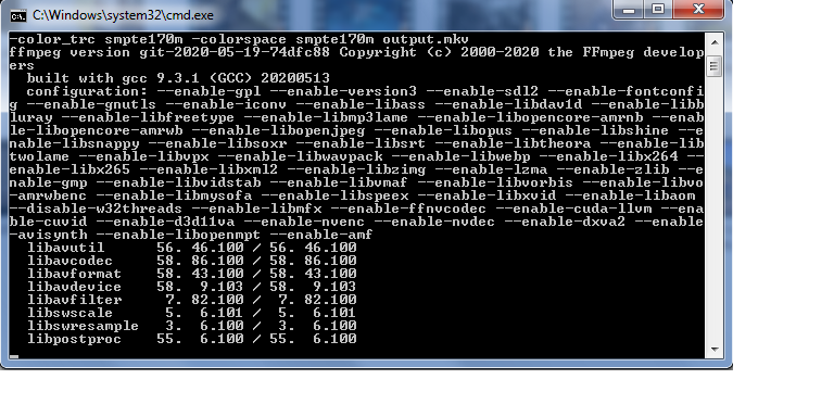

    Thank you for your time reading. Image
    [Attachment 53424 - Click to enlarge]

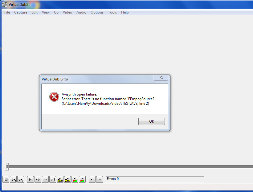

  7. Originally Posted by rgia View Post
    I try to open the script with Virtualdub 1.9.1.1 but it fails.
    "fails" in what way ?
    Post the error message
    I assume everything is x86 ? avisynth+ , vdub
    I placed everything in the program file (x86) folder. And here is the error message.

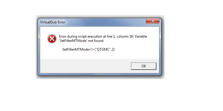

    [Attachment 53432 - Click to enlarge]
    Are you trying to learn FFmpeg/batch processing or are you trying to compress your file?
    If it's to compress the file, use Virtualdub2. Open the source, video/compression set the output codec.
    Audio/full processing/compression set output codec.
    to troubleshoot the batch file, first make sure the command works outside of the batch file
    by copy and pasting it into the command window
    I'm trying to learn FFMPEG/batch processing. The syntax does not work when I put it in the command window.
    It works as-is when I tried it. Make sure your script opens and plays in virtualdub2
    Virtualdub does not recognize the "test.avs" file I created. I clicked on "run script" in Virtualdub, then I searched for the "test.avs" file, but then I don't see the "test.avs" file anywhere through VirtualDub. I had to, in the dropdown list, click on "All Files (*.*) to be able to see the "test.avs" but then it fails to load the script file. The error message I attached in here too.
    Open Virtualdub and drag the script icon into the window, or file/open video (not "run script")
    I have verified that FFMPEG has been successfully installed in the system. I don't know why I got this error message.

  15. You need the ffms2.dll plugin for FFmpegSource2 for avisynth
    It's not the same thing as FFmpeg.exe
    Old versions required ffms2.avsi to define the FFmpegSource2 wrapper function, but I think it's bundled with the .dll now

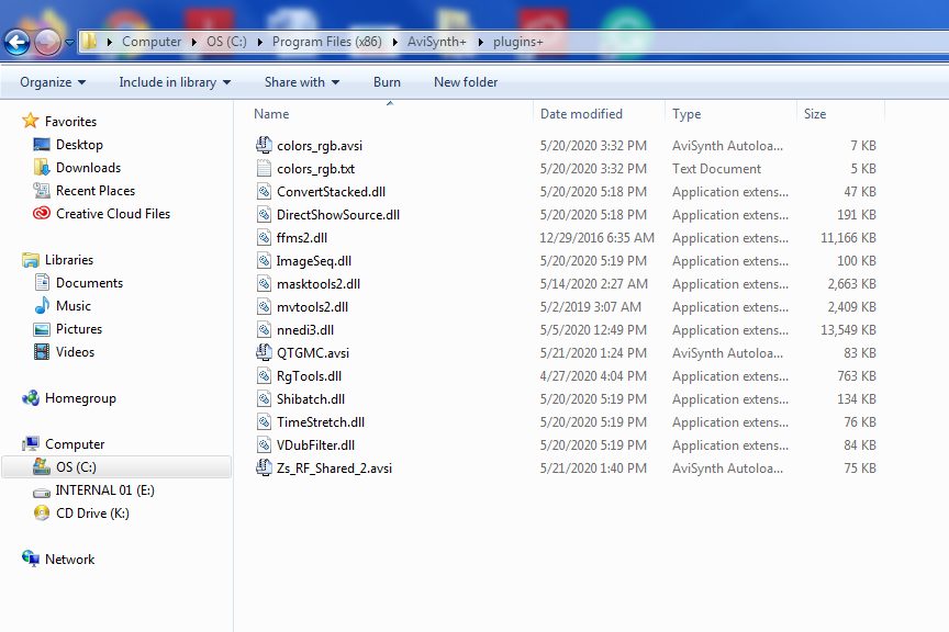

    [Attachment 53433 - Click to enlarge]
    Here is the picture showing components inside my Avisynth+ folder. I have the ffms2.dll you just mentioned.

    Silly question, do I need to move all the Vdub's components into the Avisynth+ folder??
    No just put ffms2.dll in the avisynth plugins folder
    Apr 2019
    USA
    Thank you, guys!! I literally had to uninstall everything (AVIsynth, Virtualdub) and reinstalled them to make it work. I finally got it to work.

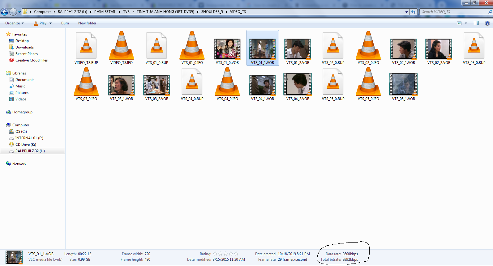

    The reason I'm asking for this is that i purchased professionally produced DVDs (retail DVDs) and I compared their picture quality with my raw uncompressed MOV files. I notice my uncompressed MOv files quality = their retail DVDs. Then I assume they muat have w way to convert these files to dvds. I also notice their video bitrates are super high: 9500/9800 kbs. Even the best DVD RECORDER LIKE JVC and TOSHIBA XS34...can't obtain this high bitrate. I can upload a portion of their retail DVD so you can see their quality vs my uncompressed Mov files. Other tha Ffmpeg, would you recommend any other programs that could create high quality DVDs? Please advise me. Thank you.

    AC-3 is the compliant audio format for DVDs If I'm correct. I meant AC-3 not the AC3 PCM, my bad. Please see the attached picture. For DVDs. VBR is recommended, I believe. Not constant bitrate.
