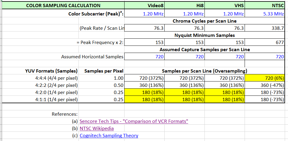

  14. Back to the original subject of this post... I did more research and this is the result. If I understand this correctly, it turns out the "color under" system of recording on tape significantly reduces the color resolution. For Video8, Hi8, and VHS, sampling at 720 resolution with 4:2:2 pixels produces a huge (372%) oversampling rate. For sampling an NTSC-conforming signal, the oversampling is only 6%.
    These are simply numbers and calculations based on Nyquist-Shannon. From what I have read the Nyquist-Shannon minimum sampling rate of 2x peak frequency is too low, and oversampling is required.
    The numbers are interesting, but I am NOT making any recommendations here!
