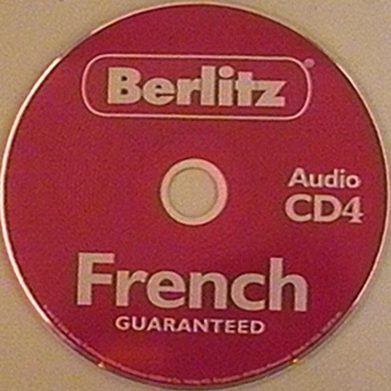

  4. Capturing Memories dellsam34's Avatar
    Jan 2016
    Originally Posted by chris319 View Post
    I think dellsam has a camcorder he can use to shoot some 4:3 footage of a round object for a test.
    To do it right you need to measure the on-screen dimensions of a round object rather than eyeball it, so his test is potentially very useful.
    Ok the results are in, See for yourselves:
    I used a CD on the table and I tried to be as perpendicular as possible, I used the original Video8 format and taped it, captured the tape @ 720x480 and then cropped the frame to 704x480 and encoded with a PAR of 10:11 (DAR 3:4). I measured in my computer screen with MPC-HC set to default so it uses the pixel aspect ratio flag and the circle measured perfectly to the mm scale on 16" screen, I set MPC-HC to ignore the PAR and set it to 3:4 DAR and the circle again measured perfectly. Did the same test with 720x480 and set the PAR to 8:9 and the CD was slightly horizontally squeezed.
    See the attached video file and measure for yourself.
    Also here is a square crop:

  5. Yes, that's a test that didn't need to be done. Anyone who's done video capture in the last 10 years knows that almost all capture devices conform to the ITU spec.
  6. Capturing Memories dellsam34's Avatar
    Jan 2016
    Unfortunately a lot of people need to see it. If everyone knows everything a forum like this wouldn't have existed.

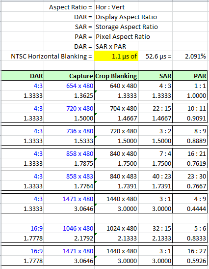

  26. I know I'm going to catch some heat for this, but I can handle it...
    I just like being able to understand the numbers. I'm sure some of the capture resolutions are way out there. I researched blanking timing of the active picture, but couldn't find it... just backed in to the 1.1 microseconds.
    The black numbers are calculated in Excel.
    [Attachment 53542 - Click to enlarge]
