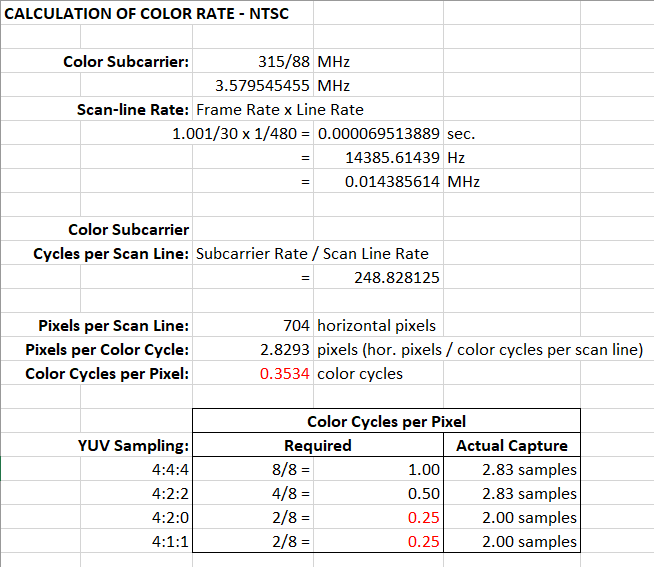

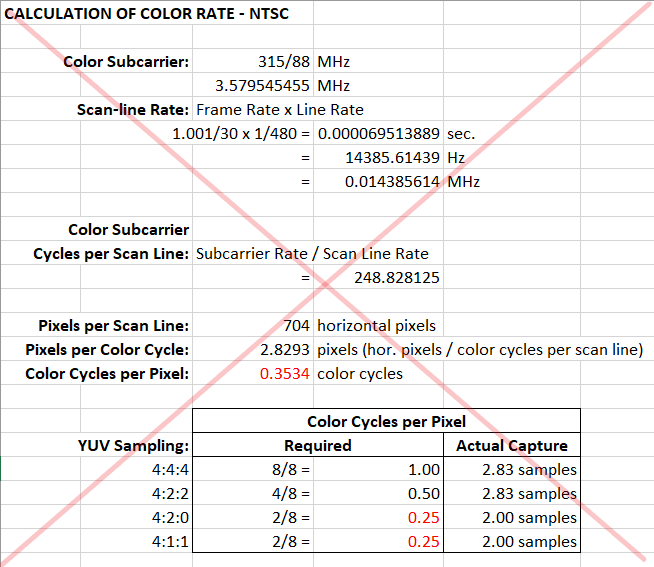

  1. There is a lot of advice on this forum about recommended capture pixel format for color. Generally 4:4:4 is considered overkill and 4:2:2 is considered the best we can do from an NTSC signal (8mm in my case).
    I tend to question everything, so I have attempted a calculation, but not sure if scan lines per frame should be 480 or 525 - used 480:
    Edit: spreadsheet had errors - see below.
    Spreadsheet updated. See Post Below.
    Last edited by GrouseHiker; 21st May 2020 at 12:39. Reason: Corrected spreadsheet.

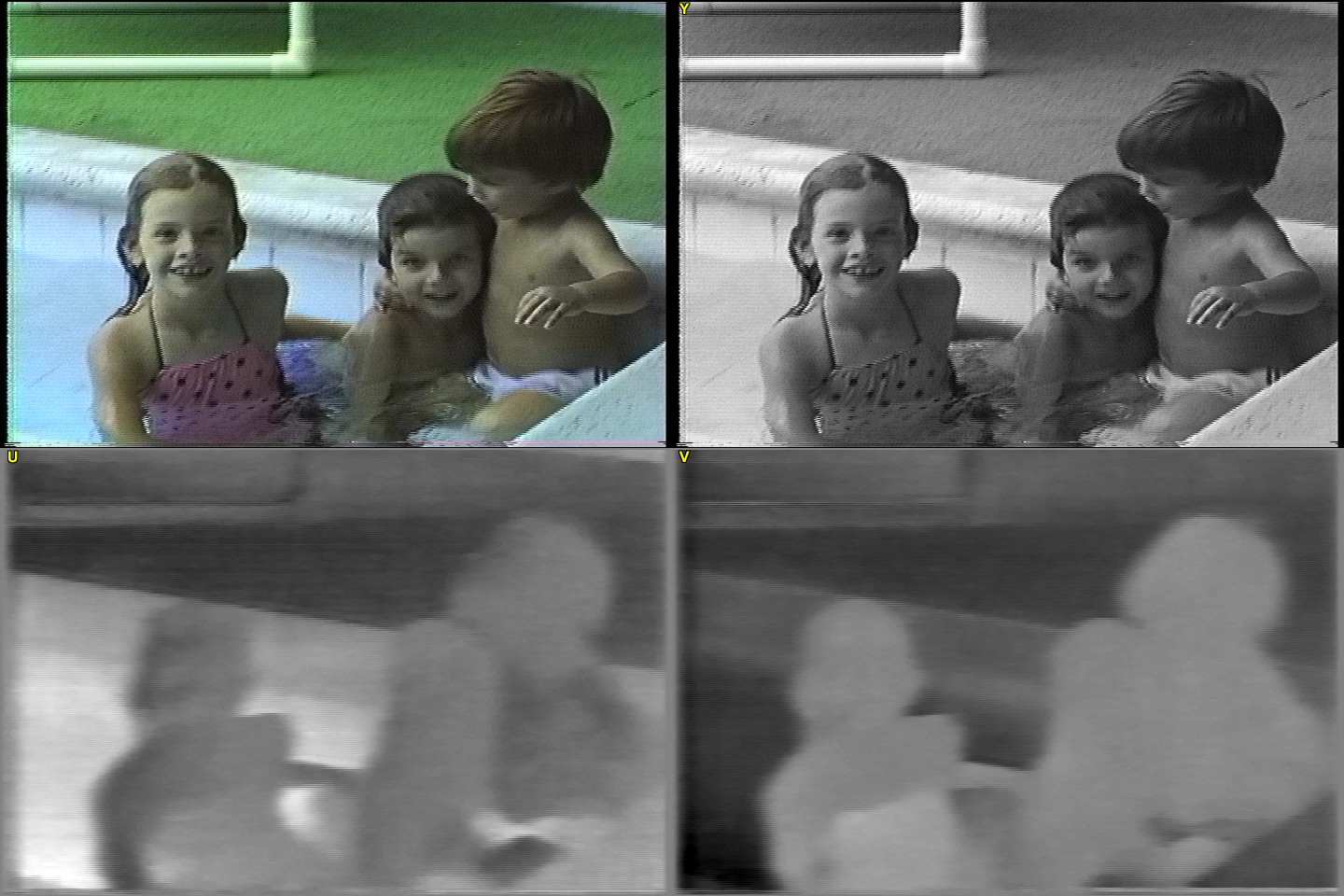

  2. Consumer video tape has far less chroma resolution than theoretically possible by the NTSC spec. Even 4:1:1's 176 samples (across the 704 pixels of the active picture) is sufficient for the chroma. Take one of your 4:2:2 caps and try this:
    Interleave(last, MergeChroma(last, BilinearResize(width/4,height).Spline36Resize(width,height)))
    That reduces the chroma resolution from 352 samples per line to 88. Can you see mouch of a difference?

    I will try that when I get back home. In the meantime, you have (as usual) clarified a few things for me; however, you have also caused me to question my assumptions. From https://en.wikipedia.org/wiki/Chroma_subsampling:
    [Attachment 53386 - Click to enlarge]
    Trying to figure out your statement:

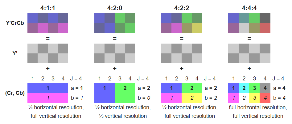

    ...I realize my math is wrong in the spreadsheet. Looking at a group of 8 (4 wide x 2 high) pixels, the denominator should be 8 and pixel width should be 704. The corrected calculation is:
    [Attachment 53590 - Click to enlarge]
    If my assumptions are correct on color content of the original signal (i.e., based on color carrier modulation frequency), color content lies a bit below 4:2:2. Reality is probably different, as I'm sure will be demonstrated by your code.
    A question: Is my use of 480 scan lines correct?
    The chart is updated below:
    post 2584924
  4. In a perfect theoretical NTSC analog signal, yes 4:2:2 is sufficient for capture. But you're dealing with a consumer analog tape. The chroma that's stored on the tape has far less resolution than the NTSC spec allows for.
    Yes, 480 scan lines is correct. The actual active picture is 485 scan lines -- the topmost scanline containing actual picture on the second half of the line, the bottom most scanline only the first half of the line, and 484 full scan lines in between. When captured those half lines become full lines, for a total of 486 lines. But even those 486 lines usually don't all contain real picture information. Some lines are used for closed captions and other flags. From consumer tape there is head switching noise at the bottom of the frame. So typically only 480 scan lines are captured. 480 has the additional benefit that it's mod 32-- so mod 32 and mod 16 codecs can deal with it.
    The remainder of the 525 scan lines that define the full NTSC signal are used for sync in analog TVs.

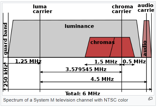

  6. I'm getting way beyond my knowledge level, but comparing to the NTSC standard, the bandwidth contained on tape appears quite a bit less:
    [Attachment 53391 - Click to enlarge]
    If bandwidth is the proper comparison, the Video8 has (based on the Sencore sheet) 743 kHz chroma while NTSC standard shows 2 MHz chroma. Is that apples-to-apples?
    I'm now wondering if my calculation is proper for NTSC... should I use bandwidth instead of subcarrier frequency? If yes, that would really bring the numbers down. Maybe bandwidth relates to color bit depth and subcarrier frequency relates to sampling interval?
    Another thing that's got me stumped is the pixel color sampling is based on two, stacked, 4-pixel groups. If a scan line is one pixel high, where does the second, 4-pixel group come from?
  7. 483 scan lines per frame + 42 lines vertical blanking = 525 scan lines.
    or 262.5 lines per field * 2 fields = 525 scan lines.
    Are you dealing with a 4:3 aspect ratio throughout?
    I used to know this stuff by heart; now I have to sit down and figure it out.
    Keep in mind that your analog 8mm NTSC tape has a phase-modulated color subcarrier (sine wave) so you have to be cautious when doing calculations for digital capture.
    That line rate doesn't look right, either. Should be more like 15,734 Hz or 3.579545 × 2/455 MHz. You also have to factor in horizontal blanking (10.9 us).
    I get 188 cycles of 3.579545 subcarrier per active H (52.65 us, excluding H blanking). Does that sound right?
  8. Originally Posted by chris319 View Post
    I guess 525 should be used in the scan-rate calculation with respect to timing. Even though we're only capturing 480 vertical, the line-to-line timing is based on 525.
    Yes, 4:3 display .. 3:2 (720x480) Capture
    I researched this a bit... Camcorderpedia states:
    A video standard (or video system) describes the properties of a particular video signal used by a device (such as a camcorder). For example, the NTSC standard used for broadcasts and baseband video in the Americas, Japan, Korea, and Taiwan, defines a frame rate of 29.97 fps (frames per second), 525 horizontal lines, and a color subcarrier at 3.58MHz. Camcorders sold in these regions must be able to generate a signal that complies with this standard.
    This is not to be confused with a format, which defines how the video is encoded or recorded to a medium (this typically has regional standards of its own); and in the case of tape formats, what kind of tape to use, and cassette dimensions. Physical properties of a format are usually universal.
    Tape formats used in camcorders usually have their own unique variants of their native standard.
    I believe this blows my whole premise of trying to calculate how much information can be produced off an 8mm tape and translate that to a minimum capture format.
    Yes. That's what the spreadsheet outputs when 525 lines are used.

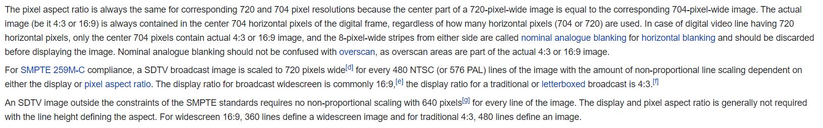

  14. This statement from wikipedia.org/wiki/Chrominance, indicates Chroma Subsampling is related to bandwidth, not the carrier frequency:
    Separating RGB color signals into luma and chrominance allows the bandwidth of each to be determined separately. Typically, the chrominance bandwidth is reduced in analog composite video by reducing the bandwidth of a modulated color subcarrier, and in digital systems by chroma subsampling.
    If this is correct, my calculation approach in the spreadsheet is WRONG, and I have no idea how to convert the calculation to use bandwidth.

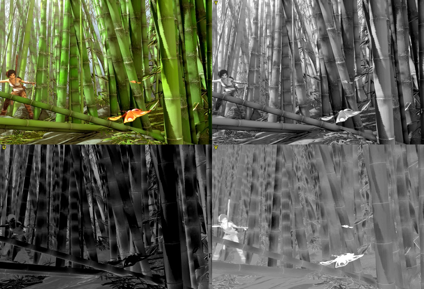

    Unfortunately, my captures haven't matched the quality of the one you posted.
    Even with his image you can see that the chroma channels have much less horizontal resolution than the luma:
    [Attachment 53450 - Click to enlarge]
    ImageSource("frame.jpg")
    ConvertToYV24()
    StackVertical(StackHorizontal(last, GreyScale().SubTitle("Y")), StackHorizontal(Tweak(sat=3.0).UtoY().Subtitle("U"), Tweak(sat=3.0).VtoY().Subtitle("V")))
    Note that saturation was increased for the U and V plots in order to have more contrast in the images.

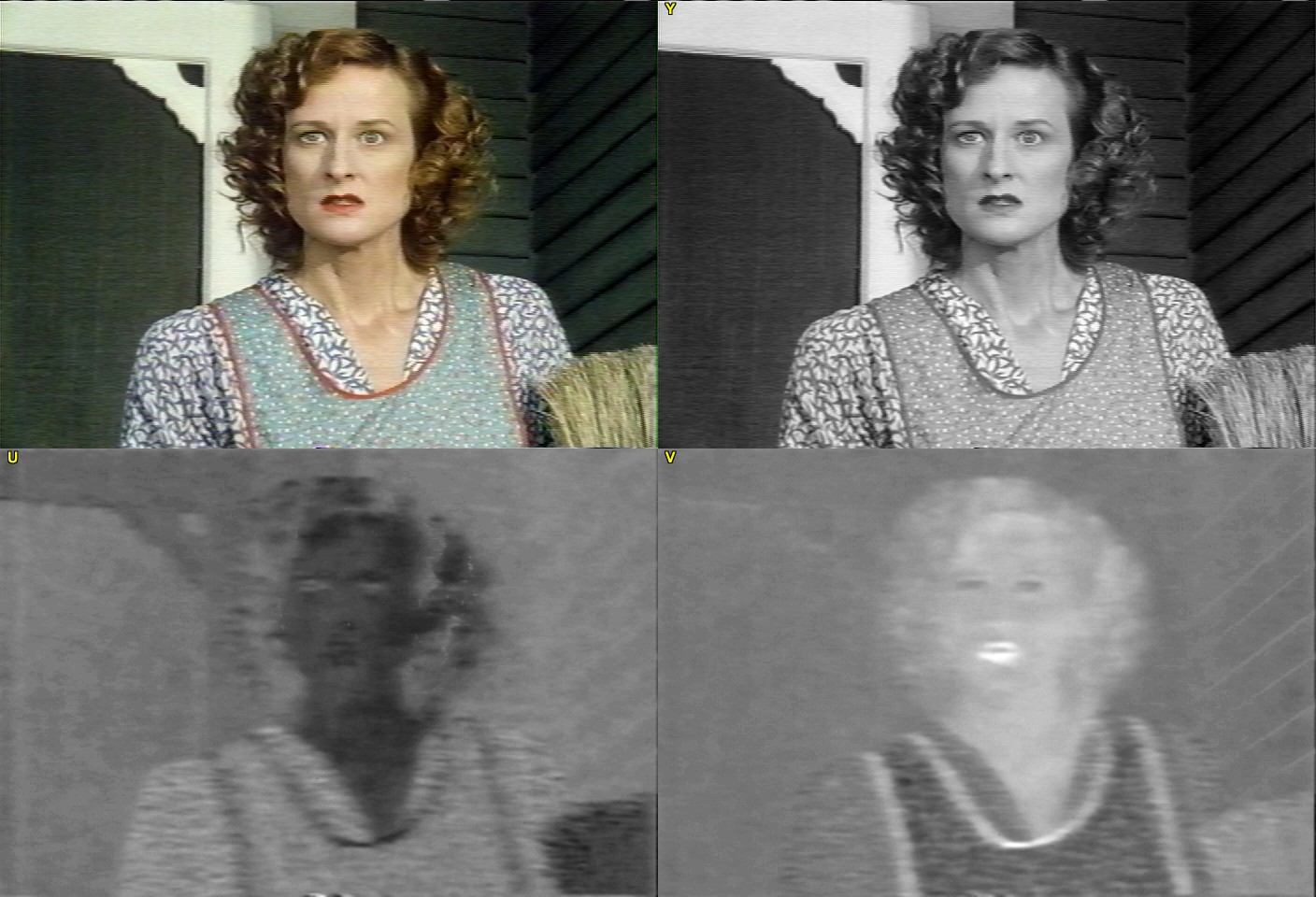

    A simlar plot from one of your YUY2 video:
    [Attachment 53453 - Click to enlarge]
    And a true YV24 video (downscaled from 4K to SD)
    [Attachment 53455 - Click to enlarge]

  26. Originally Posted by jagabo View Post
    Those are VERY dramatic examples that demonstrate the "shallow" (if that's the word) color off the 8mm tape.
    LOVE that code - keep it coming!

    For both captured 720x480 and cropped 704x480 the PAR is the same which is 10/11. With 704 the DAR is exactly 4:3 but for 720 it is slightly wider (exactly 16 pixels wider), but the active 704 of the 720 is exactly 4:3. Also 486 is not a legal resolution in the SDTV standard, it is a transitional step after capturing and it should be cropped to 480 immediately, The same thing should apply to 720 and should be cropped to 704 right after capturing but because a lot of people are confused between 720 DVD anamorphic widescreen which it contains all 720 active pixels with DAR of 16:9 and the 720 capture (704 active + 16 padded pixels) with a DAR of 4:3, they tend to keep it that way, but they are completely two different things.
    Wikipedia
    If you want to make 16:9 with 1:1 PAR (square pixel) you will have to crop to 704 and convert the 704 to 640 and add approx 213 dummy pixels horizontally, If you want 16:9 with the same 10:11 PAR you will have to add approx 235 dummy pixels to 704 or 219 to 720.
