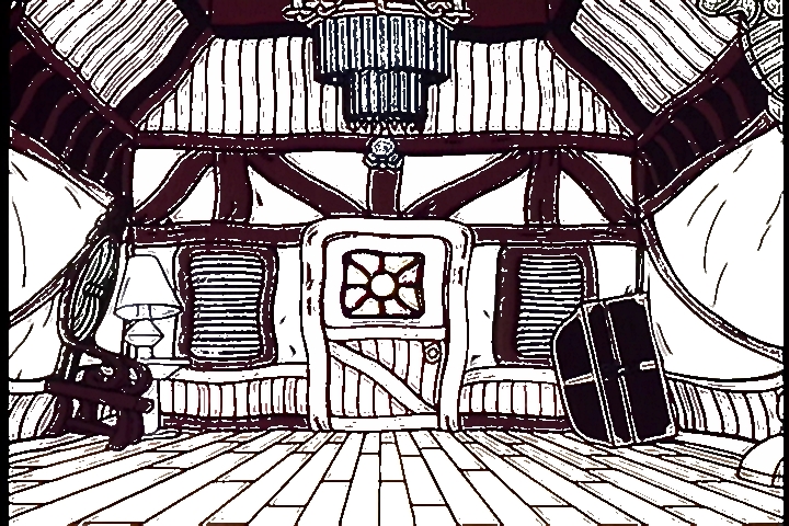

  5. Thanks for explaining the differences. Based on my experiments and your clarification on this, I'm going with Gradfun instead of Addgrain. Now, in terms of your concerns about wiping away details on animation, it's a valid one for us cartoon lovers (particularly with older cartoons). Let's face it, some DVD transfers are not that great, but not so bad that they can't be improved upon. For this reason, I created a binary mask combined with line protection (protecting even the most faint line to the best that my eye can see) to give myself more flexibility with the strength levels. So while using MCTemporaldenoise at a high setting is a total detail destroyer, it works wonderfully on non-detailed "flat" surfaces, particularly when the source contains multiple problems with junk (random vertical lines, black smudge, blocking, ringing, etc).
    So on a very grainy/junk-filled source, I run it once through SmDegrain() to target dark areas, which gives me nice results. Then for my second pass, I use this mask to run it through McTemporalDenoise and Temporaldegrain().

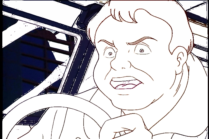

    Take a look at my sample masks (white is where the filters would target, while the dark lines are not touched).
    [Attachment 53485 - Click to enlarge]
    [Attachment 53486 - Click to enlarge]
    [Attachment 53487 - Click to enlarge]
  6. Geez, gohan, it wouldn't have dried out your turkey burger if you had given me two words in response to this. I was polite enough to respond to your comments, respond to my B.S. too, ya know?

    The mask is impressive if you want to leave black lines alone that's for sure.
    If white is where the filter is targeting, your gonna destroy detail for sure.
    If you only care about cleaning those few spaces you mentioned, and you do not mind a detail destroyer that will clean things really well, try this instead of using MCTemporalDenoise and see if you like it more or not.
    How? Yes, white is where my filter is targeting but there's no detail--just flat color. The detail is in the lines, and the lines is what I'm masking. How on earth am I destroying detail on a flat, DETAIL-LESS surface?
    Take a look at the hallway screenshot---even the slightest wood grain on the floor (which is detail) is being masked and thus, protected from the filter. How am I destroying detail with a mask that is covering details?
  9. I would need the original untouched footage to show you that or answer that accurately. If you gave me a screenshot of before you filter and after you filter, I would show the detail loss if I can. Trust me, you cannot protect every single fine detail from DNR, you can only lessen how much it affects it. It would have to be a single color space with no other detail at all to lose in order to not reduce detail levels. You can find that on cheap newer kids shows, but older animation like ghostbusters should have quite a bit of detail in it I would think.
    Take those 3 same screenshots. Make them with no filters at all, then filter them and send both versions of the screenshots for those 3. I will circle and try to show you where the detail is getting lost with an explanation of what to look for. I don't mean show the mask in black and white, I mean show the actual before and after screenshots of the full colored video as it is.
    If there is no detail loss, I will commend you, but I am very certain there will be some, unless the animation for some reason never had any to lose.

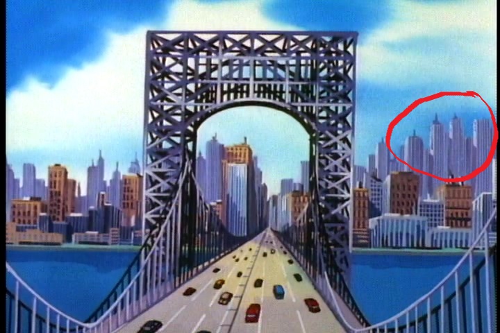

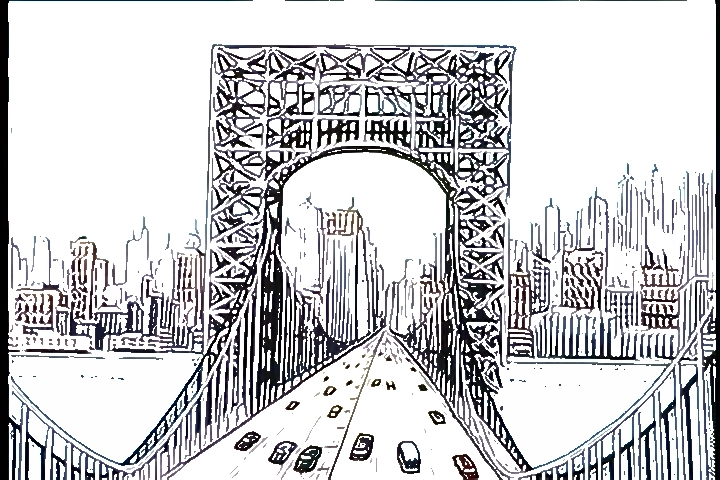

  12. Here we are. The before and after for each clip.
  13. Forget it. Don't bother making the comparisons. I already did and lost the bet hands down. Take a look at the before and after in the fine details on the buildings (circled).
    Sigh* It's back to the drawing board for me. And here I thought I had the perfect fine detail mask, and that you were just trying to break my balls.
    The thing is, this video NEEDS this type of filtering. It's junky as all hell!

  15. Yeah that is seriously obliterated, and that smeared watercolor look is awful lol. It's lost its nice colors, and looks unnatural without any texture detail left. I would certainly pass on the results.
    I tried to tell ya. 14 years experience of working with animation, I know what I am talking about most of the time. You cannot use DNR and not destroy detail on that kind of animation. Its older high detail animation made on film with lots of natural grain and shading on it. You can protect lines all you want, but the texture details are going to take a hit from using any DNR on them in that kind of animation. It's not made like today's cheap kids animation that look completely flat and usually only a single color in most areas that do not blend together.
    It doesnt NEED that type of filtering, that's just what you want for it, is a super clean look. It was not meant to be that way from that particular era in time. Even a nice HD remaster is going to have natural artifacts and grain in it because of the era that animation is from and how they were made.
    If you give an unaltered sample video clip, I could suggest a script I would use if it were for me. But again, there will have to be some detail loss from the cleaning. It wont be nearly as bad as TNLMeans destroying it, but it will lose minimal detail. TNLMeans is for heavy duty artifacts or HD cleaning usually. TNLMeans default settings will destroy lots of animation detail. I honestly have only allowed myself to use it on one thing so far because of the detail destruction it's capable of and how slow it is on HD stuff.
    I'm pretty sure most people would prefer the results of the script I will suggest, more than what I just seen. Just send me a sample video. Use a program called DGIndex, load the vob file into it. Then select a start frame and end frame with the 4 buttons at the bottom right of the program window. (Try to get about 60 seconds worth) Then choose FILE - Save Project and Demux Video. Then just send or attach the .m2v sample video file it generated. (I assume you already know how to do this part because of last attachments, but I was telling how just in case)

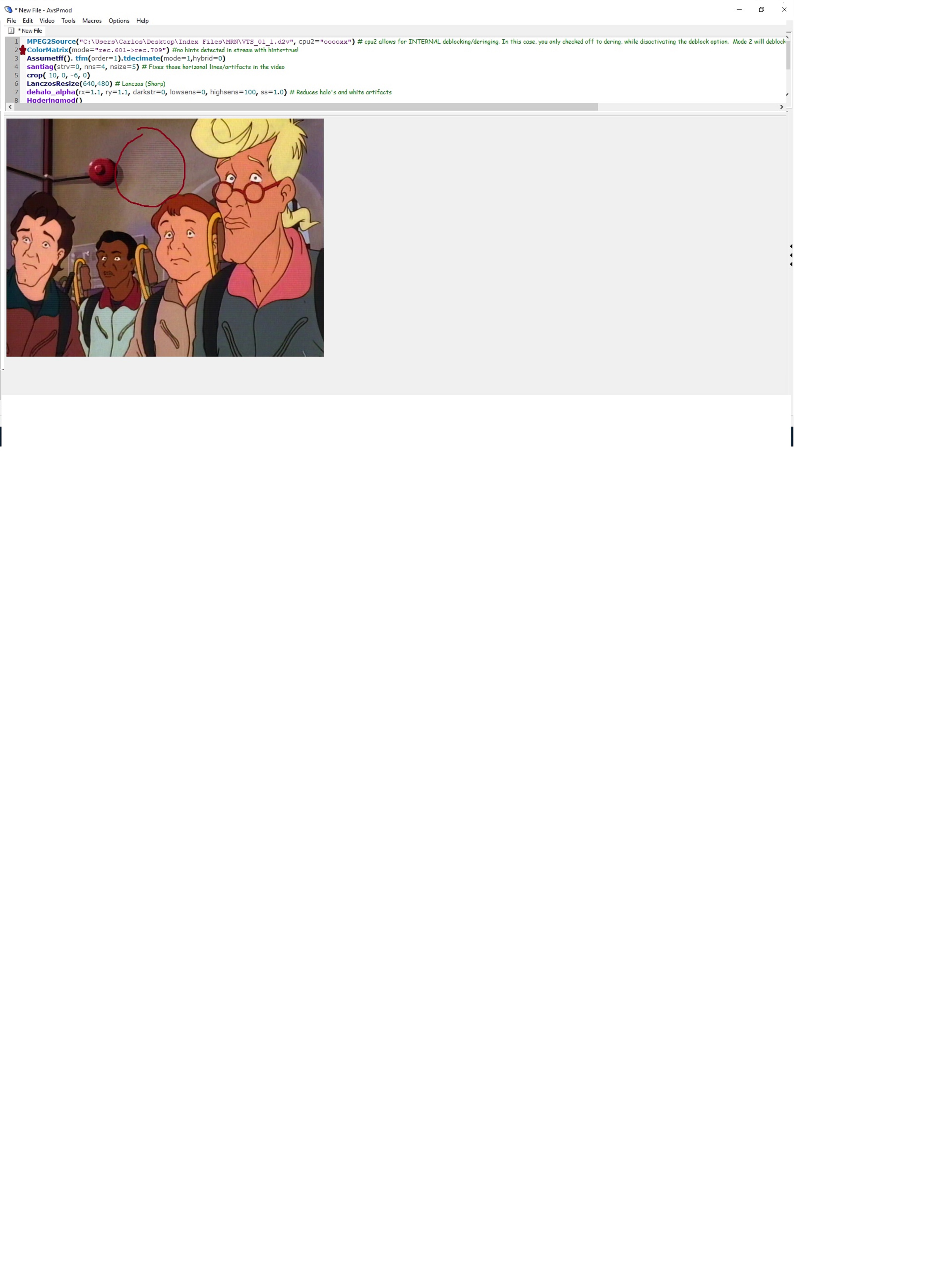

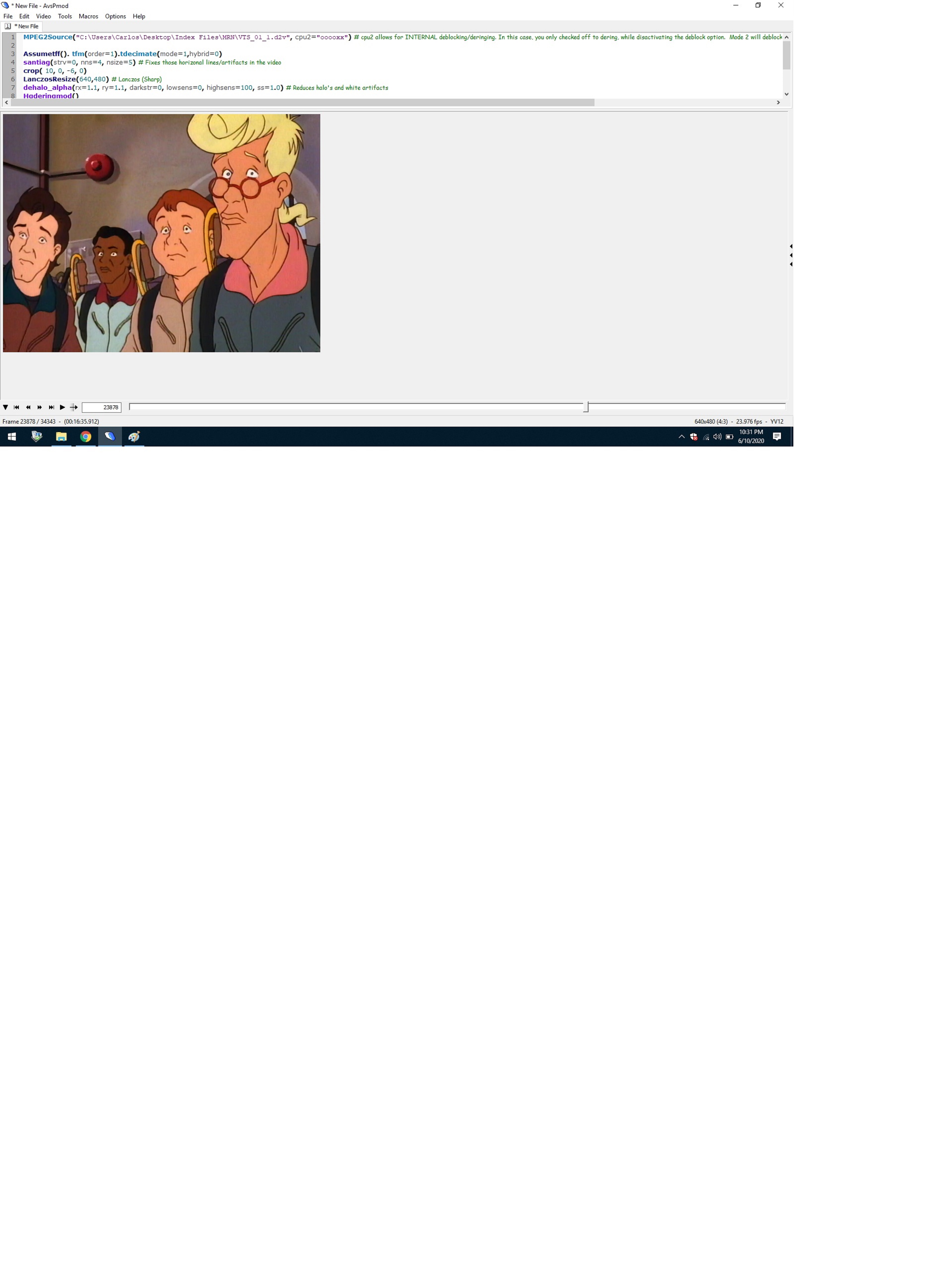

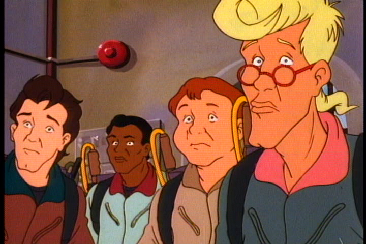

  18. Are these the random lines you were referring to? Those are usually pretty easy to get rid of.
    [Attachment 53756 - Click to enlarge]

  23. I don't know why your trying to make your video rec.709, but putting the interlaced=true back in to colormatrix like it should be, will get rid of those when converting. You would only take that out, or change to false if your source was either progressive, or you used it after TFM, which I would not do.
    They are appearing due to your script writing, not the transfer quality. Unless you are going to be scaling this to 720p+ and using flags in the codec settings to tell it to use rec.709, there is no reason to convert to rec.709. All of the colors will be displayed incorrectly on playback if you do this to a 480p video.
    Use it like this if you insist on making rec.709, and those lines will not be an issue for you.
    Colormatrix(hints=true, mode="rec.601->rec.709", interlaced=true, clamp=0, threads=0)
