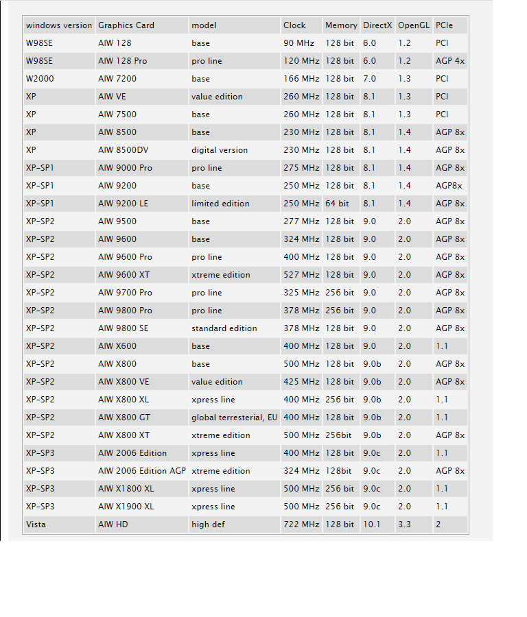

    Hi everyone,
    After a long research on the ATI AIW capture cards that have a fair amount of positive feedback, I decided to START a "new" capture system to use with the ATI AIW 9600XT specifically. ATI AIW capture cards are known to work best on WinXP system. My current version is service pack 3 winXP. However, I'm unable to get the system detect my ATI card as a new device or properly install the required softwares and drivers.

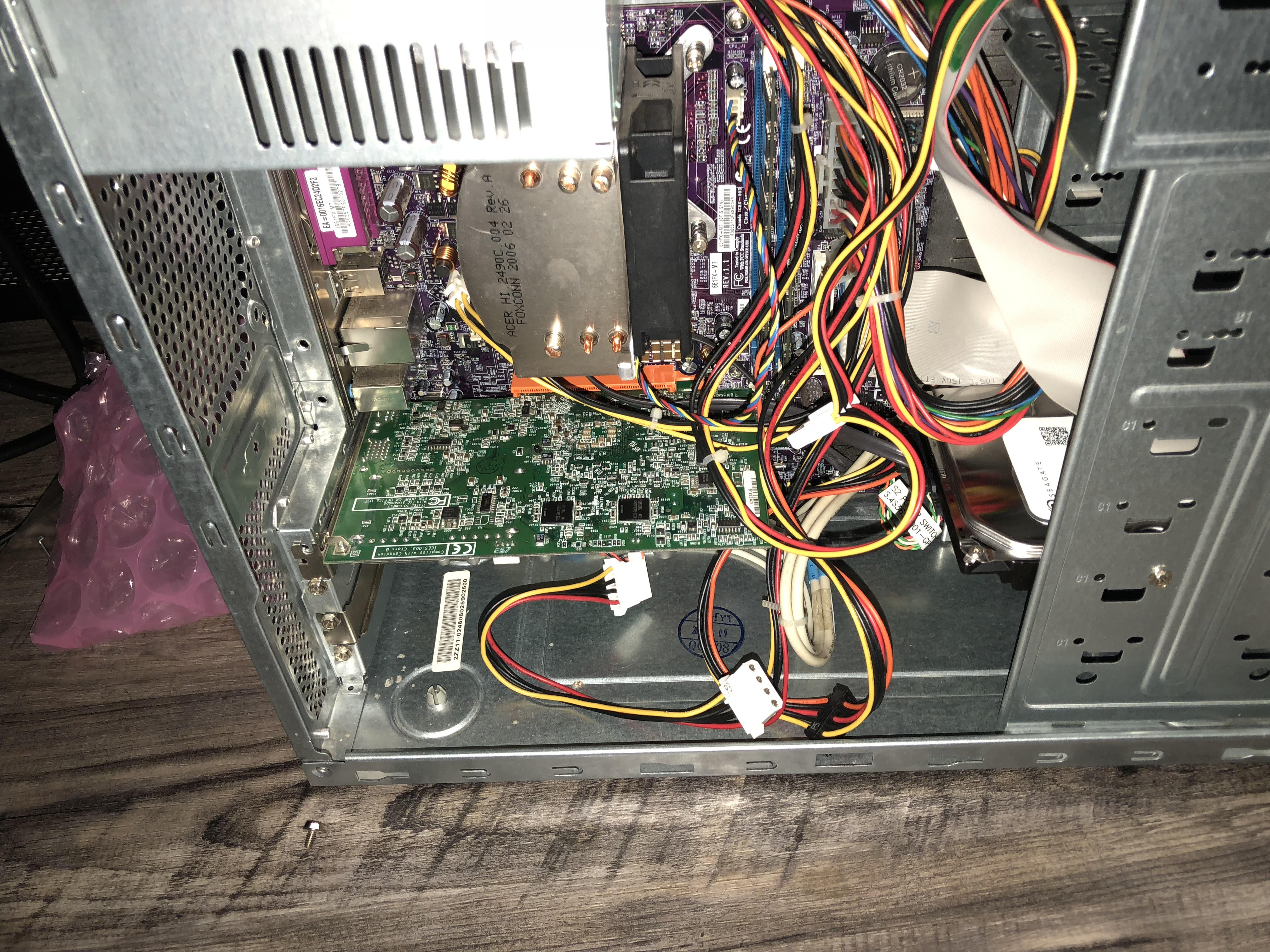

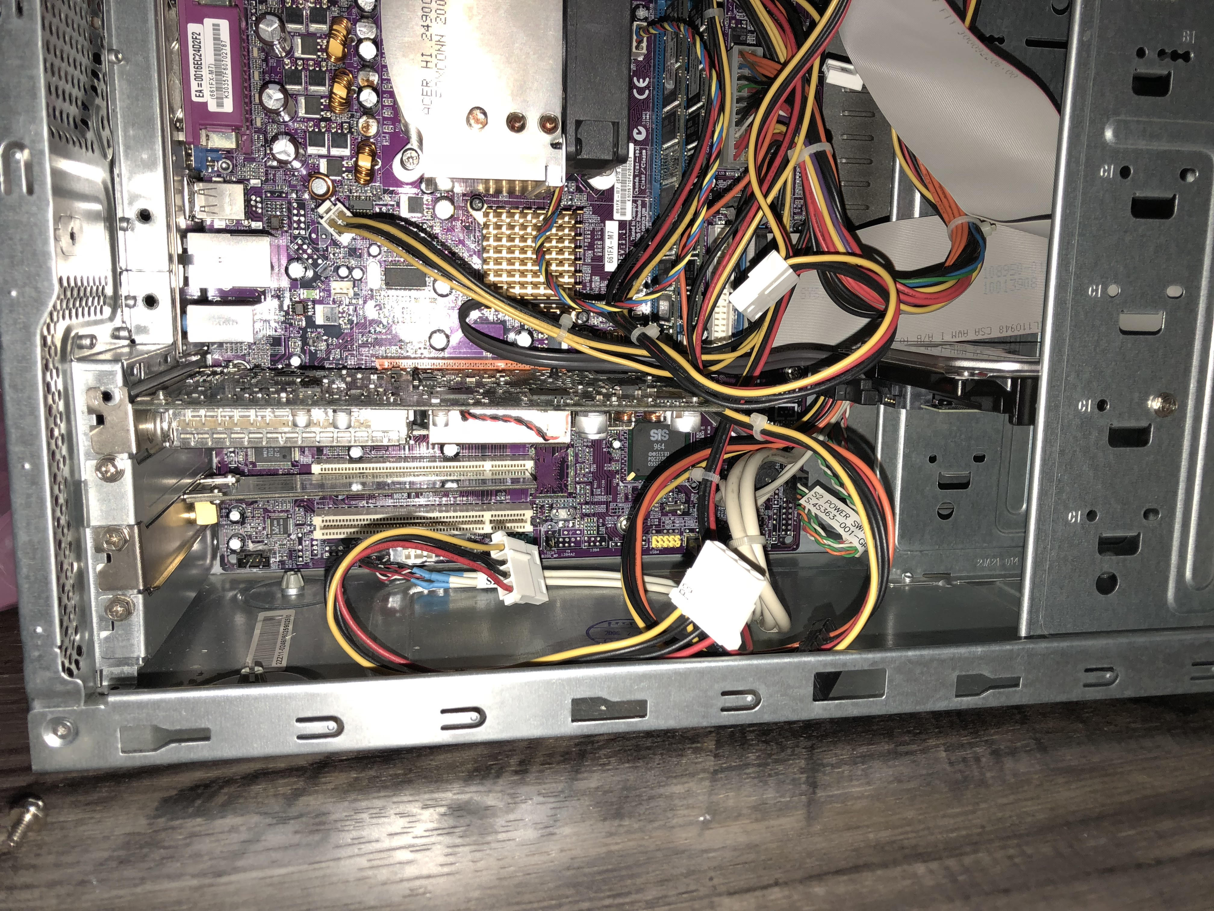

    I'm a bit confused with what you said. I see there is no other video cards inside this CPU.Image
    [Attachment 53369 - Click to enlarge]
    [Attachment 53370 - Click to enlarge]

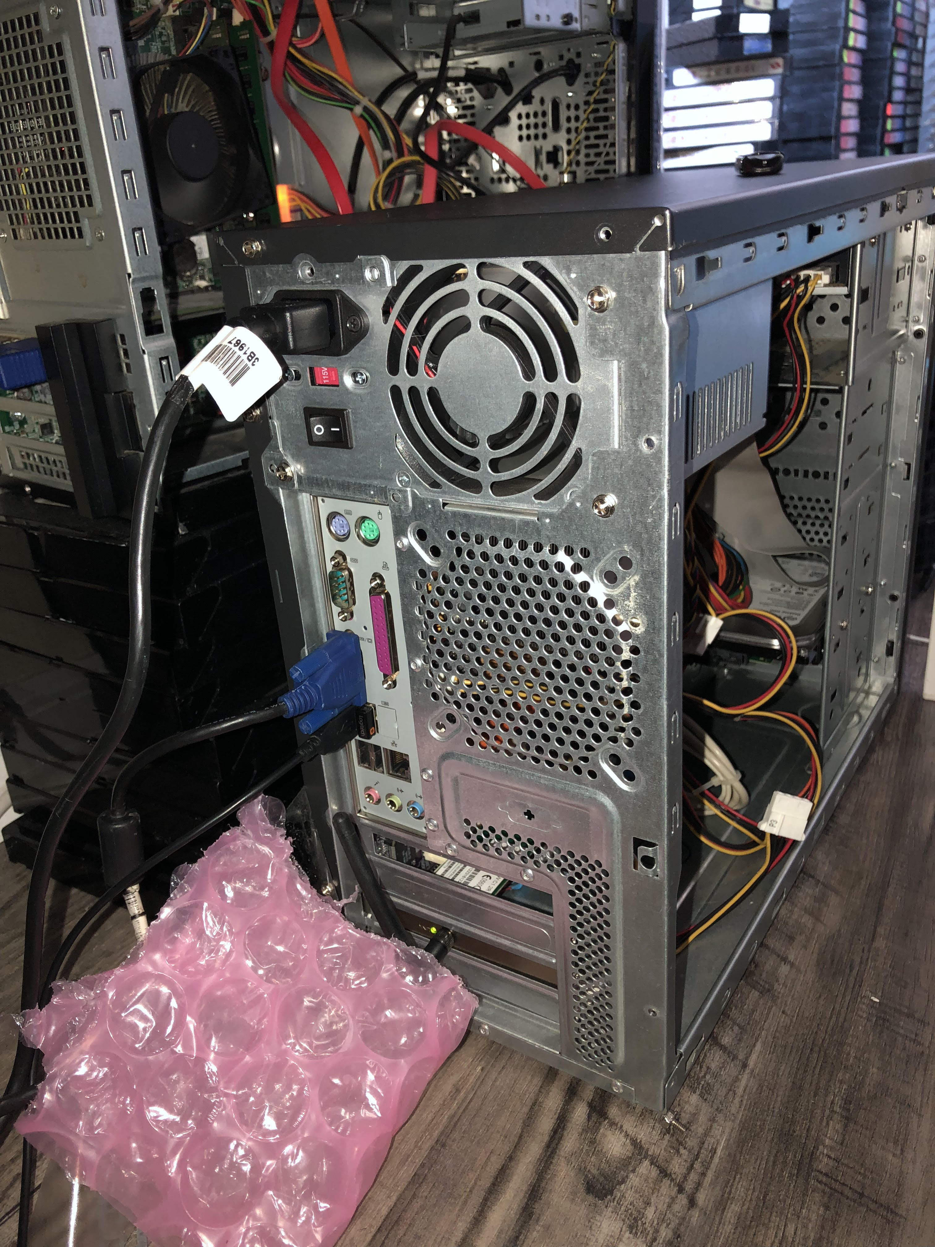

    If you're not sure what is what why don't you provide pictures showing the connections at the back of the PC?

    [Attachment 53372 - Click to enlarge]

    The monitor works perfectly fine without the 9600XT card plugged in.

    You have to install the card then plug the monitor into the new card. Have you tried this?

    I was blind not to see the breakout cables came with the card for that reason. The good news is I have gotten everything straightened and worked nicely. There are only a few issues left that I have not figured out how to fix them.
