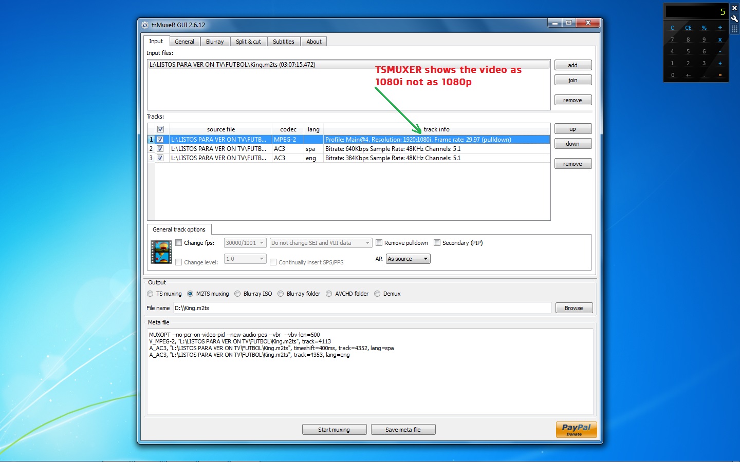

    Here is an screenshot:
    [Attachment 53343 - Click to enlarge]
    But its on the pending upload a 10 secs fragment of the original video.
    Thanks for all the help! I really appreciate it!

  14. Is it a "movie"? Where is it from originally ? It says "(pulldown") , which could indicate 23.976p with telecine (progressive content encoded as interlaced fields)
    Nov 2019
    Massachusettts
    Yes! It is, Its a movie. I asked one of my friends to recording one of my fav movies from TV. Dont know exatcly whats the method he used to recording the full movie and saved it as a MPEG2 (.TS) video file, then I had to remux it from .TS to M2TS since my TV doesnt accept .TS containers.
  16. Most "movies" are not interlaced in terms of content. They are progressive and only telecined for TV (pulldown added). The proper treatment would be to inverse telecine, or reverse the process to get back the original frames at 23.976p
    Post the sample video . You can split a section with tsmuxer

    @poisondeathray @jagabo Hey guys! I finally uploaded a fragment of the original MPEG2 video file! Maybe you guys are not gonna believe me, but split a certain fragment of the original video was not easy at all. it took me all long day. I wanted to upload a part of the video where Scanlines are visible, thats why I didn't want to upload the part or section of the beginning of the movie since there was not Scanlines in the first 40 secs, and there was no software able to split a specific section of the video. Not even TSmuxer was able to do that. When I selected a specific section to be splitted in TSmuxer I just got audio wrapped in a M2TS container, I tried like 10 different softwares, and I didn't get a solution. All the other softwares gave me the same results. Believe or not the original MPEG2 video file is such a mysterious video file. It's not a manoeuvrable video file. The only way I got to be able to split a spicific time or part of the video, was changing the M2TS container to a MKV container, and then load it to Avidemux. Avidemux did the Splitting job with/to the MKV container.
    You guys can check/test the original video fragment yourselves, and try to pass/change the video fragment that I uploaded, to M2TS using TSmuxer or any video software tool of your choice, and you will see that it cannot be done.
    But please guys, give me your opinion after you play the fragment of the original video on your media players.
    Please test it or check it in VLC, MPHC, and even transfer the fragment of the video to your USB device storage and plug-n-play on your TV.
    Here is the link to download the fragment of the original MPEG2 video file:
    https://mega.nz/file/GA0yQKJR#B43grq-NMbxJf1zbug8R4u5T2dR0NDjq1ZAv2CoGj8Y
    Hopefully after you guys play the video clip on your media players. You will be able to tell me if there is a better conversion method in FFMPEG when converting to x264.
