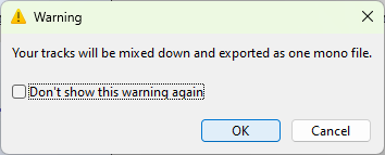

also how I export all channels to mantain 5.1 chanels and not one mono file?
[Attachment 64192 - Click to enlarge] -
