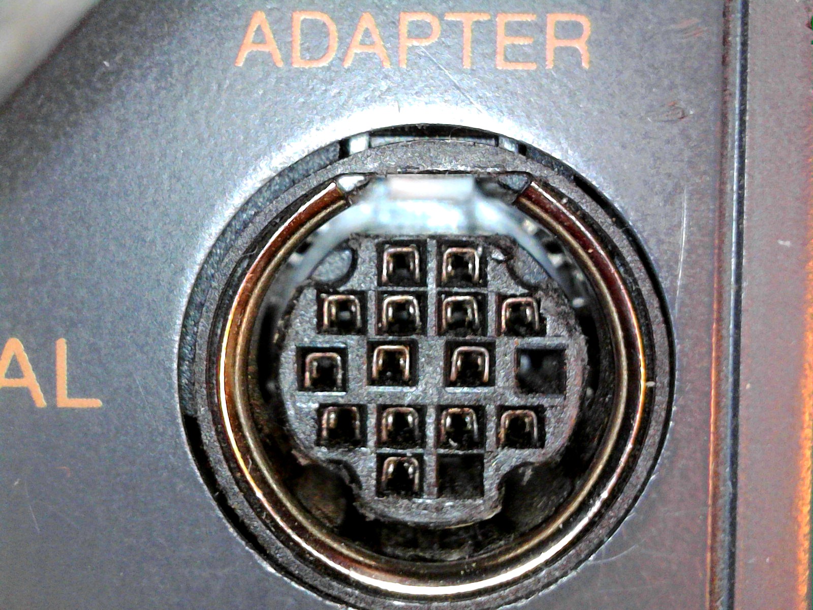

The Olympus adapter (VF-BA81) has composite out and a coax port out (which has been destroyed). The camera connects through this port (photo).

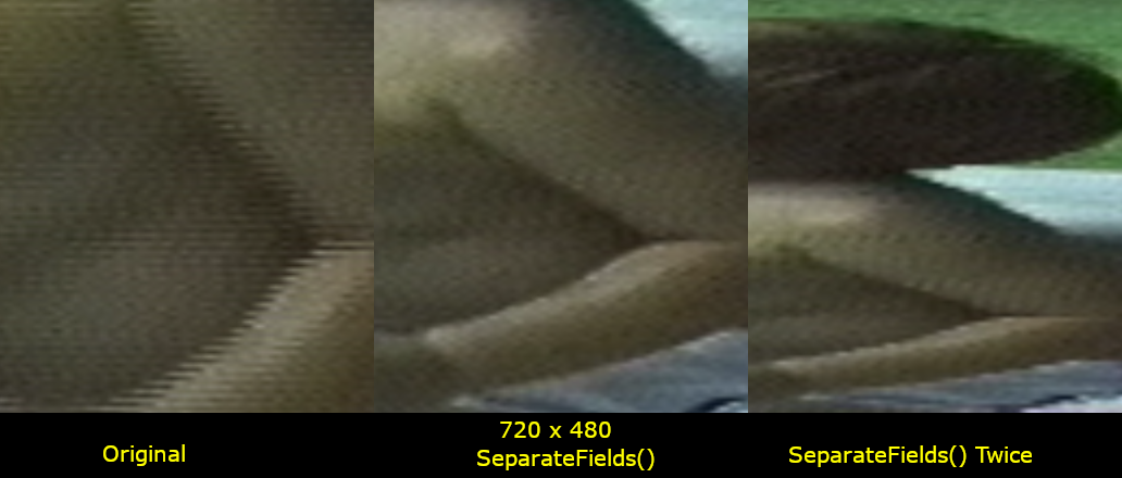

I was thinking maybe the digial camera used for playback is creating this, since the composite capture off the original camera doesn't have it (attached).

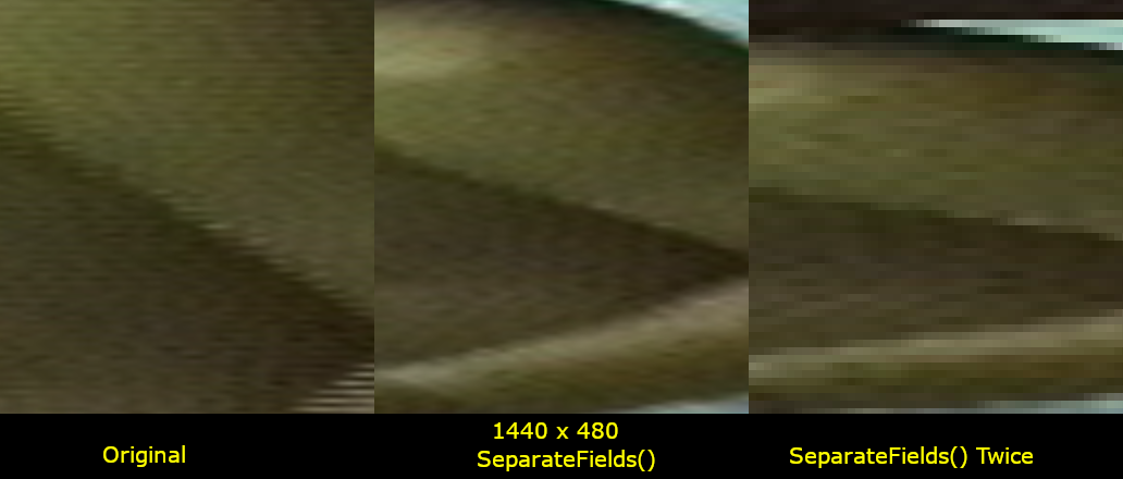

To simulate, I tried shrinking the component-video capture horizontally and then re-expanding it:
Code:AssumeTFF() SeparateFields() widthstart=width BilinearResize(width/5,height) BilinearResize(widthstart,height) Weave()

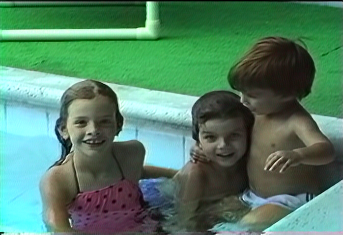

This might be going a little too far but... partly in AviSynth, partly in VirtualDub:
[Attachment 53284 - Click to enlarge]
Note, I didn't remove the horizontal lines or make any attempts at noise reduction. Just white balance and levels adjustments. In a shot like this I assume it's more important to see the kids' faces, not the background. Also, I guessed that the concrete around the pool was white.Last edited by jagabo; 13th May 2020 at 08:47.

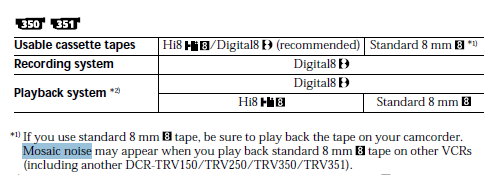

Just found this in the Operating Manual of the player I'm using (DCR-TRV350):
[Attachment 53346 - Click to enlarge]
If I'm reading this correctly, I think the "alligator skin" / "herringbone" / "vertical worms" noise is "Mosaic Noise." It looks like mosaic noise is a digital camcorder (playing Video8) issue, but I'm not positive. I didn't see any mention of mosaic noise in a pre-digital, Hi8 Operating Manual. -

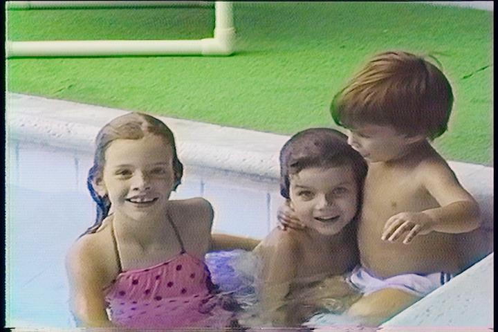

The experimental eBay camera came in (CCD-TRV318), which happens to be the same-year little brother (older brother?) to the DCR-TRV350 I have. Unfortunately the Hi8 player version produces the same noise patterns as the digital camera as seen in the 720x480 capture:
[Attachment 53585 - Click to enlarge]
I tried capturing at 1440 x 480 to see if higher resolution would change anything... but no obvious change other than the noise being twice as wide and possibly better resolution of the noise. (I have no idea why the color is different...):
[Attachment 53587 - Click to enlarge]
The vertical-ish artifacts tend to be linked "worms" in the original, interlaced frame, but sometimes they look like hieroglyphics... there is no repeating pattern than can be calculated.

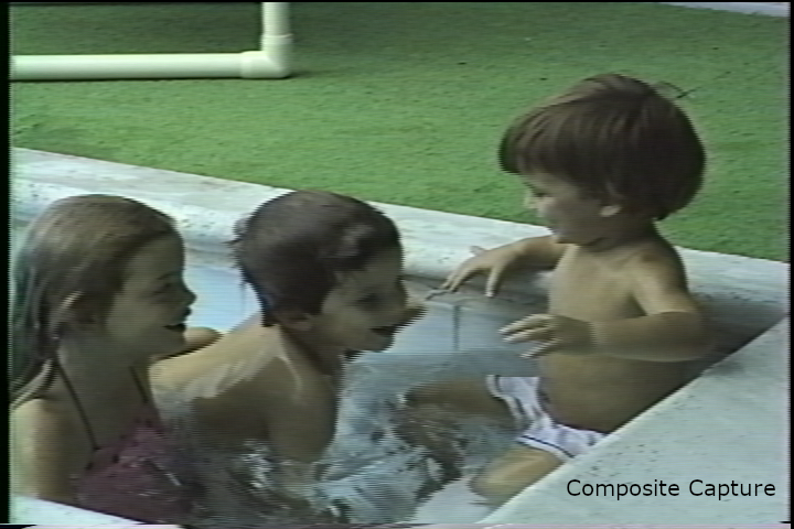

The composite capture off the original Olympus camera (original post) looks much better with regard to this noise, but the images are pretty fuzzy. I'm thinking the best option is to try to work with the s-video capture.
In the images, you can see the noise tends to be horizontal groups of pixels, one pixel high. Is there a denoiser that only compares vertically and eliminates aberrant pixels that don't match the pixels above and below (if the above and below pixels match one another within reason)?

I was looking at a closeup of the water, and it looks like there is dark and light noise that seems to have the same shape. I was searching for a denoiser that is spatial - vertical only option - but I couldn't find anything that seems obvious. If course my knowledge of this subject is VERY limited. -
I think it's imaging sensor related, Some first generation camcorders used a very limited pixel count and they interpolated the resolution coming out of the censor processor.
Would the limited pixel-count imaging sensor still produce a good composite capture with no noise? Back in the original post, you can see the composite capture looks pretty good (attached png of the same composite image).

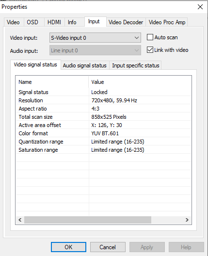

Speaking of TBC, I noticed the Composite capture off the old Olympus (no scan-line TBC) has what appears to be scan-line drops (white streaks). Is this the result of no scan-line TBC?
Also, does "pedestal matching your source" mean line count = 480?
This is the "Input" tab under "Capture Filter" in VirtualDub64. I understand the 525 vertical, but not the 858 horizontal:
