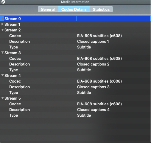

  5. I'm seeing 4 streams of subtitles in VLC codec info. Check out the screenshot attached.
Name:	Screen Shot 2020-05-10 at 4.24.15 PM.png
  6. You can use restream to remove user data from mpeg2 elementary streams
    You would have to demux mpeg video elementary stream from mkv (you might have to rename extension for the video to .m2v in order for restream to "see" it )
  7. Originally Posted by poisondeathray View Post
    This did it! Thank you Guess the weird subtitles were embedded in the mpeg2 stream after all. The resulting file was only a couple hundred kilobytes smaller (3.44 gigs total) and no rerender done. Awesome
